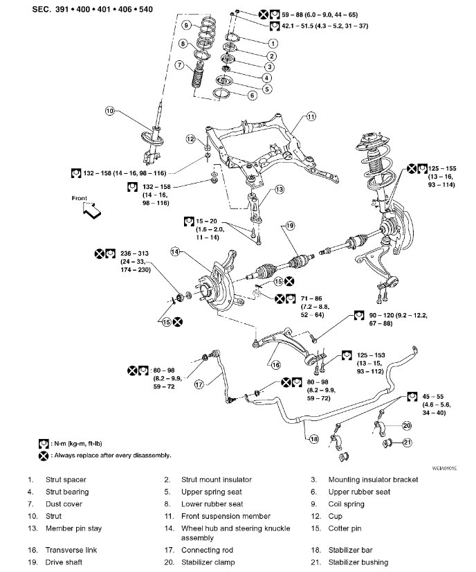

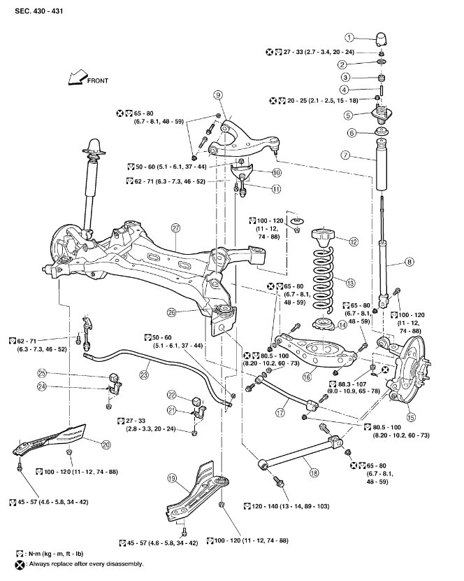

Torque spec for the whole suspension system needed?
2005 NISSAN ALTIMA
135,000 MILES • 3.5L • V6 • 2WD • AUTOMATIC
ARIELDUBON
Replacing the knuckle of the car.
Oct 16, 2024 at 11:24 AM
  • 55,447 POSTS
Sure, here are the torque specs for the rear suspension. Check out the images (below). Let us know if you need anything else.

Thank you. I appreciate it. Do you happen to have the front as well?
Oct 17, 2024 at 3:44 AM
  • 55,447 POSTS
Sure, sorry about that, I should have included in the first post, here you go. Check out the images (below). Let us know if you need anything else.
