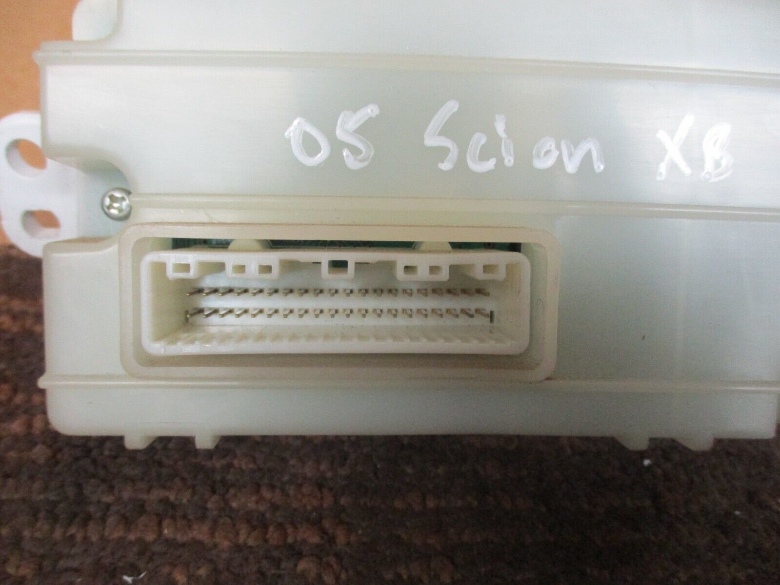

Thank you for your response, but there must be a misunderstanding here, so you see I included all my details (Vehicle, Question) on the title, and I see the title is not showing. So, I'm going to include all my details in this reply, because my question did not include in the title.
Vehicle: 2005 Scion xB
Question: How to test a cluster (odometer, speedometer) for a 05 Scion xB.
What I need: Pinout diagram, wire color diagram.
Thank you :)

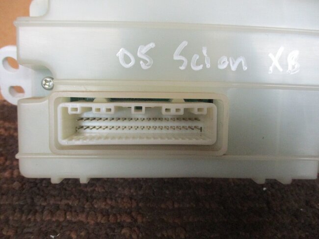

*P.S - I added a images to show you what a 05 Scion xB cluster looks like

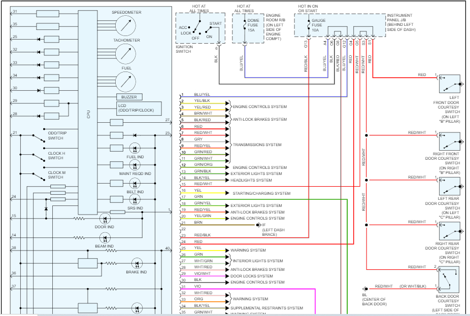

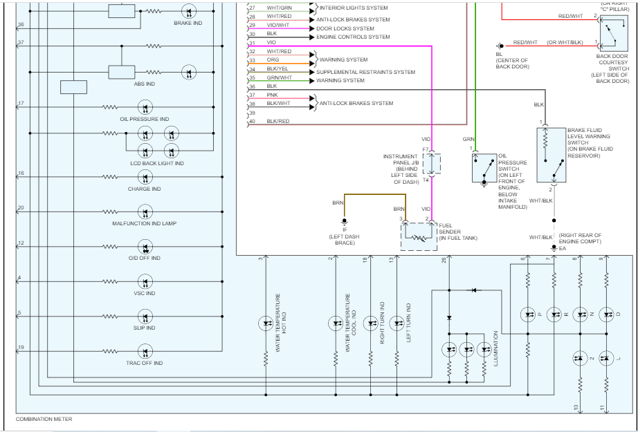

  • 110,244 POSTS

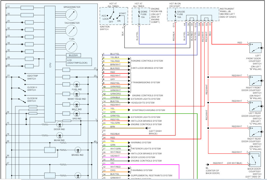

That makes it easier. LOL I'm not sure why it didn't attach.
Regardless, I attached the wiring schematic for the cluster below. The connector pin identification is included in the schematic.
Note: I had to cut the pic in half to make it readable for you. However, I did overlap the two so you can follow from one to the next.
Let me know if this is what you needed.
joe
Jun 30, 2023 at 2:26 PM
SCION
  • 41 POSTS
Thank you so much for the diagram, Joe, but are you able to tell me which one is the power? Thank you so much.
Jul 1, 2023 at 3:34 AM
  • 110,244 POSTS

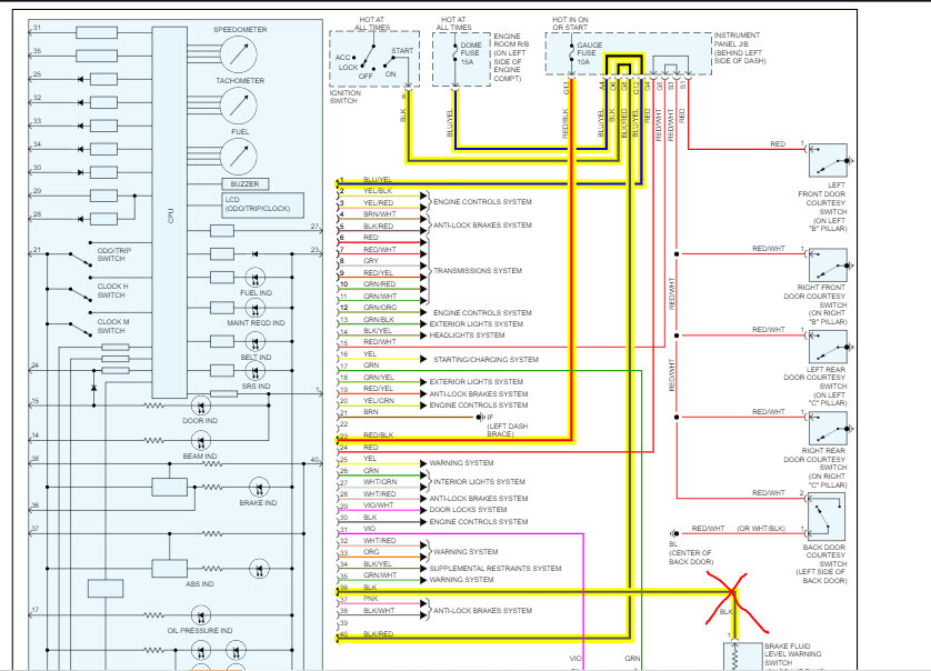

You are very welcome. As far as the power supply is concerned, it appears to be the black wire with a red tracer (pin 40). It provides power with the key in the start and run positions. Also, there are a couple of others as well. (Pins 1, 23, and 40)
I attached a pic below and highlighted what I am seeing as the power supplies. Let me know if that helps.
See pic below.
Jul 1, 2023 at 12:23 PM
SCION
  • 41 POSTS
OMG. Thank you so much, you are so helpful, Joe, you have saved me lots of frustration. I feel dumb, lol. Can you please tell me which one is the negative terminals? Thank you!
Jul 1, 2023 at 1:21 PM
  • 110,244 POSTS
Don't feel dumb. We are all the same. We require being told how. You are no different than anyone else.

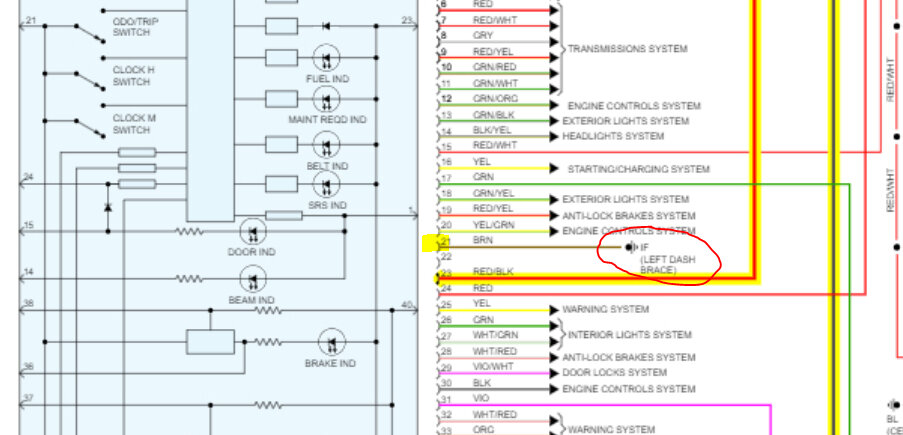

Looking at the schematic, it appears pin 21 (brown wire) is ground. See pic below.
Let me know if this helps or if you have questions.
See pic below.
Jul 1, 2023 at 3:20 PM

Thank you, Joe. What does the red X mean on pin 36? (Color black)
Happy 4th of July and take care.
Jul 2, 2023 at 6:50 AM
  • 110,244 POSTS
I put the X there because I didn't want you to think that it was a power or ground supply.
Jul 2, 2023 at 7:30 AM

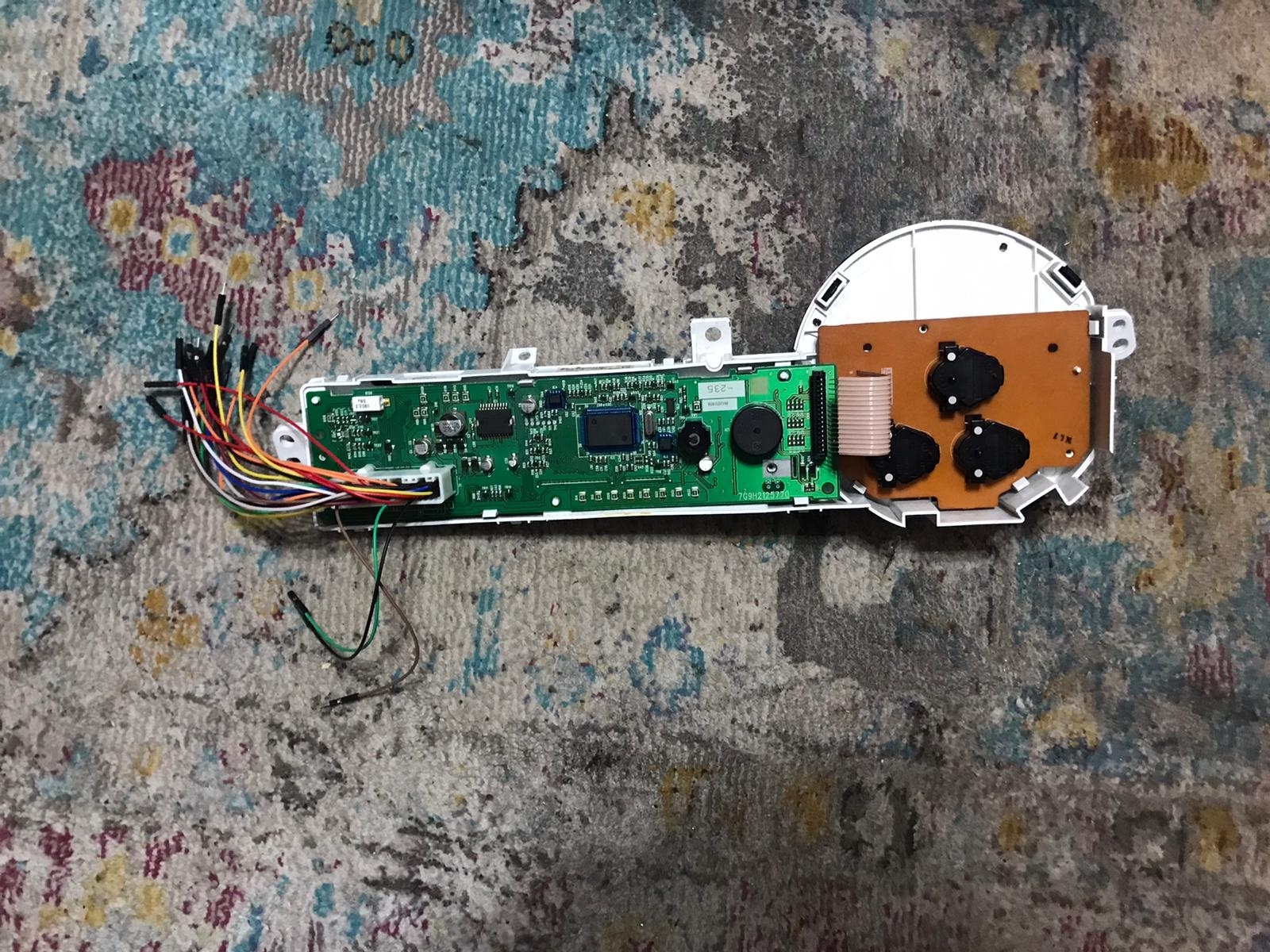

Thank you for that, Joe. But I think I am doing something wrong, I am trying to test this cluster, but not the usual way. Here is what I'm using:
Cluster
Cluster wire harness (OEM)
Phone power bank (5V, 8.4, 12V, 16, 20V [you can switch the voltage], 50,000mAH)
USB cable
Jumper cables (small)
Though, on amazon I ordered pinout cables (male to female, I will cut off the female end), they should be here tomorrow to my location, though, I am unsure if I did something wrong. I will be waiting until the cables I ordered are here. In the meantime, can you please tell me what could be wrong? (Wrong voltage, wrong mAH, etc) Thank you, Happy 4th of July.
Jul 2, 2023 at 9:42 AM
SCION
  • 41 POSTS
Hey Joe! Great news! I got it working! Thank you so much! The cluster has 213K Miles, it's amazing! Thank you, thank you, thank you!

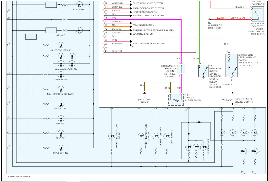

Hi, I'm sorry that happened. But, yes, I have made progress, I have found that all the indicators are powered but will turn on if you put it on a negative output. Also, what are these things on the outside of the diagram? It shows the "Speedometer" and other things. Could you help me out with that? Thank you
Jul 7, 2023 at 8:14 AM
  • 110,244 POSTS
Those are the circuits within the cluster. Note that the speedo is hooked into a CPU. That is why I'm struggling to find the pin number for you. What you are seeing is what two manuals provide.

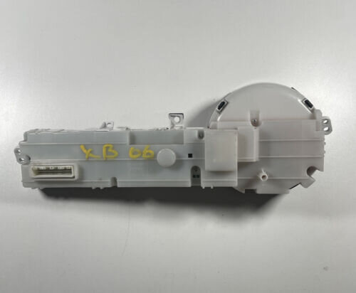

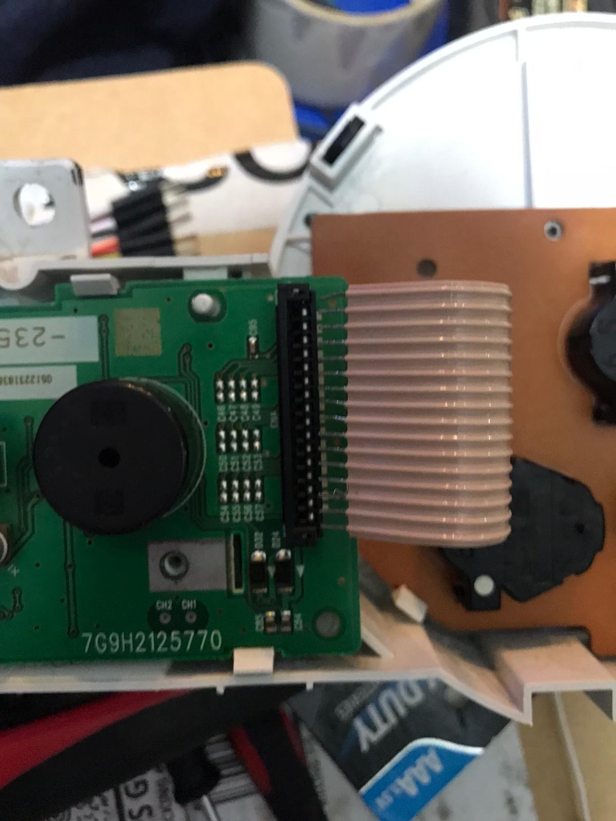

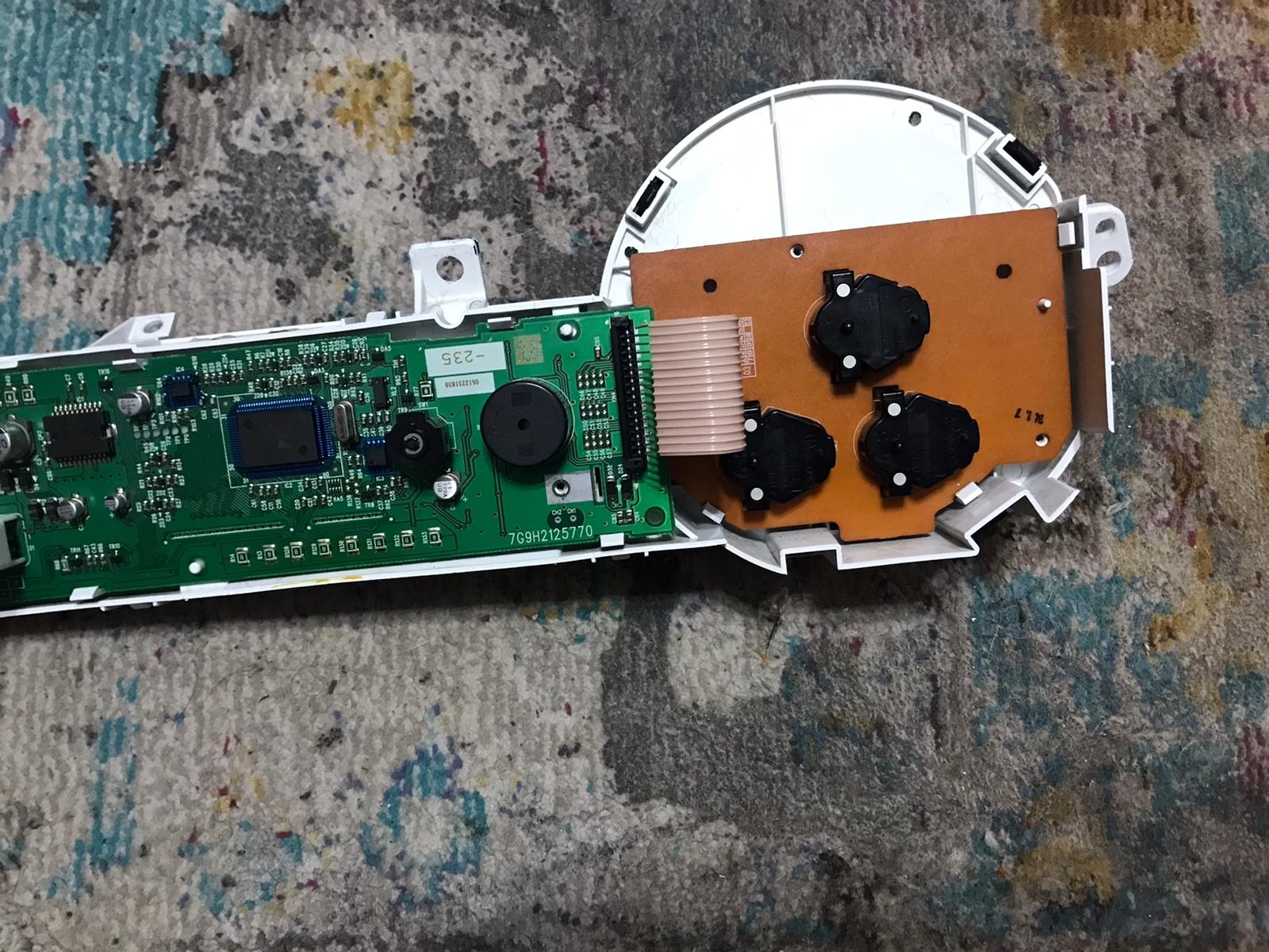

Hi Joe, I found out that the Speedometer is not integrated into the motherboard, its actually wired from the mother board (not the primary one) to the gauges. I will send a picture here to show you what I mean. It goes from 1 - 16, is there any information on that? Thank you
Jul 9, 2023 at 3:11 AM
  • 110,244 POSTS
They don't show that. I suspect because it is wired via a CPU. Is that what you are referring to?
Jul 9, 2023 at 11:53 AM
SCION
  • 41 POSTS
No, I am saying that the gauges are separated from the motherboard and have 16 pins connecting from the motherboard to the gauges.
Jul 10, 2023 at 1:24 AM
  • 110,244 POSTS
Okay, now I understand. However, that info isn't identified on any of the schematics I have. I'm not sure why. I actually checked two different manuals, and nothing was one either of them. Sorry about that.
