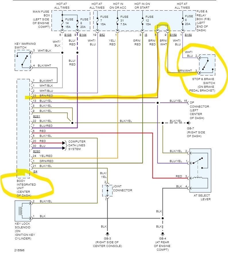

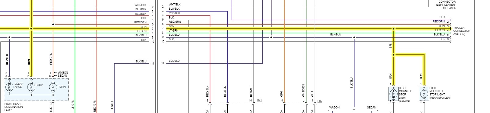

I have a problem with my break light fuse blowing, and the shifter also sticks in park when this happens. I have to bypass the shift solenoid to drive it. I have checked the brake light switch, the bulbs themselves, and chased wires as far as my knowledge would allow....so I have come to the conclusion that it is the shift interlock solenoid, and I was wondering if there is a way to bypass this while still having the brake lights work? I was also wondering if you could provide me with a wiring diagram?
Mar 12, 2023 at 2:13 PM
STEVE W.
  • 15,351 POSTS

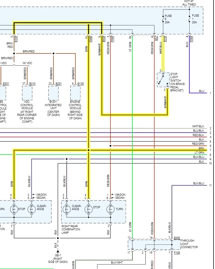

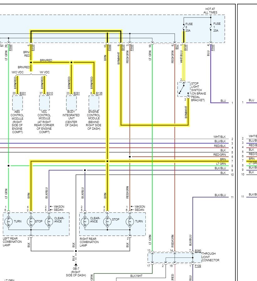

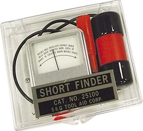

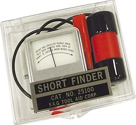

The way your lights are set up doesn't share those circuits. The brake fuse goes to the brake switch and from there to other modules. The interlock is controlled by the body module as in the second image. All the items are shown in the third image. The items that are directly controlled by the brake feed are the rear brake lights, the high mount brake light and the rear trailer connector. All of those are fed from the same brown wire. A common failure point is in the trailer connector wiring. The next is in the high mount light. If it blows the fuse only when you step on the brakes, you might be able to use a short finder to track it down. They are easy to use, you connect them in circuit replacing the fuse, the circuit breaker inside then starts turning on and off when the power is on (in your case you would step on the brakes) now you run the detector along the wire in question and watch the needle, It will bounce around until you get to the short or past it. The other option would be to start disconnecting the lights in question, like the high mount lights and the rear brake lights one at a time and see if the breaker stops tripping when you unplug one.
Mar 12, 2023 at 5:12 PM
SMALEXBELLSKI
Thank you so much. it actually ended up being the wiring on both sides of the trunk underneath the boots that go from the body to the door 11 wires were splitting.
