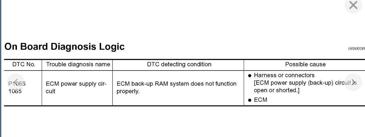

RICKKK
Code p1065.
Mar 19, 2019 at 9:33 AM

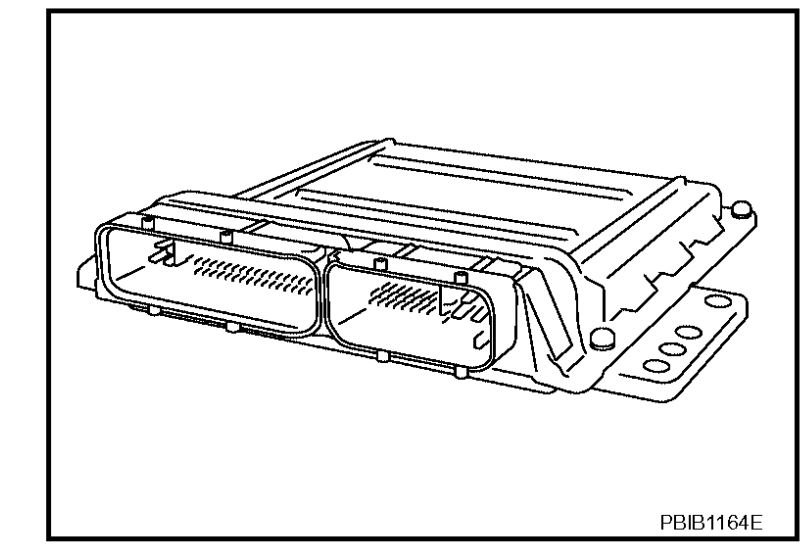

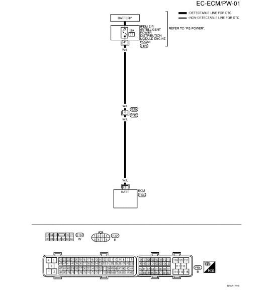

Got it.
I attached a possible issue below. You need to verify the fuse listed for power on both sides.
If there is power, then looks like you have a failed PCM.
Mar 19, 2019 at 9:41 AM
RICKKK
I am going to replace the ECM.
