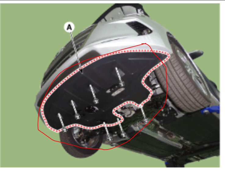

My car is making a helicopter noise coming from the front driver side. I had the wheel bearings, rotors, calipers, brake pads, and brake hoses all replaced 4 months ago. The noise does not stay consistent all the time just off and on. Any ideas? Thank you in advance.
Feb 21, 2023 at 4:43 PM
  • 110,194 POSTS
The first thing that comes to mind is the engine plastic undercover. See pic below.
Check to make sure that it is secure. Oftentimes, a shop will loosen or remove it when servicing the vehicle. Then, it will flap in the wind. Also, check the inner fender as well to make sure it isn't loose.
If it is loud enough for you to record, do so and upload it for me to hear.

Lol I was thinking the same thing, but everyone looked at me like I was crazy. And the shop zip tied it back up. So, I will definitely be fixing that properly.

I took the plastic off just to see and it’s still making the sound. So now I’m going to check the inner finder well. And hope it’s that. And I am getting ready to put the cover back under the car now lol. I will let you know if it’s the inner finder well.

None of that fixed it. I went to have all new tires put on and found out they couldn’t put the front driver side one on. Because the wheel would wobble, I took it back to the shop to find out they put a bad wheel bearing in it and now the CV axle is broken. Hopefully I will have it back tomorrow. I just can’t believe the bearing was bad when it hasn’t even been 4 months since I had them put new ones on with tons of other stuff as well. Thank you for all your help though because the plastic under my car was loose as well.
