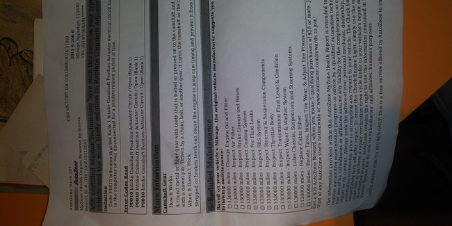

I've been getting my oil change for 6 years using regular or at Firestone I was really took it to Precision Tune they informed me that my car take synthetic oil. I did the oil change there and immediately afterwards on the way home the oil light came on my car telling me to stop engine soon as low oil pressure. I take the car back they put it on their machine and tell me I need to oil cam sensor. I get a second opinion go to AutoZone they put it on their machine they tell me I need to cam gear. I know enough that it if I needed to cam gear that the engine was completely stopped. the car was not doing this beforehand and the car is running fine now no ticking no knocking other than the light coming on. please help

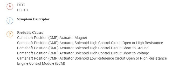

And other code is P0010.
May 12, 2020 at 10:26 PM
LYNN WELLS-MARTIN
  • 9 POSTS
Top one is from AutoZone the next is from precision.

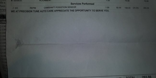

There is no code listed on the work order. It just says camshaft position senor. I need the code.If there is another code, please list it.

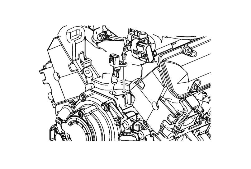

The code is for the cam sensor but is most likely electrical. Since they changed the oil and it just happened, I would have the connector checked to see if it is a clean solid connection. It may just be the connection.
I posted possibilities below for you to review.

Can you upload the receipt for the oil change?
May 12, 2020 at 11:09 PM
LYNN WELLS-MARTIN
  • 9 POSTS
I would have to find it, but yes give me a second. They are the ones when i took it back that told me it was the camshaft sensor.
