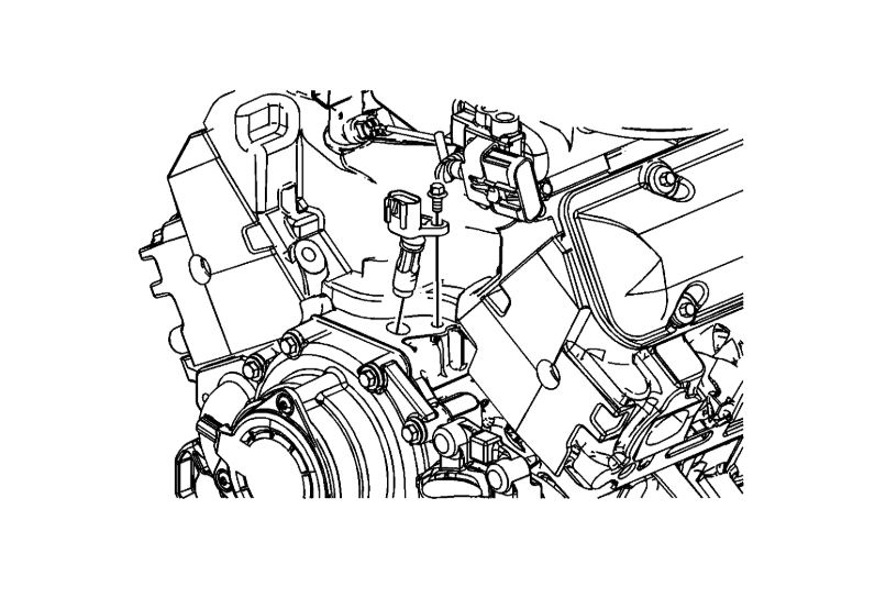

https://www.2carpros.com/articles/camshaft-angle-sensor-replacement

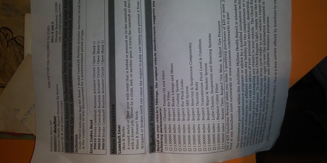

I don't know why the light came on. for 6 years the oil change has been done using regular oil Thursday synthetic oil was used. i am asking you why it would come on? And if it's the cam gear i know that would lick the motor up... I'm getting you the codes... Precision tune told me one thing which is oil cam sensor buy using their machine. AutoZone told me cam gear... I pretty much know those readings are false.. I know my car and a little about vehicles... But being a woman i'm not trying to let these mechanics out here rip me off.

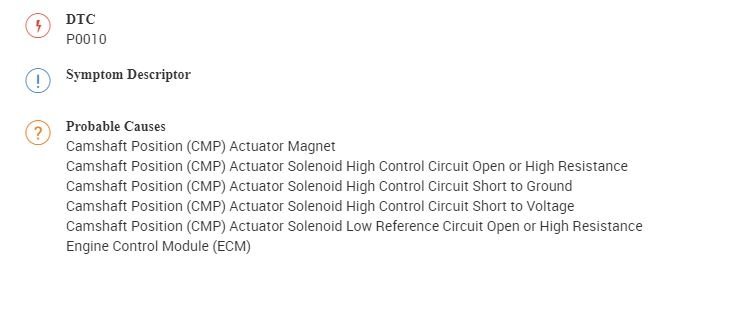

And other code is P0010.
May 12, 2020 at 10:26 PM
LYNN WELLS-MARTIN
  • 9 POSTS
Top one is from AutoZone the next is from precision.

There is no code listed on the work order. It just says camshaft position senor. I need the code.If there is another code, please list it.
The code is for the cam sensor but is most likely electrical. Since they changed the oil and it just happened, I would have the connector checked to see if it is a clean solid connection. It may just be the connection.
I posted possibilities below for you to review.
