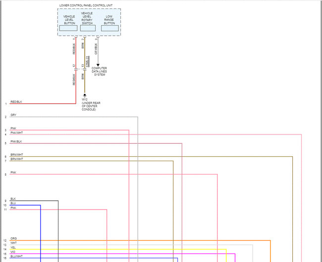

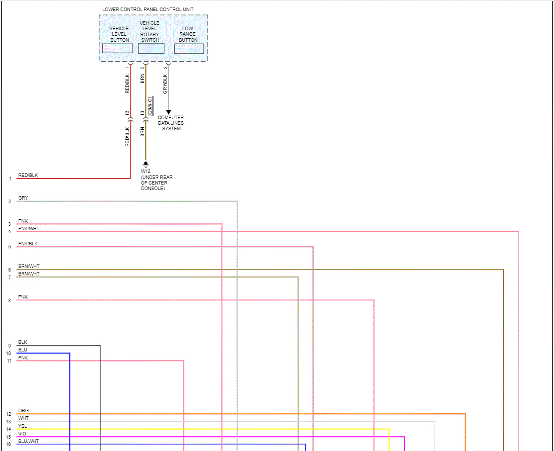

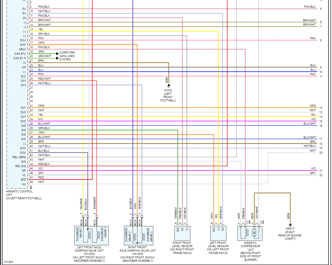

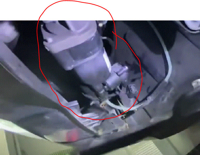

Where is the compressor on this car and if there is a relay.
Nov 22, 2021 at 2:49 PM
  • 110,194 POSTS

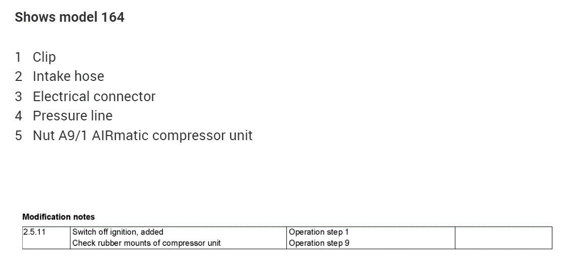

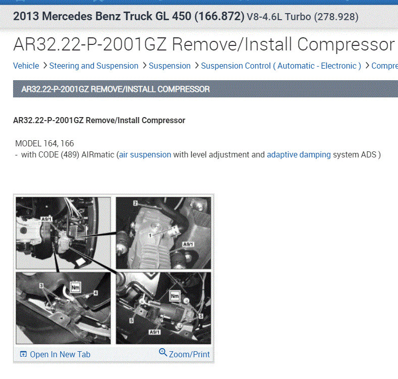

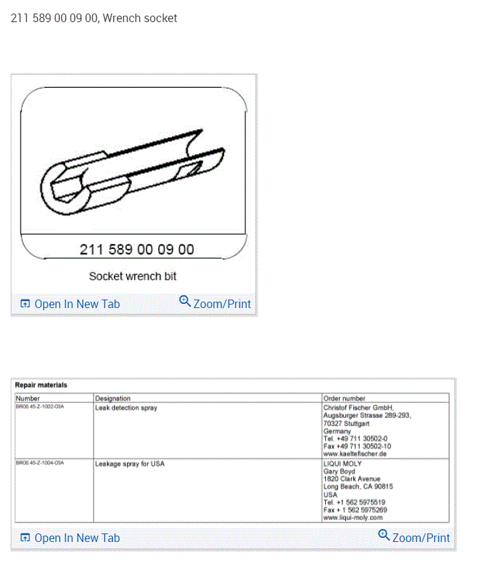

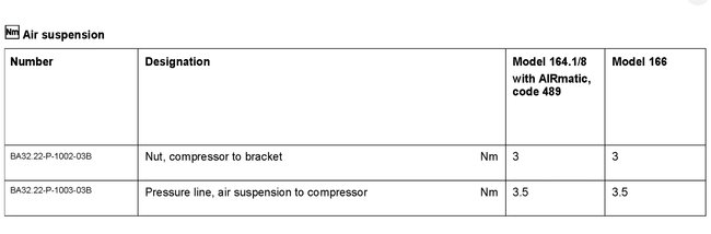

The compressor for the air ride suspension is located behind the front bumper on the right side of the vehicle (passenger side). See pic 1.

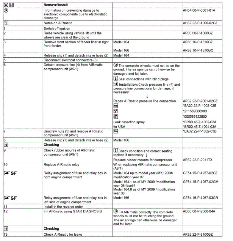

To access it, you will need to remove the plastic splash shields under the front of the vehicle. I believe they are held in with 8mm bolts. There is also a couple of plastic retaining clips.

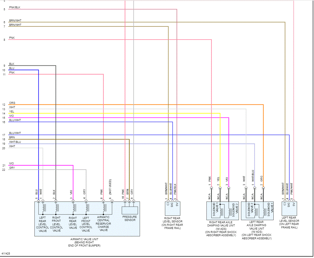

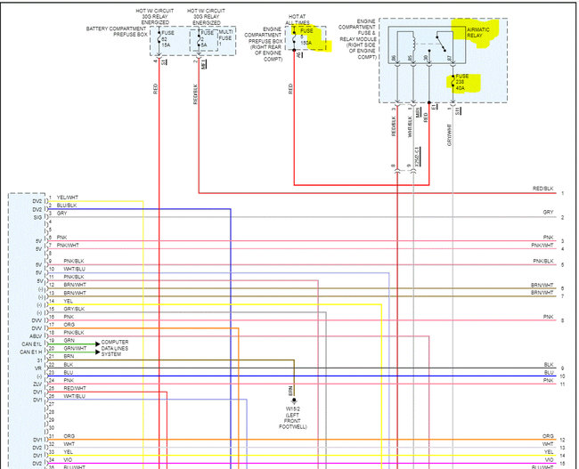

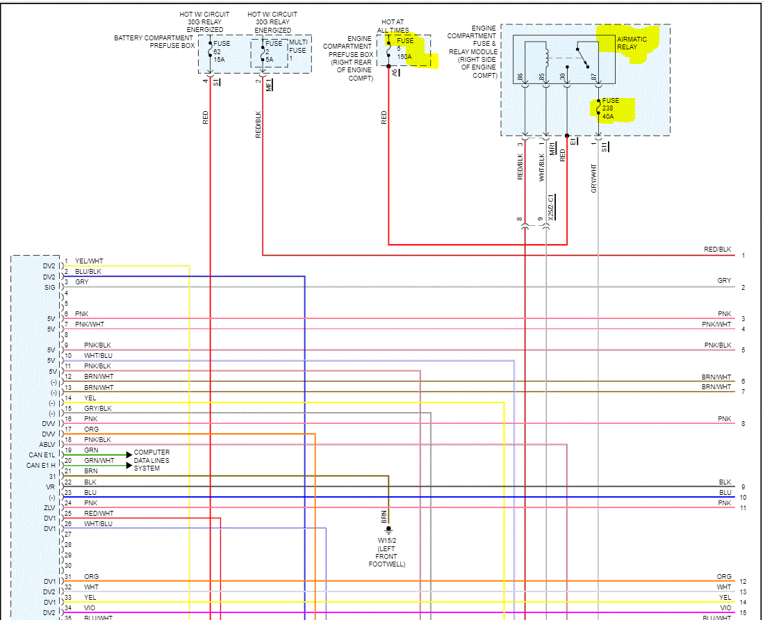

Pics 2-5 show the wiring schematic for the circuit. I highlighted a couple of fuses to check and the compressor relay. These are located under the hood in the pre-fuse box in the right rear of the engine compartment and the fuse/relay box right side of the engine compartment.

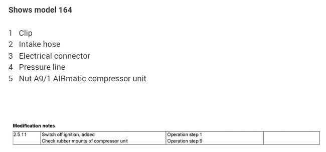

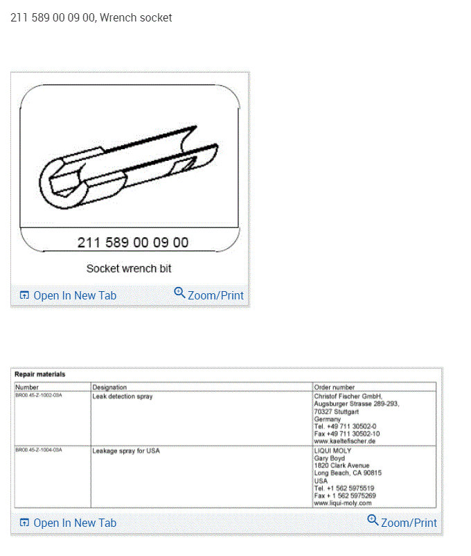

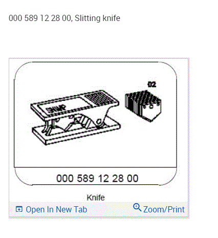

The remaining pics are directions for the replacement of the compressor.
