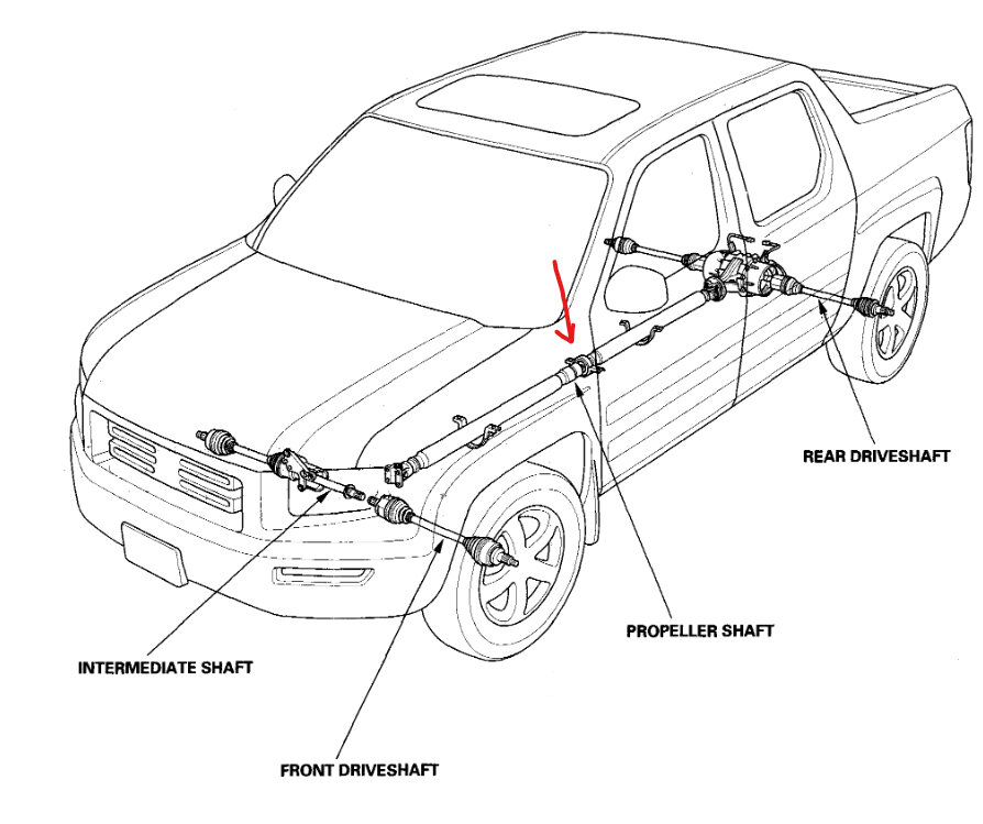

I have seen the driveshaft center support bearing go out and cause this issue. Grasp the driveshaft to pull it back and forth in the center support, it should have very little movement. Check out the images (below). Please upload pictures or videos in your response of any problems so we can see what to help you with.

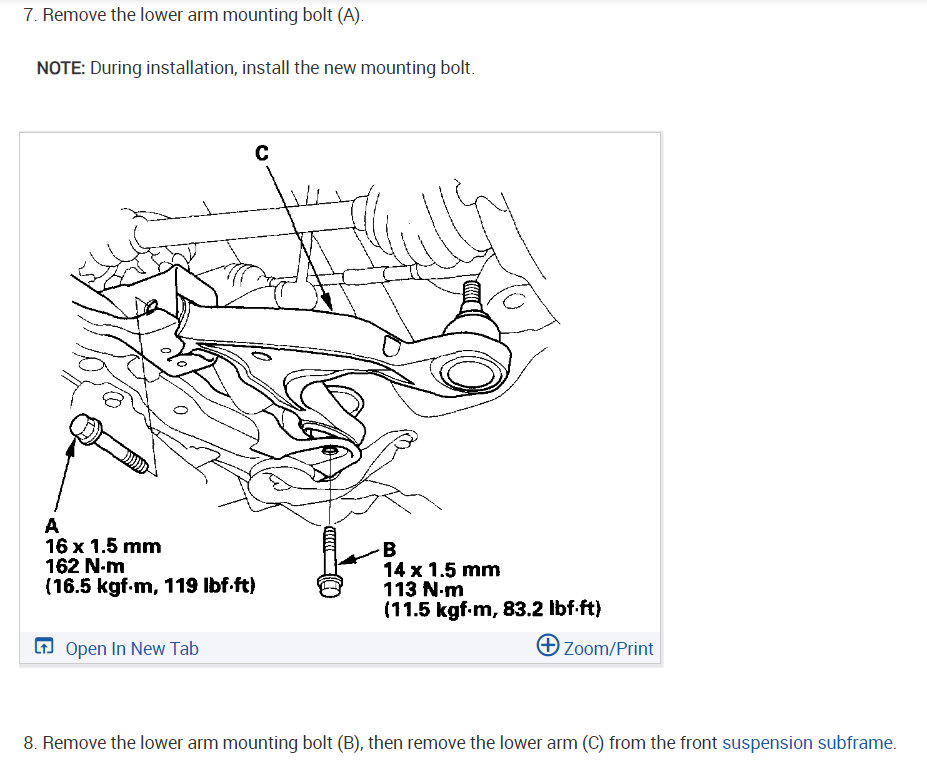

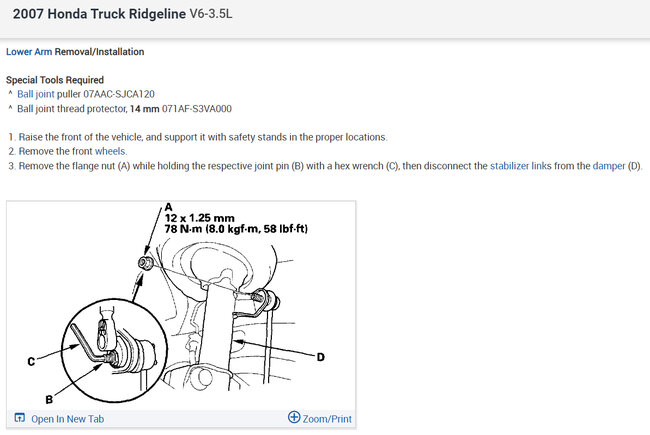

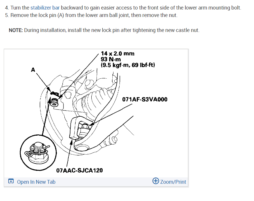

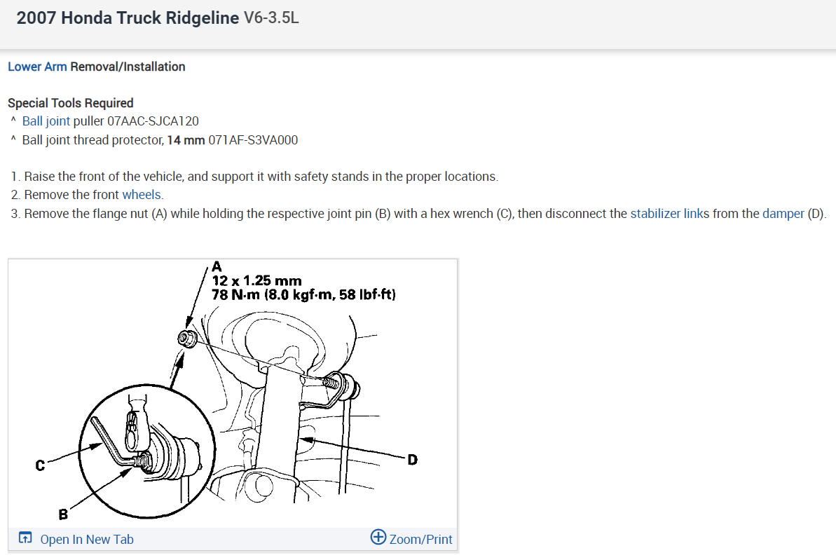

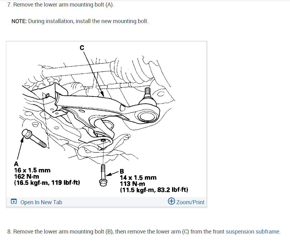

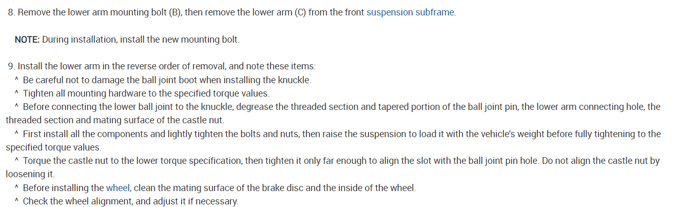

I have seen the lower ball joints go out and cause this issue and at 170,000 it would be a good idea anyway. Here is how. Check out the images (below). Let us know how it goes.
