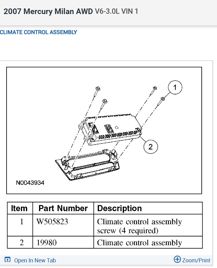

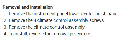

Yep, this can happen when the circuit broad has a bad solder joint, you might be able to see it if you take it parts, if not I would try eBay for a used part. Here is how to replace the HVAC control unit. Check out the images (below). Please let us know what happens.
