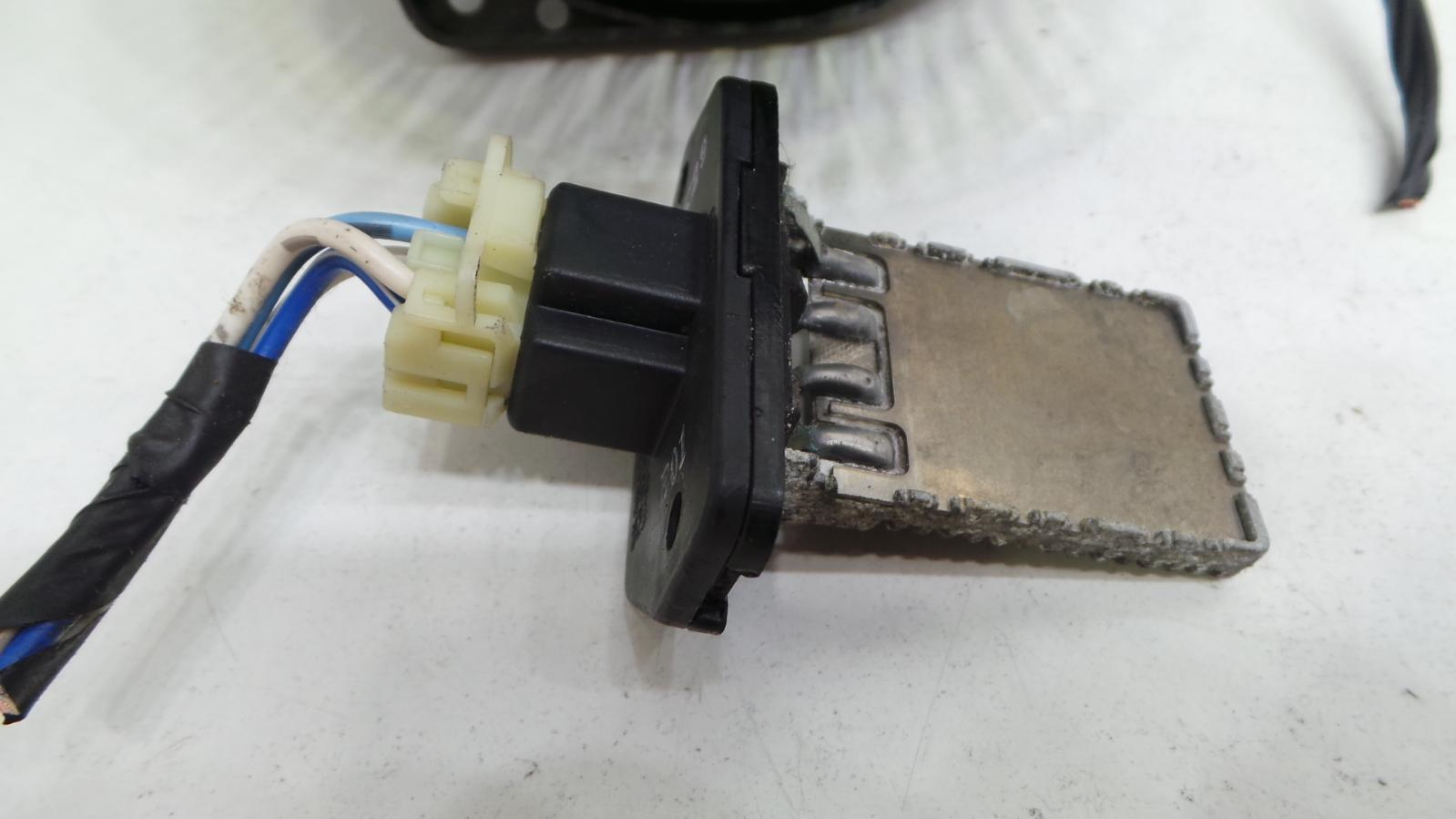

Can someone please tell me where the heating resistor is on my car? please as my heating as stopped working fuses and fan is all okay I had them checked.

here is a picture of it. I think its located in the engine compartment on the fire wall on the pass side of the vehicle. if I am wrong let us know and i will keep looking.

if not in the engine compartment, then it is behind the blower motor to the left, you have to take the glove box out for this, should be a four wire orange plug going into it with two screws holding it in. I have found these two possible locations for it.

unfortunately the video I found for it is in Spanish and I do not speak Spanish, so I had to just watch for its location on the video. Hope this helps.
