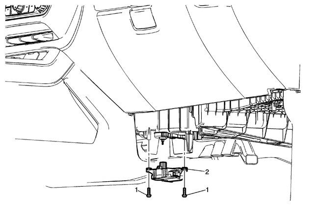

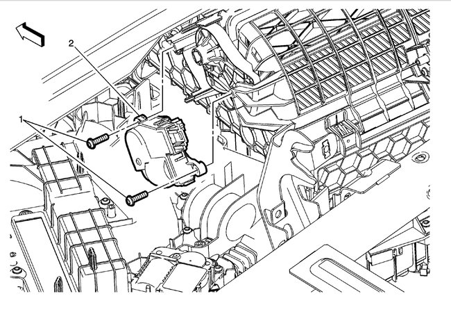

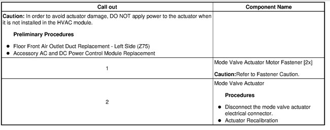

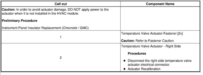

If the level is okay the next place I would check is the mode door actuator which controls the air conditioner and heater functions.
Here is a guide that will give you an idea of what I am talking about
This guide can help as well

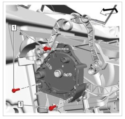

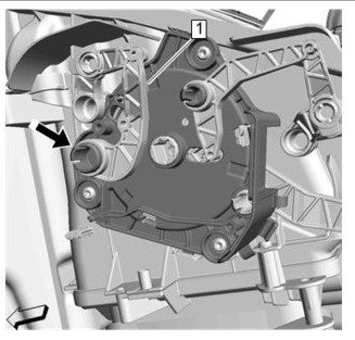

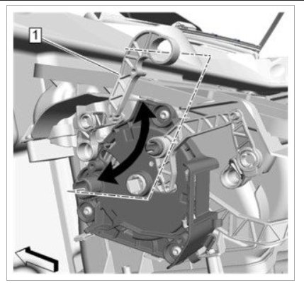

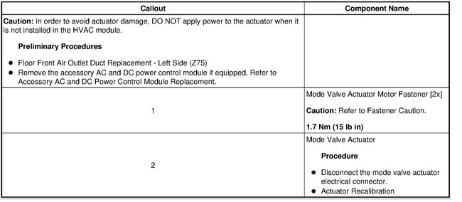

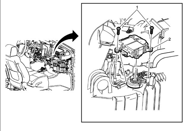

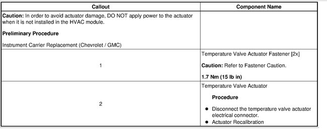

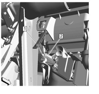

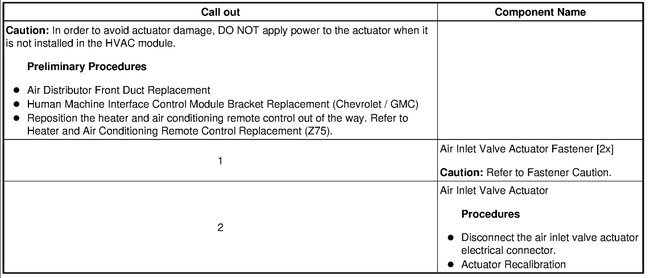

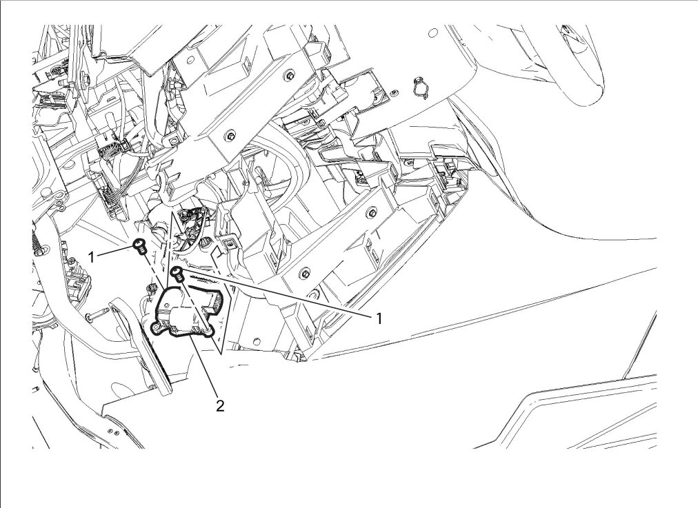

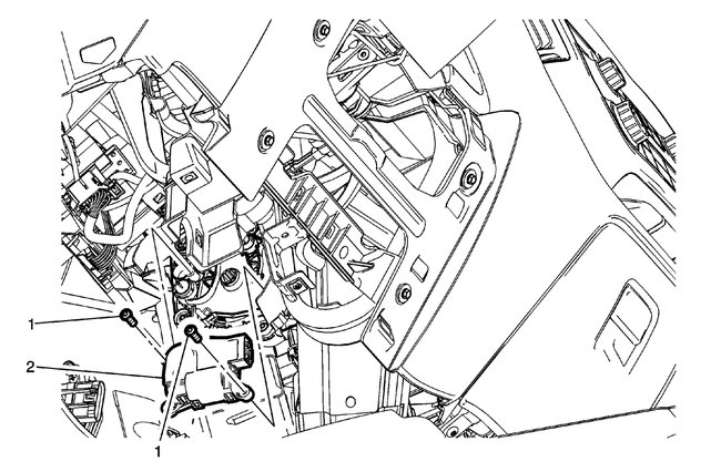

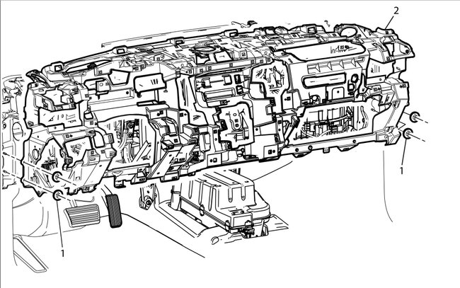

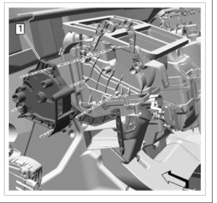

Here is the blend door locations for your car (below)

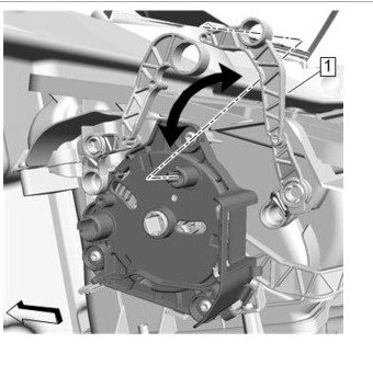

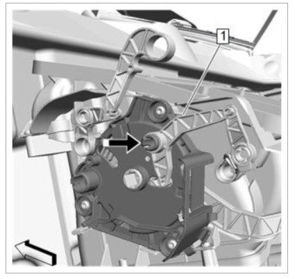

Insert a 3/8 allen wrench into the actuator mode control cam interface drive gear (1), and rotate the mode control cam to the maximum counter clockwise travel position to set to the vent mode.
I have all of the actuators locations in case someone else needs them that visits this post.
