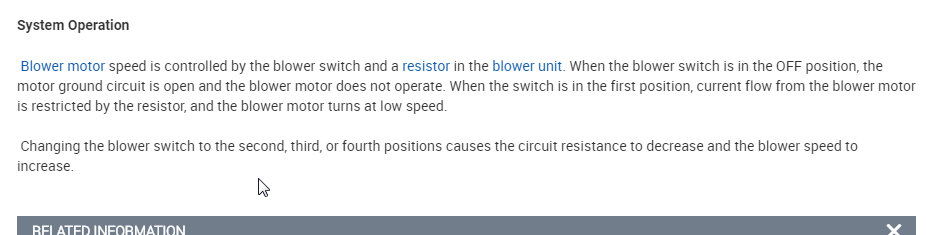

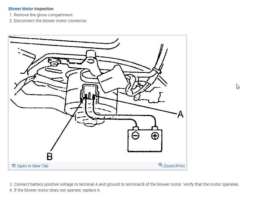

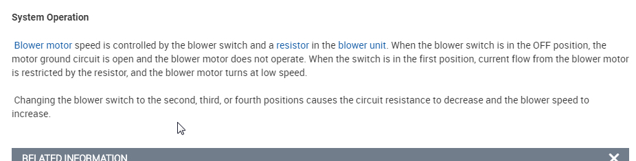

Okay. If the air flow is low then this would point to the blower motor not spinning fast enough. Do you hear the fan speed increase as you move the switch to the faster speeds? If not, how did you check the resistor?
If the fan speed does increase as you move the switch but you still don't have air flow then we need to look into a restriction in the air box or a door issue routing the air improperly.

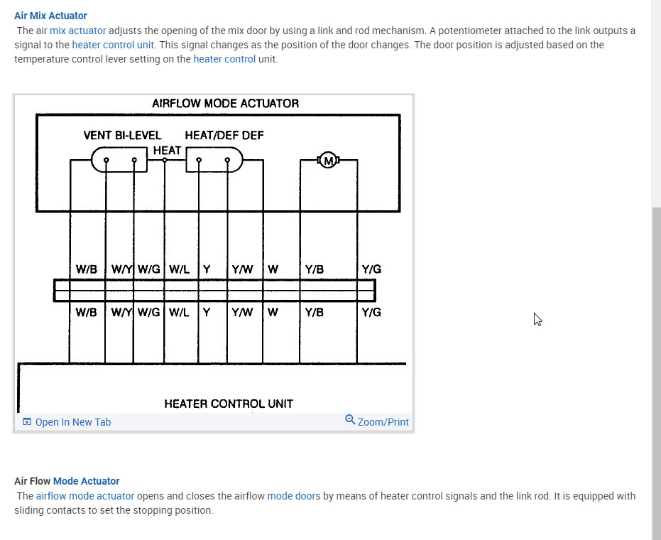

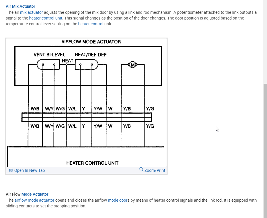

Okay. I suspect you are correct. There is a link and rod mechanism on the housing that the air doors use and if this is not connected or defective then you could have obstructed air flow. You may be able to see an issue from removing the blower motor and looking in there but if not, you may need to remove it.
