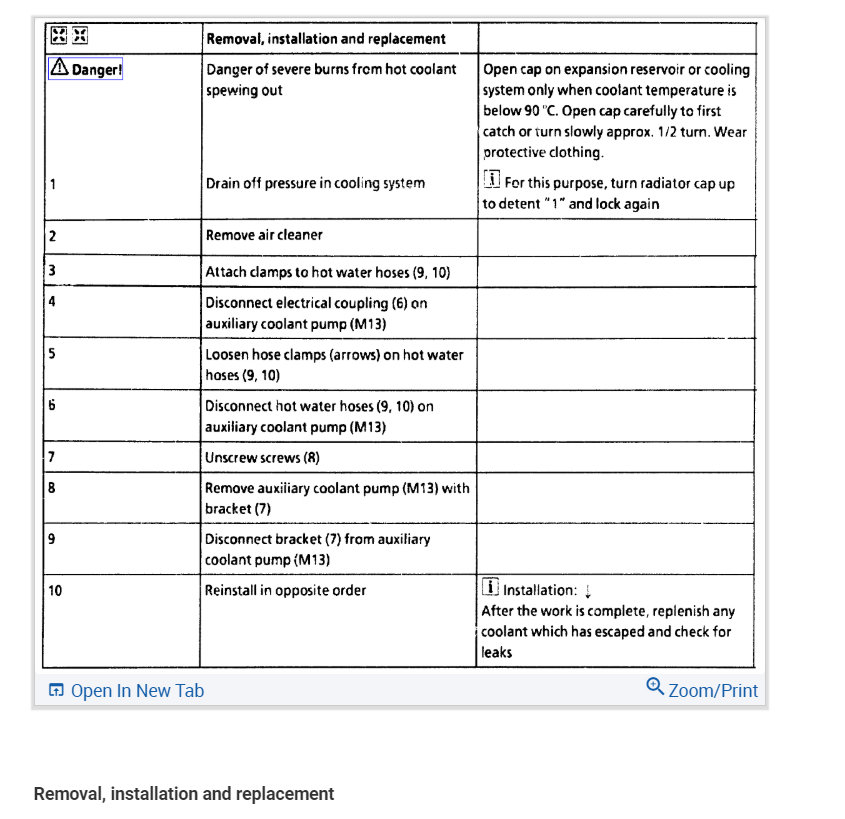

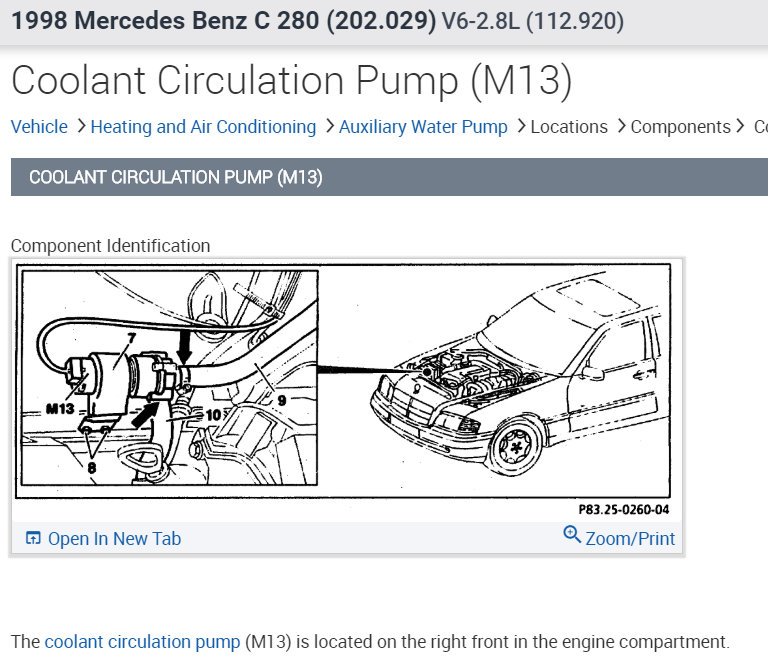

If I can jump in here. the auxiliary water pump must work for the heater to work this pump is responsible for pushing cooling through the heater core. I would remove the unit and test it to make sure it works. Here is the location.
This guide can help as well:
