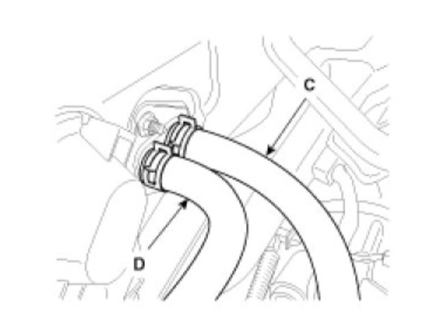

i have the car listed above 1.6 CRDI Diesel European model car. It had heating issue which was fixed previously by changing blocked heater core under the dash that cost me a lot of money but it was fixed and worked for more than a year. Now issue again arise as no heat on passenger side and have mild heat on driver side i checked blend door actuator and it works fine it moved when i turn knob to heat and cold. i have added video that shows it does moves . So what is the possible issue here? i don't know. could you please guide me on it? Thanks a lot.
Apr 4, 2021 at 1:30 PM
Good morning,
When the heater core was replaced, did they power flush the cooling system? This sounds like the heater core is clogged with dirt or debris.
I would remove the heater hoses from the heater core and use a garden hose to flush the heater core. Go back and forth on the core until you have a clean even flow going through the core.
