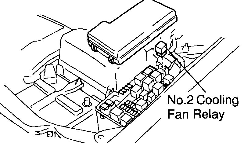

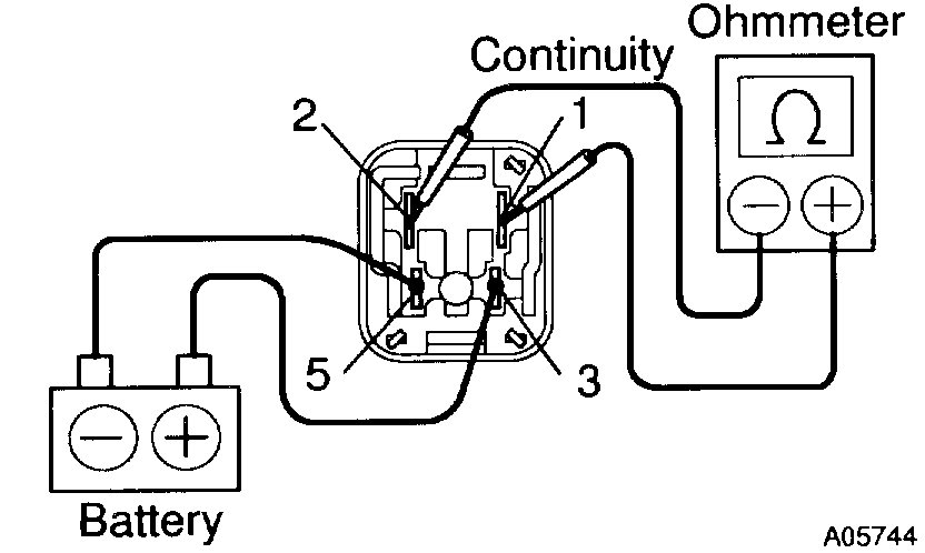

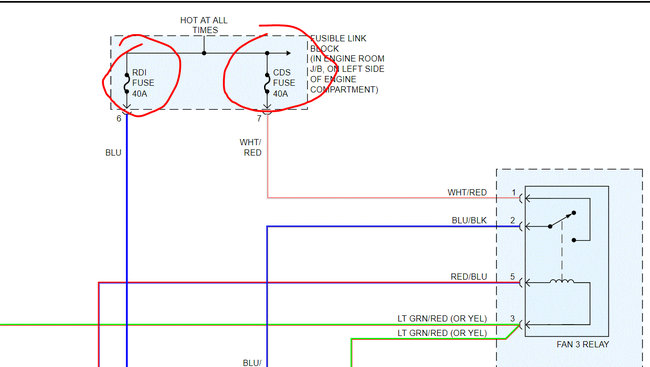

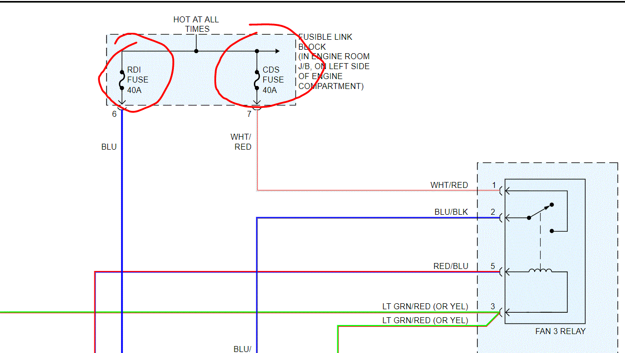

The first thing I need you to check are two fuses in the under hood fuse/relay box. See pic 1.
Next, with the engine cold, key off, turn the fan blade to see if there is resistance or anything that could indicate a problem with the fan.
If nothing seems wrong, check the cooling fan relays. There are three. Here are the directions. The remaining pics correlate with the directions.

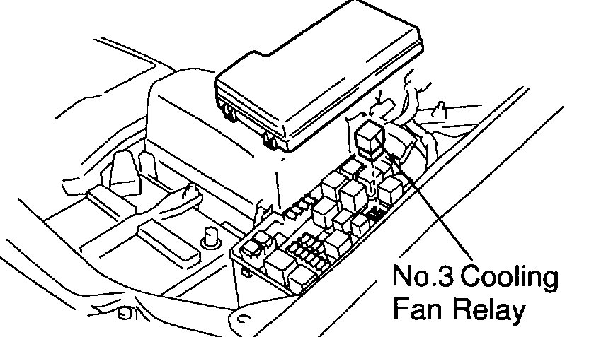

1. INSPECT NO.1 COOLING FAN RELAY
pic 2
a. Remove the No.1 cooling fan relay. (Marking: FAN NO.1)
pic 3
b. Inspect the No. 1 cooling fan relay continuity.
1. Using an ohmmeter, check that there is continuity between terminals 3 and 5.
If there is no continuity, replace the relay.
2. Check that there is no continuity between terminals 1 and 2.
If there is continuity, replace the relay.
pic 4

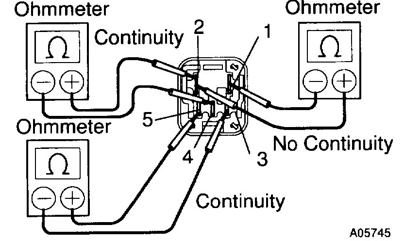

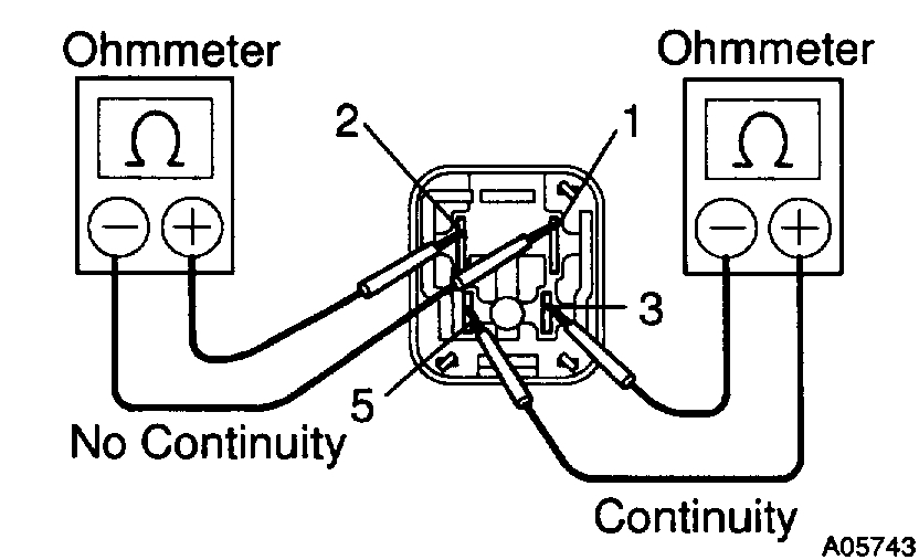

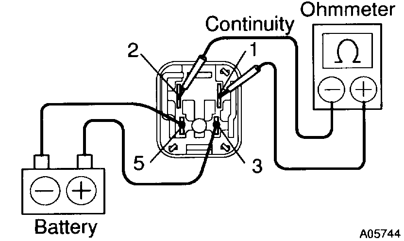

c. Inspect the No.1 cooling fan relay operation.
1. Apply battery voltage across terminals 3 and 5.
2. Using an ohmmeter, check that there is continuity between terminals 1 and 2.

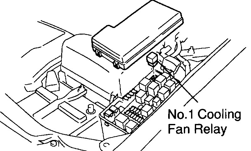

2. INSPECT NO.2 COOLING FAN RELAY
pic 5
a. Remove the No.2 cooling fan relay. (Marking: FAN NO.2)
pic 6

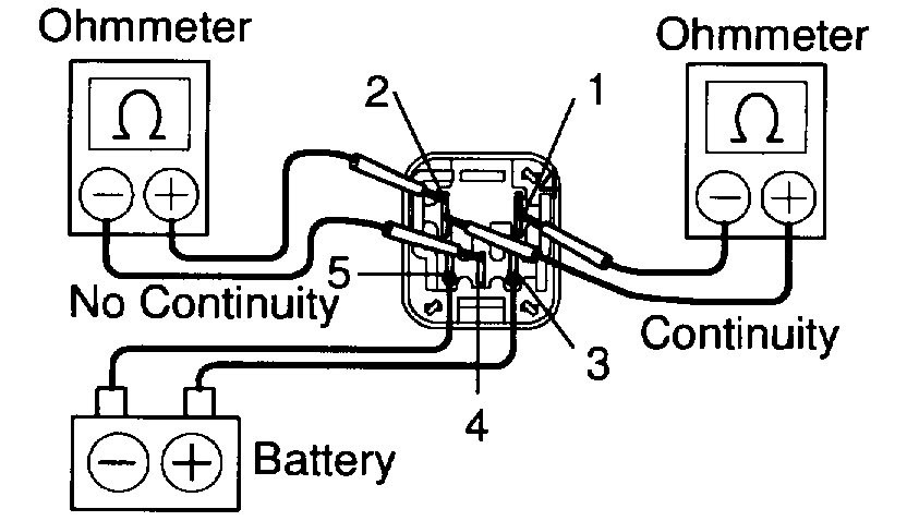

b. Inspect the No.2 cooling fan relay continuity.
2. Check that there is continuity between terminals 2 and 4.
3. Check that there is no continuity between terminals 1 and 2.

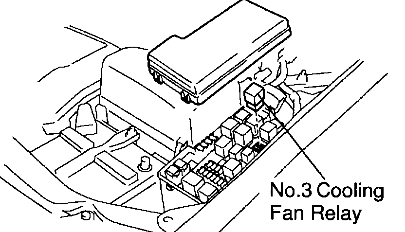

3. INSPECT NO.3 COOLING FAN RELAY
pic 8
a. Remove the No.3 cooling fan relay. (Marking: FAN NO.3)
pic 9
b. Inspect the No.3 cooling fan relay continuity.
pic 10
c. Inspect the No.3 cooling fan relay operation.
d. Install the No.3 cooling fan relay.

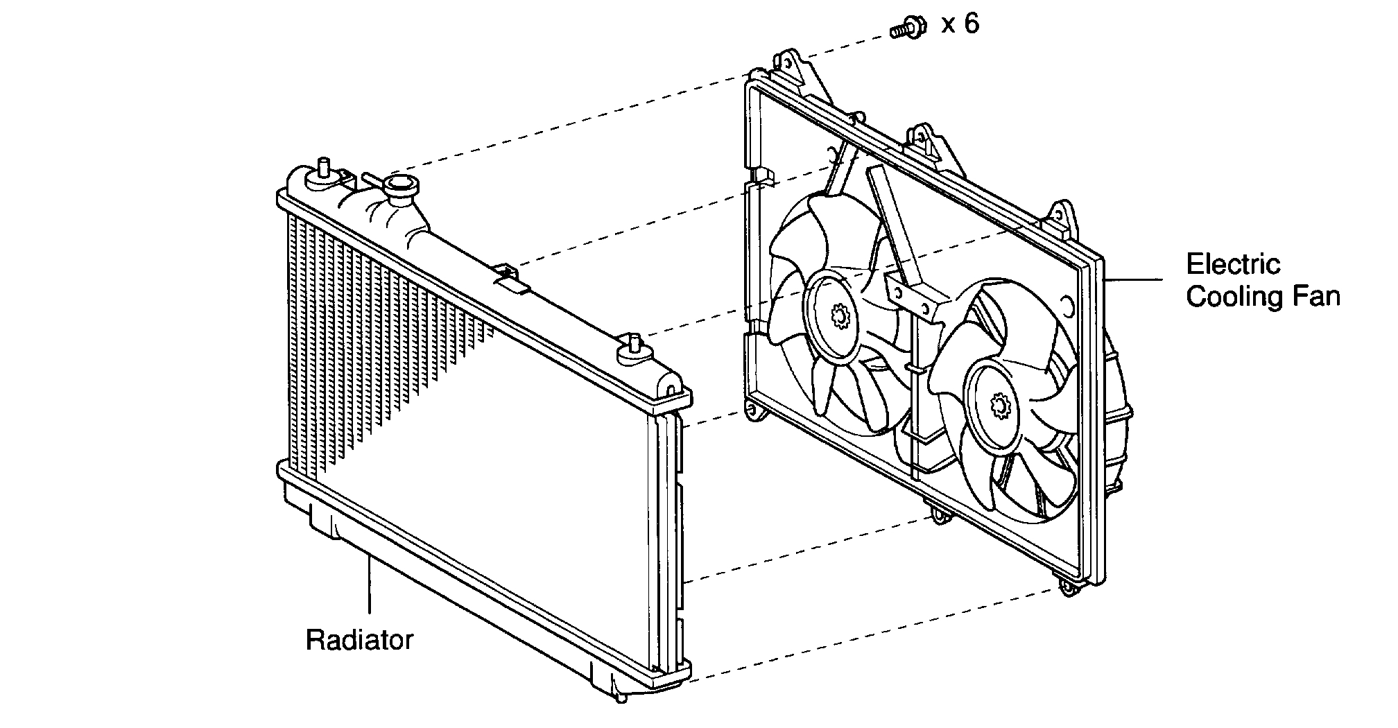

If you find the fan motor is bad, here are the directions for replacement:
2000 Lexus Truck RX 300 AWD V6-3.0L (1MZ-FE)
Procedures
Vehicle Engine, Cooling and Exhaust Cooling System Radiator Cooling Fan Radiator Cooling Fan Motor Service and Repair Procedures
PROCEDURES
pic 11
pic 12
pic 13
pic 14

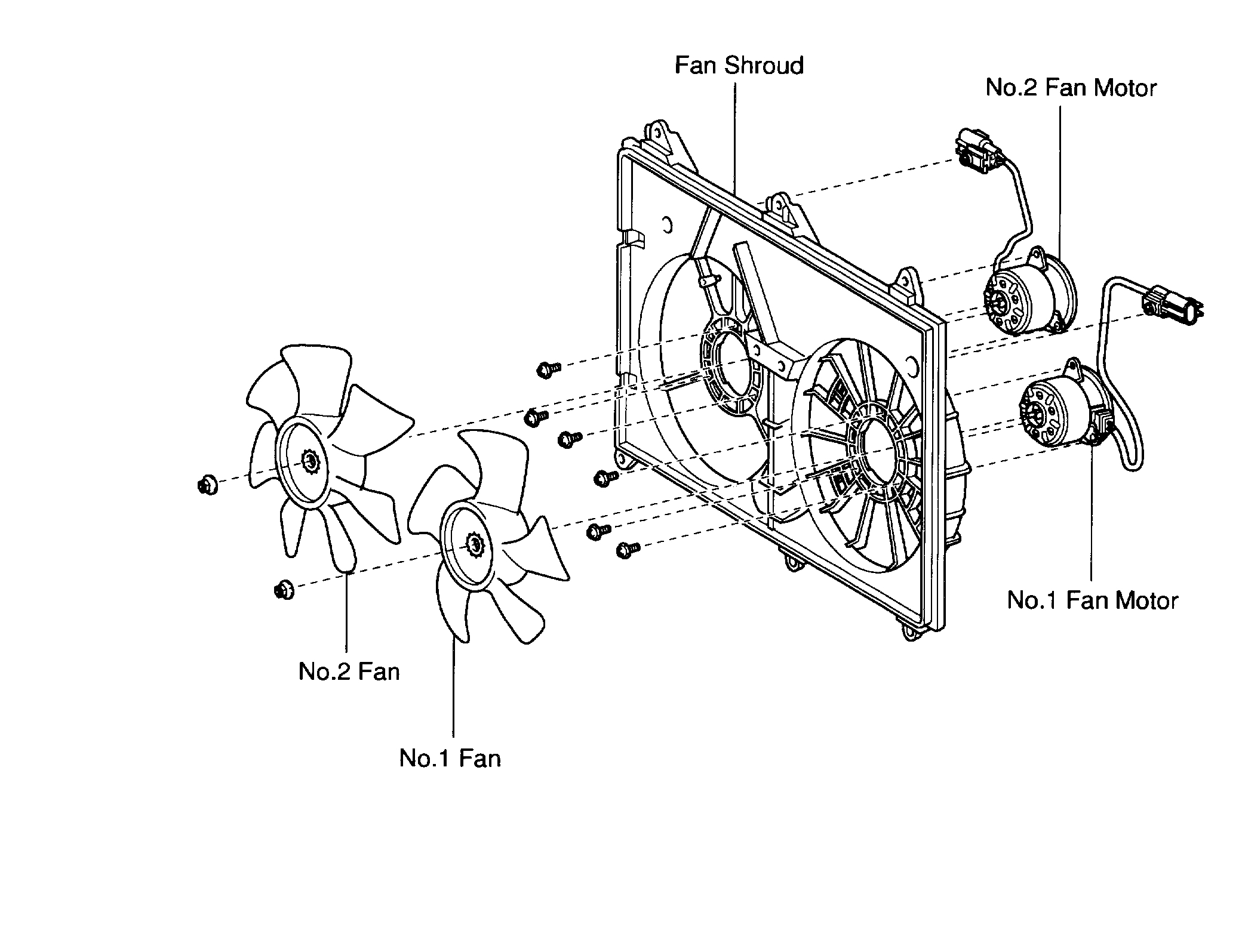

REMOVAL

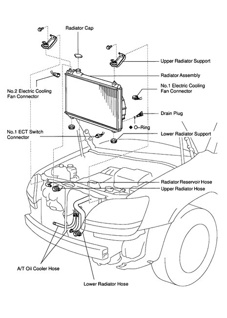

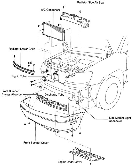

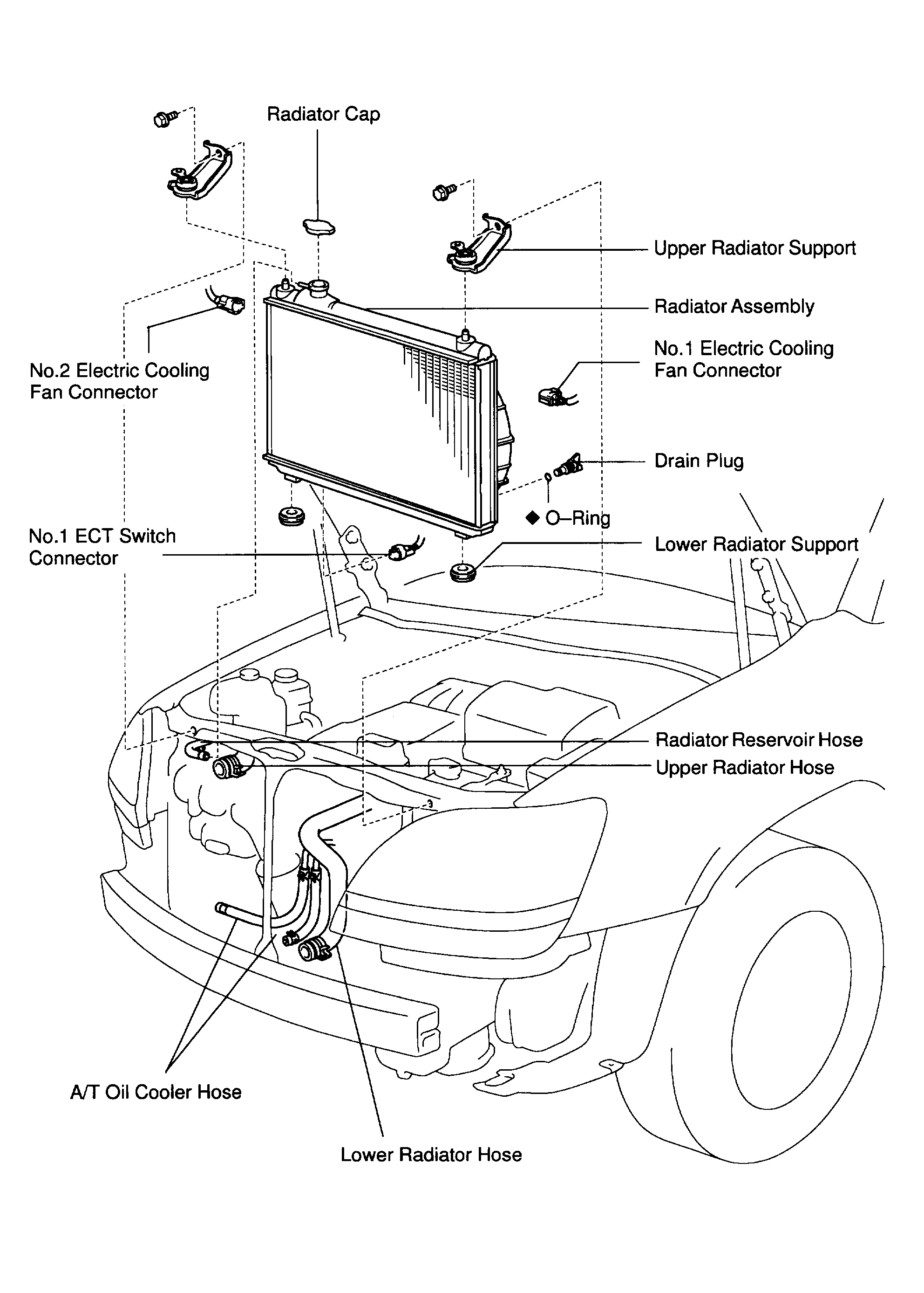

1. REMOVE RADIATOR ASSEMBLY
pic 15

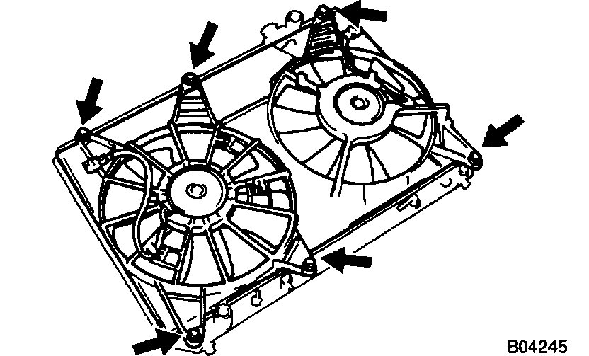

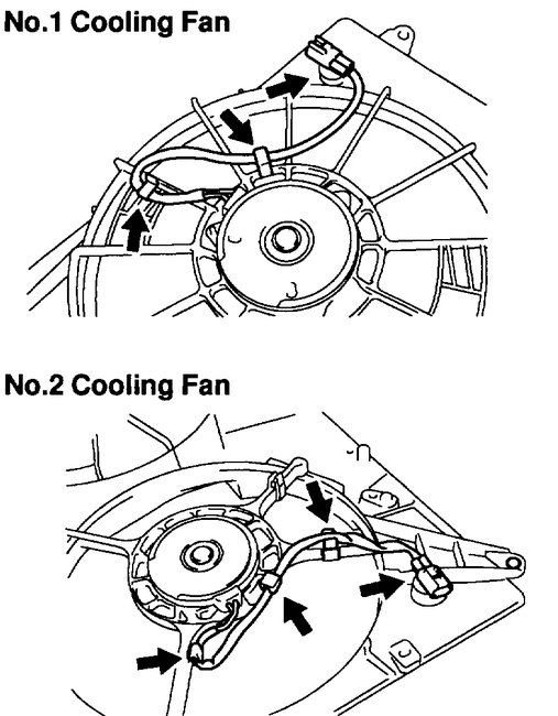

2. REMOVE ELECTRIC COOLING FAN FROM RADIATOR
Remove the 6 bolts and cooling fan.
Torque: 5.0 Nm (50 kgf-cm, 44 inch lbs.)

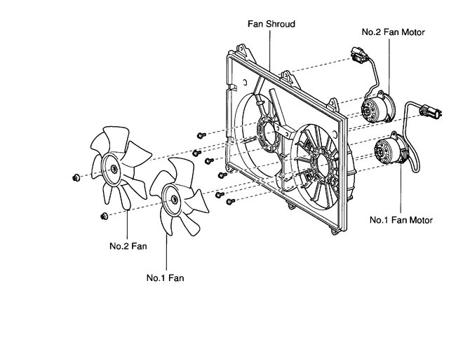

DISASSEMBLY
pic 16

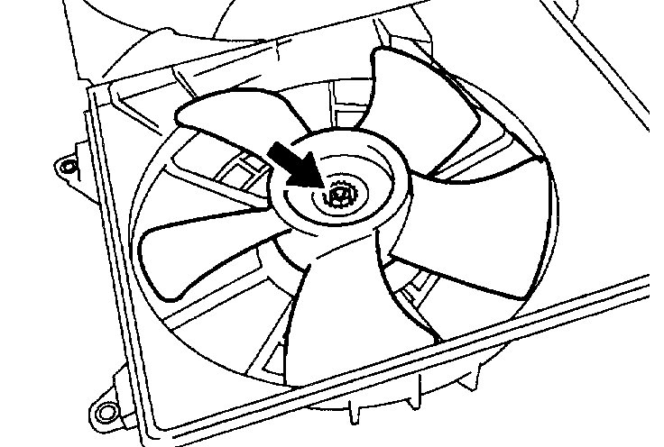

1. REMOVE FAN
Remove the nut and fan.
pic 17

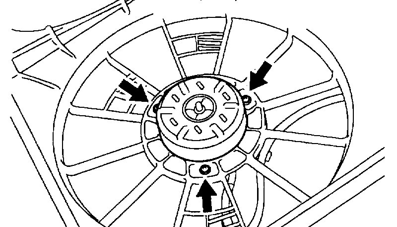

2. REMOVE FAN MOTOR
a. Disconnect the wire and connector holder from the fan shroud.
b. Remove the 3 screws and fan motor.

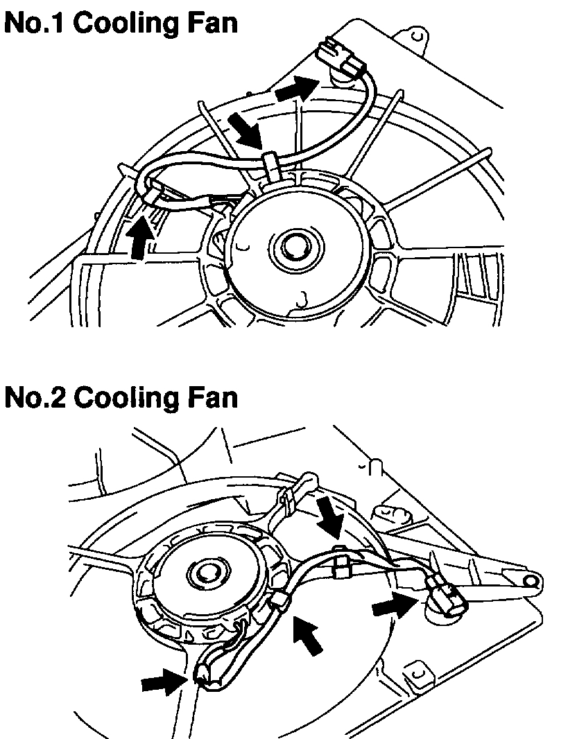

pic 18
1. INSTALL FAN MOTOR
a. Install the fan motor with the 3 screws.
b. Install the wire and connector holder to the fan shroud.
2. INSTALL FAN
Install the fan with the nut.
