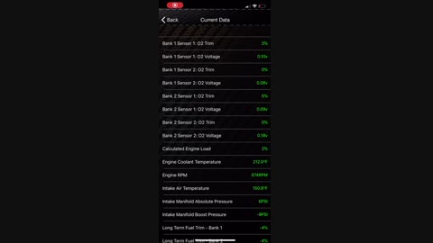

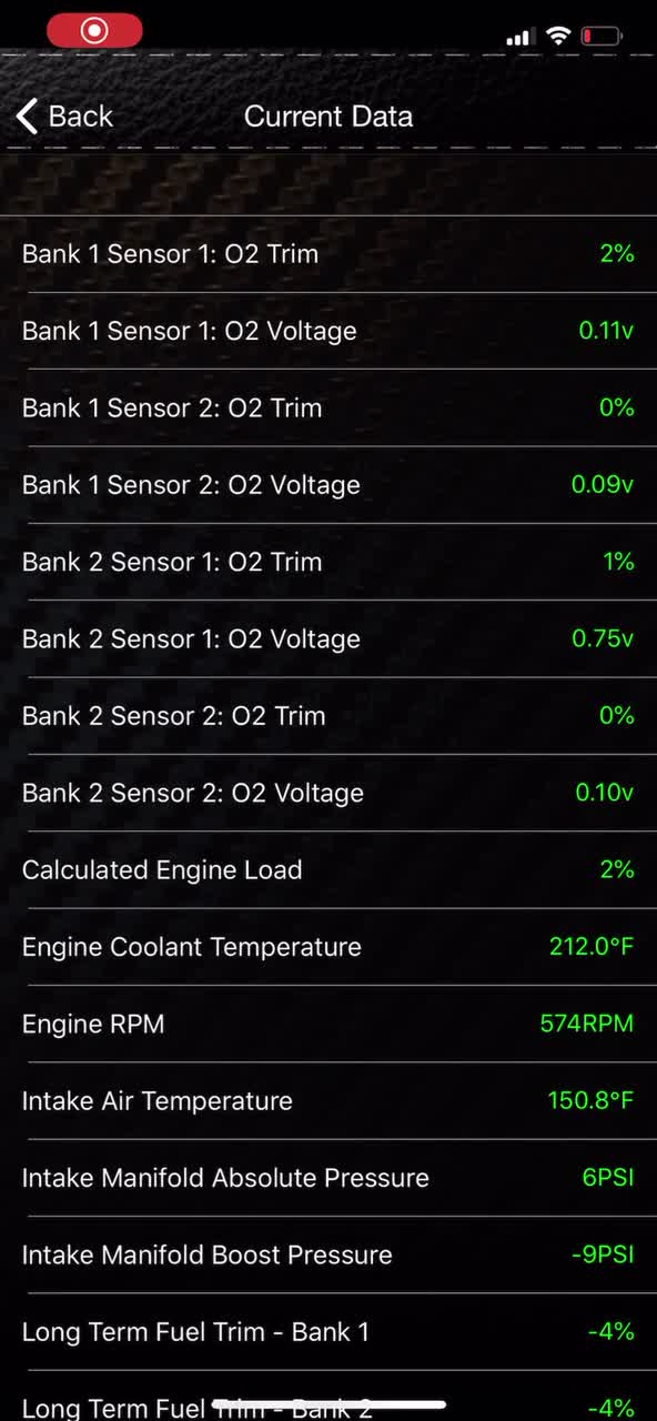

Check engine light, it doesn’t illuminate. I do have an OBDll that can stay plugged in and I can monitor it on my phone. ($20.00 on Amazon) I’ll plug it in first thing in the morning and take a few screenshots and add them. Like I said, I’m no expert mechanic. I know enough to get me out of a serious bind.

The only thing I can logically think would be a culprit to the truck still over heating after idling would be the spaces in the radiator being dirty. Washed my truck yesterday and spray a little high pressure water through the radiator and nothing but black water drained from it. So instead of spreading $200.00 on a new one right off I am going to pull the existing one and and clean it thoroughly and see if that helps. Fingers crossed.
Also, attaching a video of my truck at an idle at lunch yesterday.
