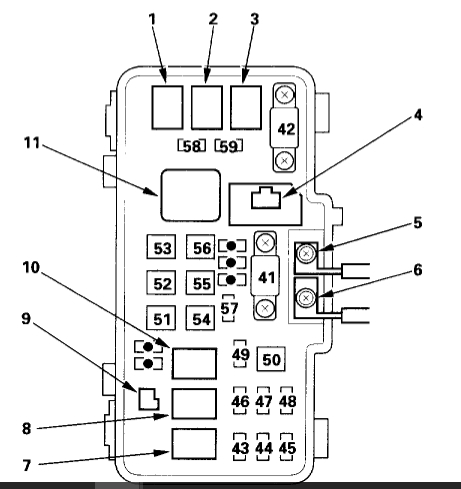

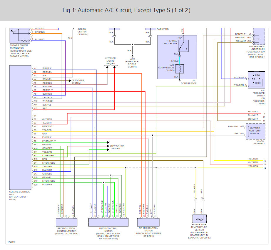

The heating and air went out. it is like the fan is not kicking on to blow the hot or cold air out. i did the self check on it and the letter N pop up on mine. can you please tell me what this means?
Dec 7, 2017 at 8:24 PM
  • 55,433 POSTS

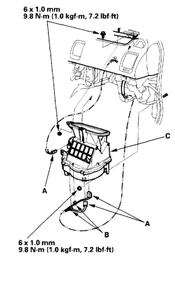

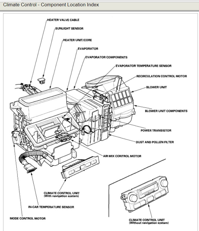

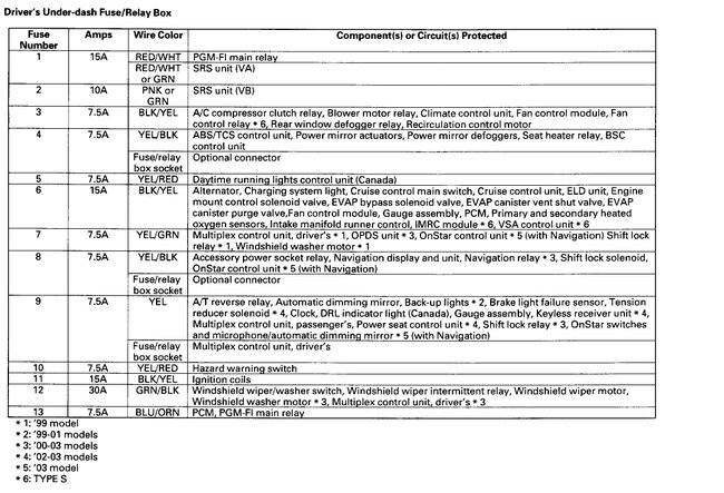

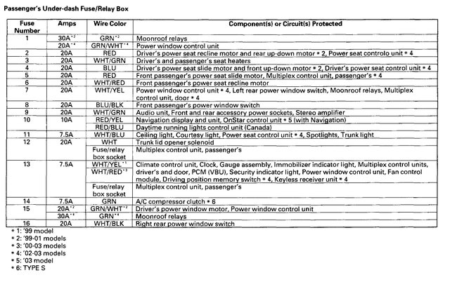

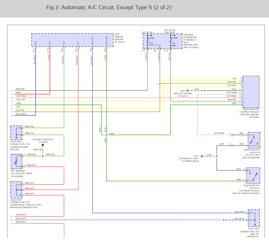

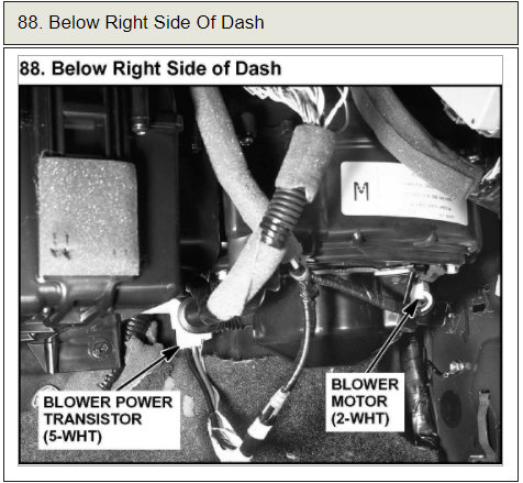

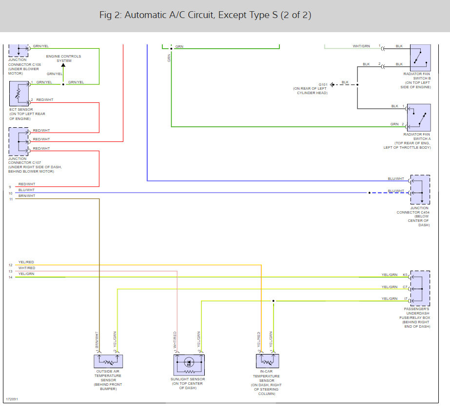

N stands for no codes to report. This sounds like you have a blower motor that has gone out.
Here is a guide to help you see what you are in for and how to confirm the failure:
https://www.2carpros.com/articles/blower-fan-motor-works-on-high-speed-only

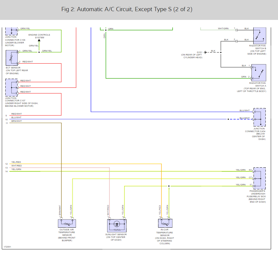

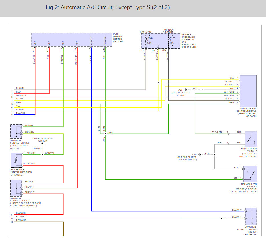

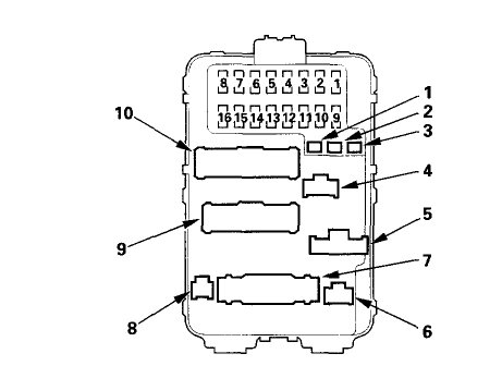

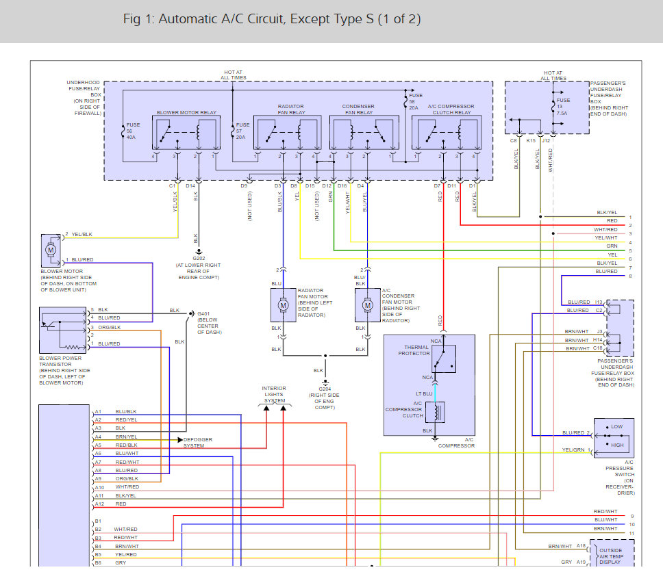

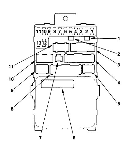

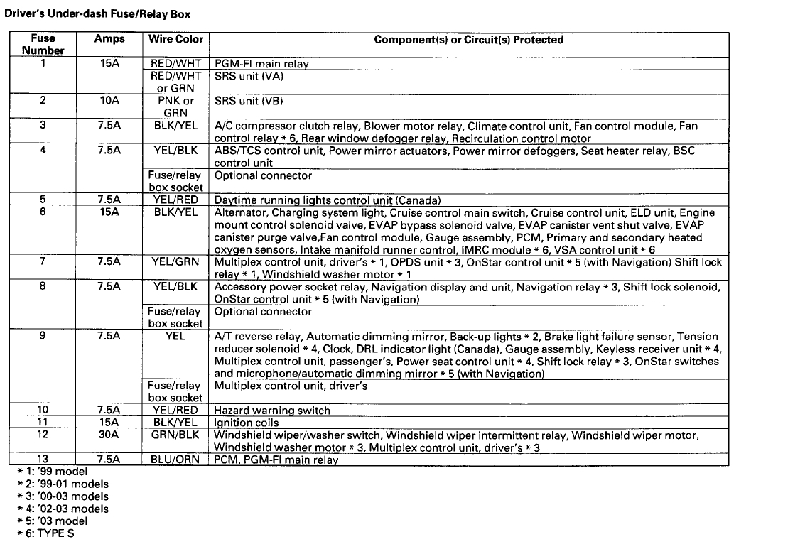

Below are some guides to help check the power and the fuse panels for the car.

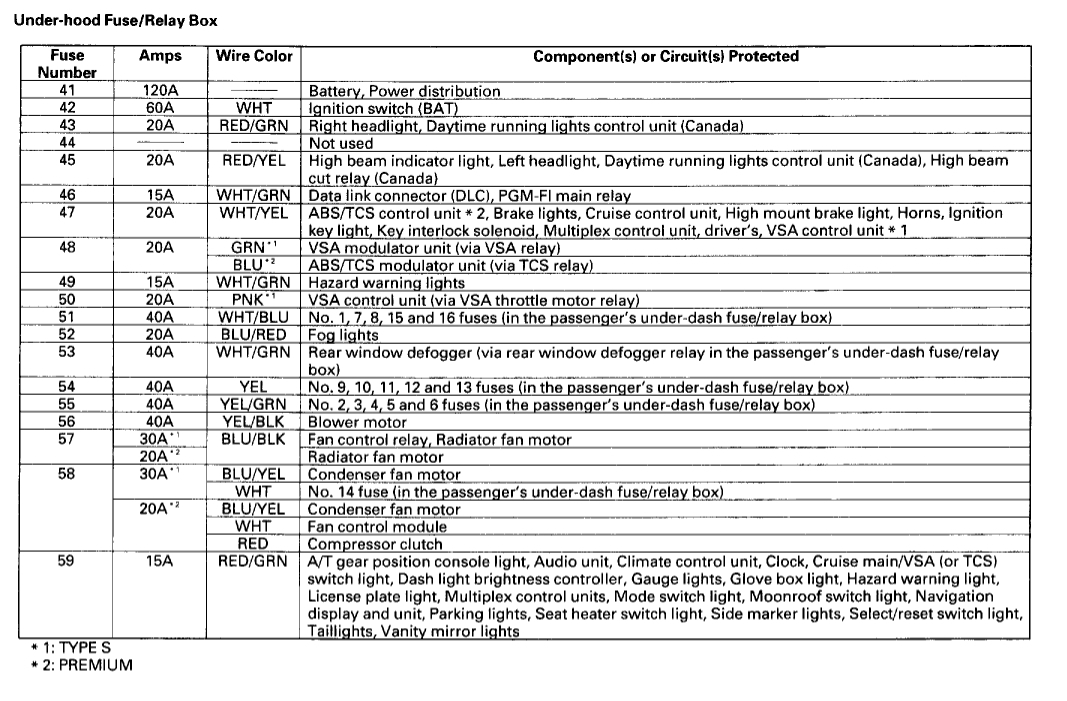

There is a fuse number 56 and a relay that runs the system as well.
Here are two guides to help with that:
and
