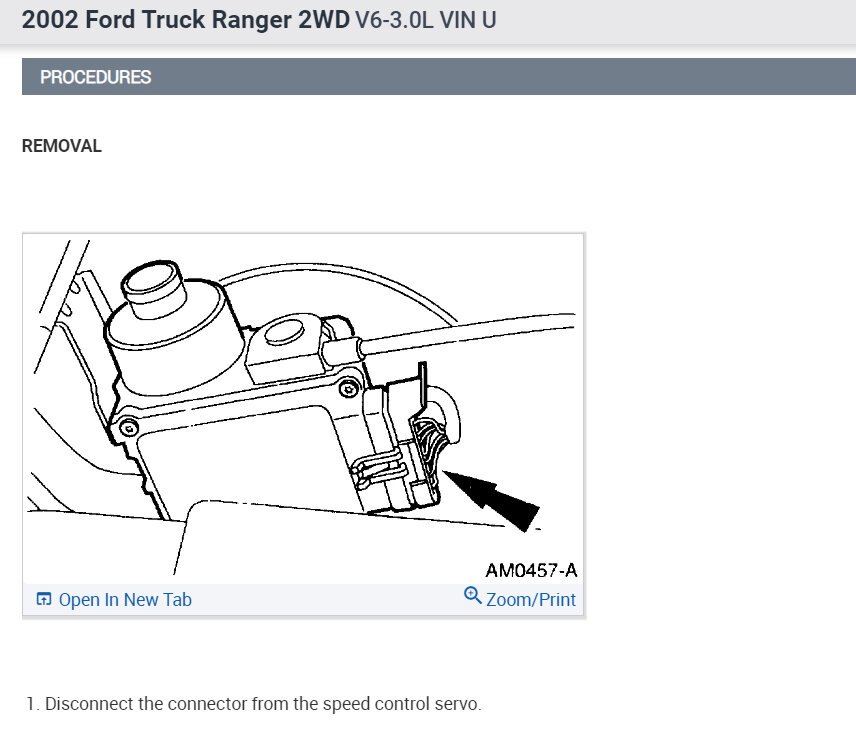

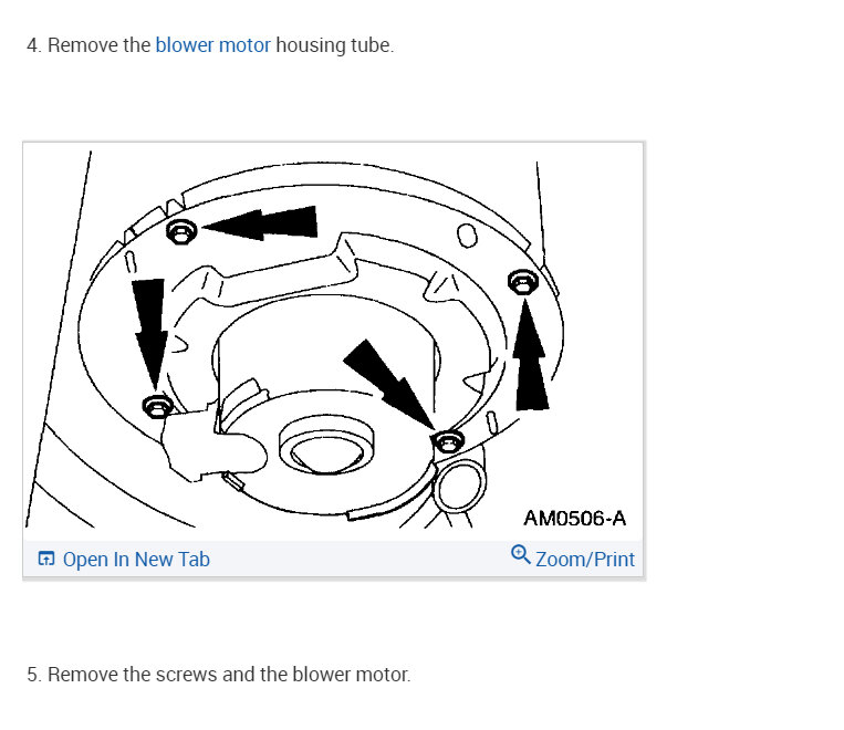

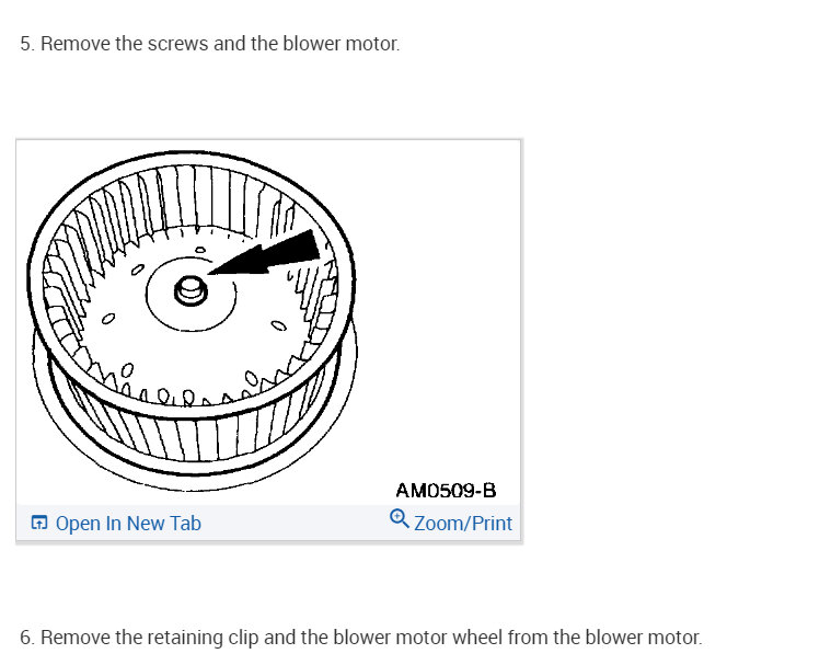

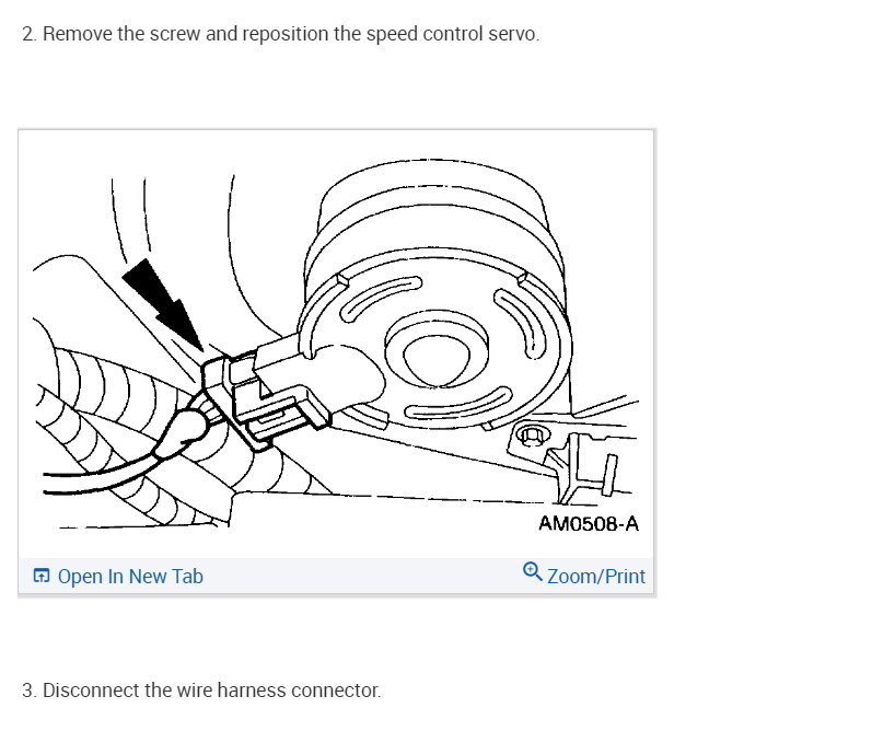

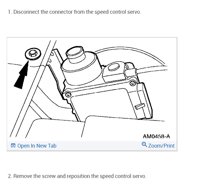

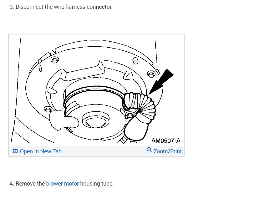

Most of the time the blower motor will be at fault, but to be sure this guide can help you test the power and grounds:
https://www.2carpros.com/articles/blower-fan-motor-works-on-high-speed-only
Here is the location of the blower motor. Check out the images (below). Please let us know what happens.
