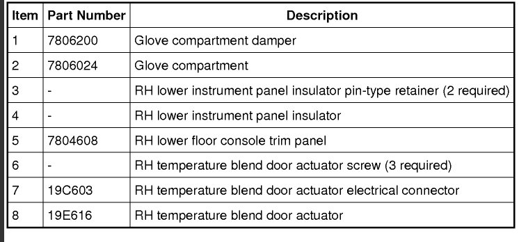

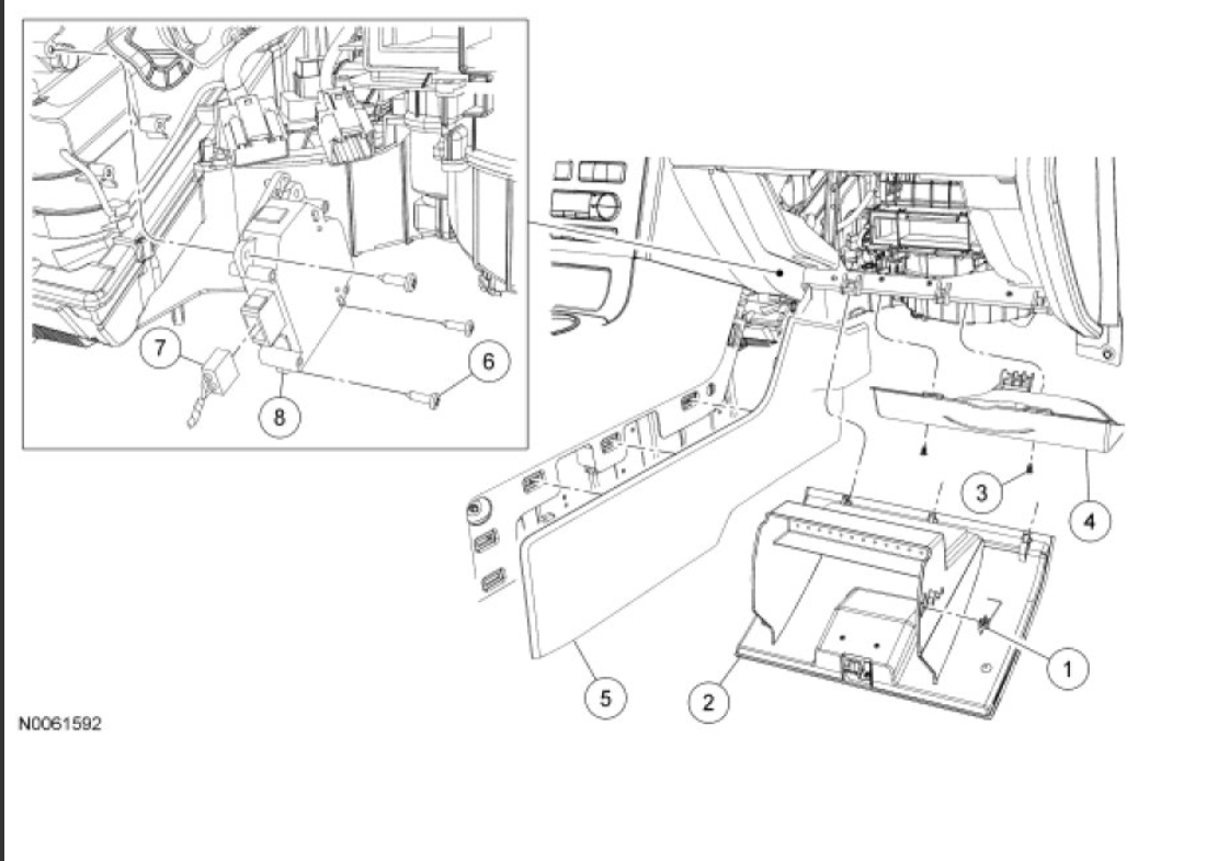

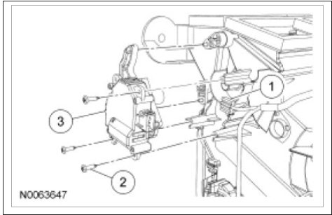

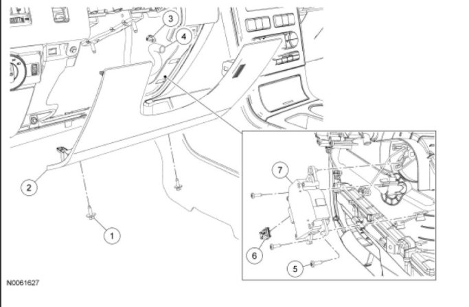

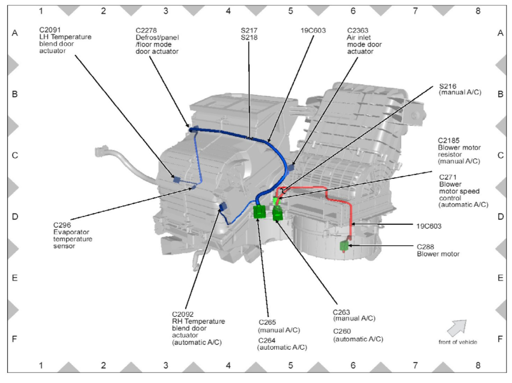

Yes, you have a right side temperature blend door actuator.
Here is a guide to help you see what you are in for when doing the job:

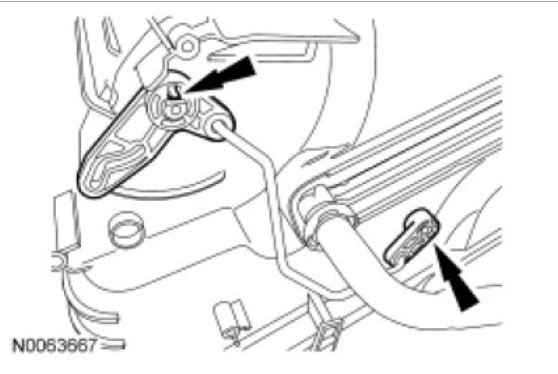

NOTE: It is not required to install the new right hand temperature blend door linkage parts included in the right hand temperature blend door actuator service part kit if only the temperature blend door actuator requires replacement and the linkage parts are not broken or binding.
Below is how it will be for your car. I have included the right, mode and left side actuators for anybody else that needs it.
