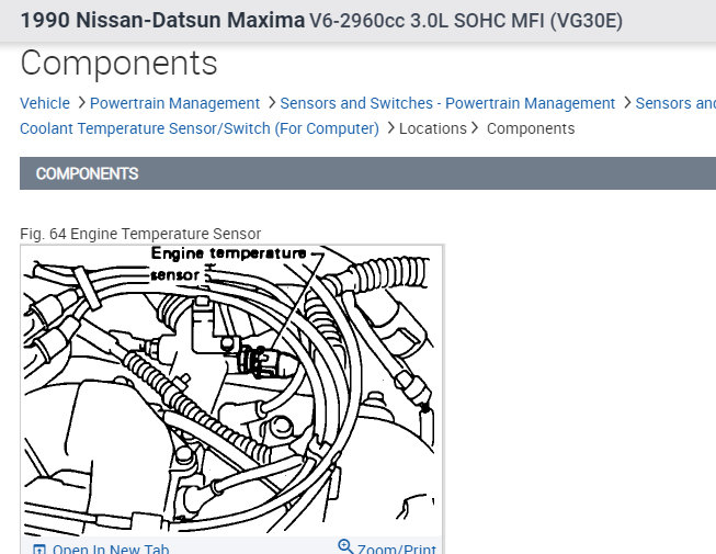

Runs for 10 minutes then starts running rough and the 2 fans won’t kick on. Also, the temperature gauge on the dash doesn’t show it’s hot.
May 7, 2022 at 6:12 AM
SQM
Experienced Mechanic
6,383 POSTS

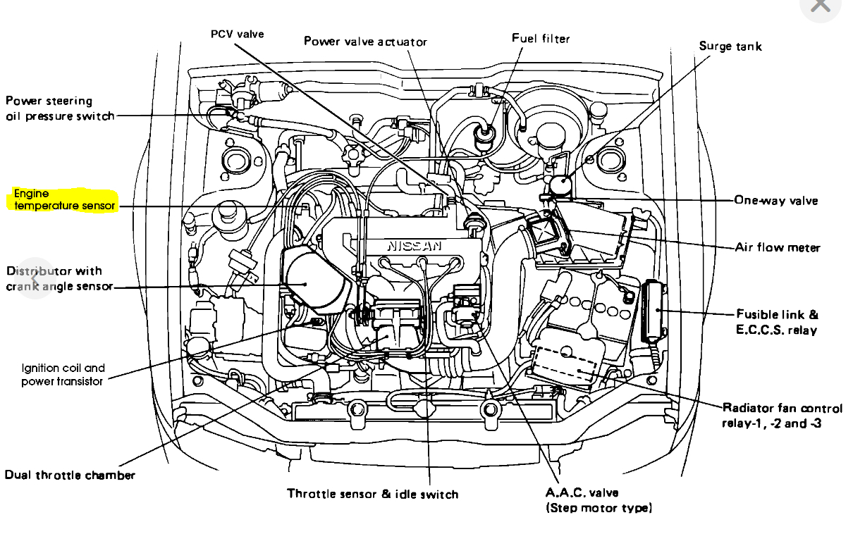

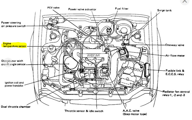

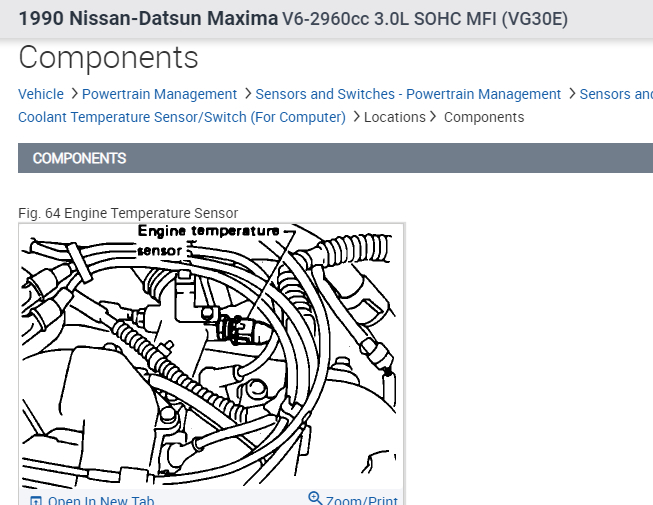

The first item you need to check is the coolant temperature sensor.
The sensor provides a signal for the gauge and the cooling fan to come on.
https://www.2carpros.com/articles/how-a-coolant-temperature-sensor-works
The coolant temperature sensor is located on the water inlet housing.
I have attached diagrams below for your reference.
Let me know of any questions.
