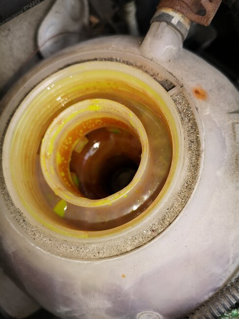

CHRIST CHEN
  • 36 POSTS
Hi Joe,
Sorry for the delay, I had a hard time finding proper material.
I did try the dye (see on photo), drove for about 70 miles and can't see any leaks (bright yellow dye spots) anywhere even under the timing belt cover, but the smell was still there only between radiator and engine (transmission side). no smell inside the car, so it's surely not the heater core at this point, I'm confused.
Can it be the radiator itself but doesn't show significant leaks?
Christian
Aug 25, 2024 at 5:51 AM
  • 110,248 POSTS
If you smell it but see no leaks, the only thing I can think of to do at this point would be a pressure test.
Now, I reread through our conversations. You noted that the supply hose for the heater gets hot, but the return doesn't. It sounds like the heater core itself is partially clogged.
This is where I may run into trouble. I know this is a Canadian Golf. The only 2.0L I show is a diesel. I don't think that is what you have, correct?
Let me know. I may need you to disconnect the supply hose to the heater core and spray water through it to see if the water comes out the return hose.
Aug 25, 2024 at 12:34 PM

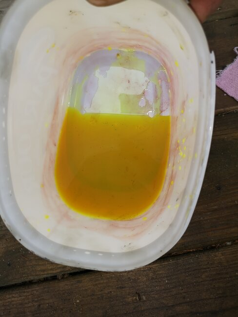

CHRIST CHEN
  • 36 POSTS
Hi Joe,
On the pic, it shows how much coolant there was in the heater core (i don't know how much there supposed to be) and there was no obstruction in heater core.
I used a garden hose to flush it both ways(inlet,outlet).
Still same issue.
I start to think it's the engine radiator itself or there is some exhaust getting in the system by head gasket.
Christian
Aug 31, 2024 at 1:35 AM
