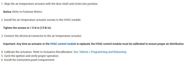

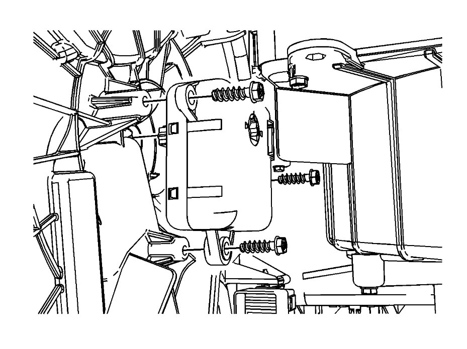

The heater won’t work but the AC works great. I figured blend door but there’s no noise and when I turn the heat all the way up and set it to the foot heater I can feel just a little heat. Cold air out the front and windshield defroster but a weak warm blowing on the feet. Could it be a clogged heater core?
Nov 20, 2024 at 10:33 PM
  • 55,694 POSTS

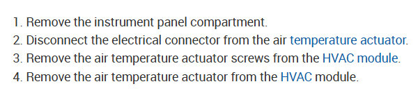

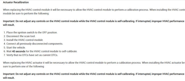

It could be the heater core, but can I ask if the blower motor is working? Can you hear the fan running? If so, I would check the temperature blend door actuator. If you remove the actuator, you can work the pivot by hand to see if it makes a difference when the system is on. Please go over this video as well:
https://www.youtube.com/watch?v=SNRb6pSwYuU&t
Here is the actuator location so you can check out and get back to me. Check out the images (below). Let us know what you find.
