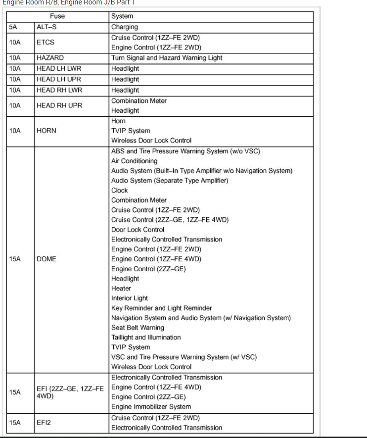

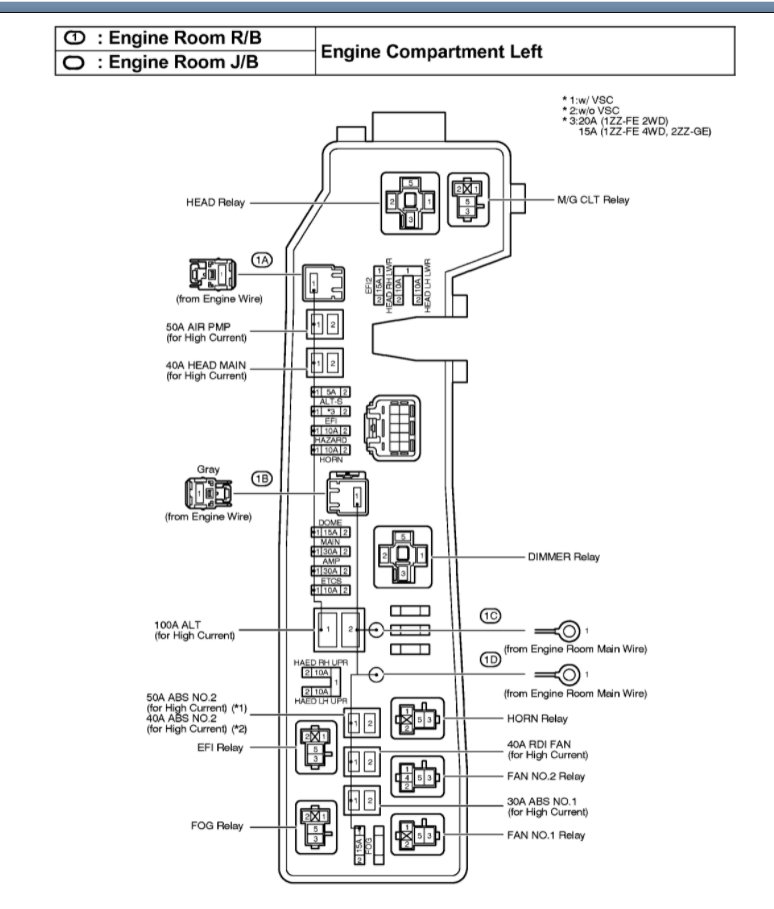

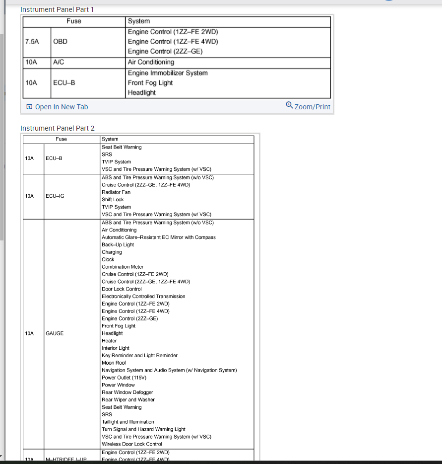

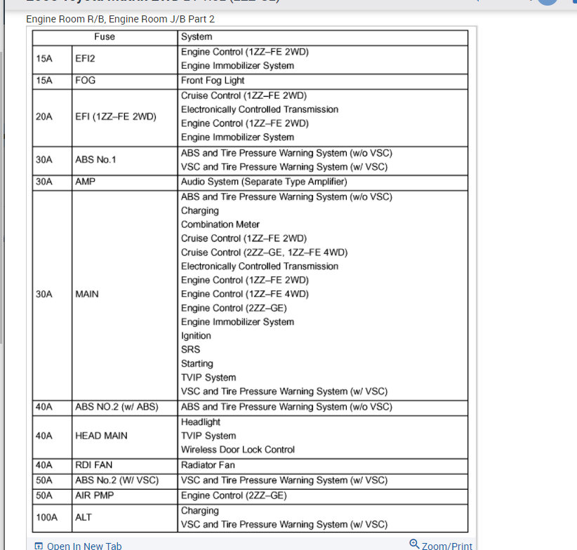

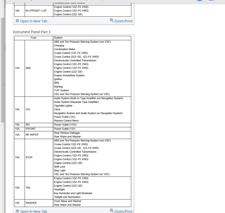

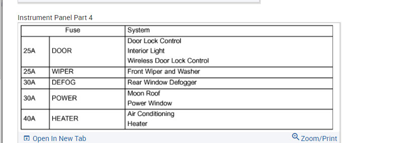

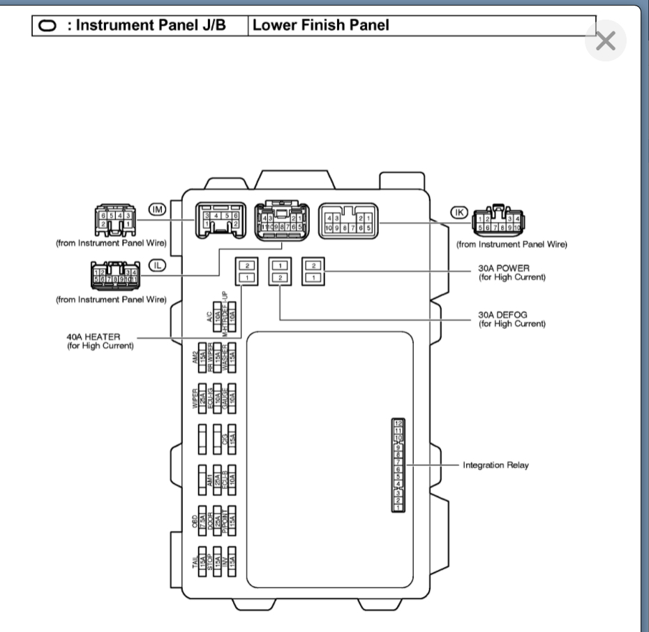

Heater wont work I need to check the fuses where are they and how do you test them?
Nov 16, 2016 at 10:40 PM
Here is a guide that will help with testing and replacing fuses as it gives step by step instructions:
Below is the info from the manual that will give the detail about these fuses.
Please run through this info and let me know what questions you have. Thanks
