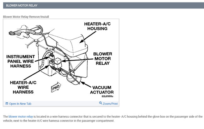

Heater, air conditioner and defrost is not blow out air on any setting. Changed fuse, no joy.
Where do I go next?

ive changed the resistor blower motor my climate controls checked each fuse i still have nothing 97 jeep tj

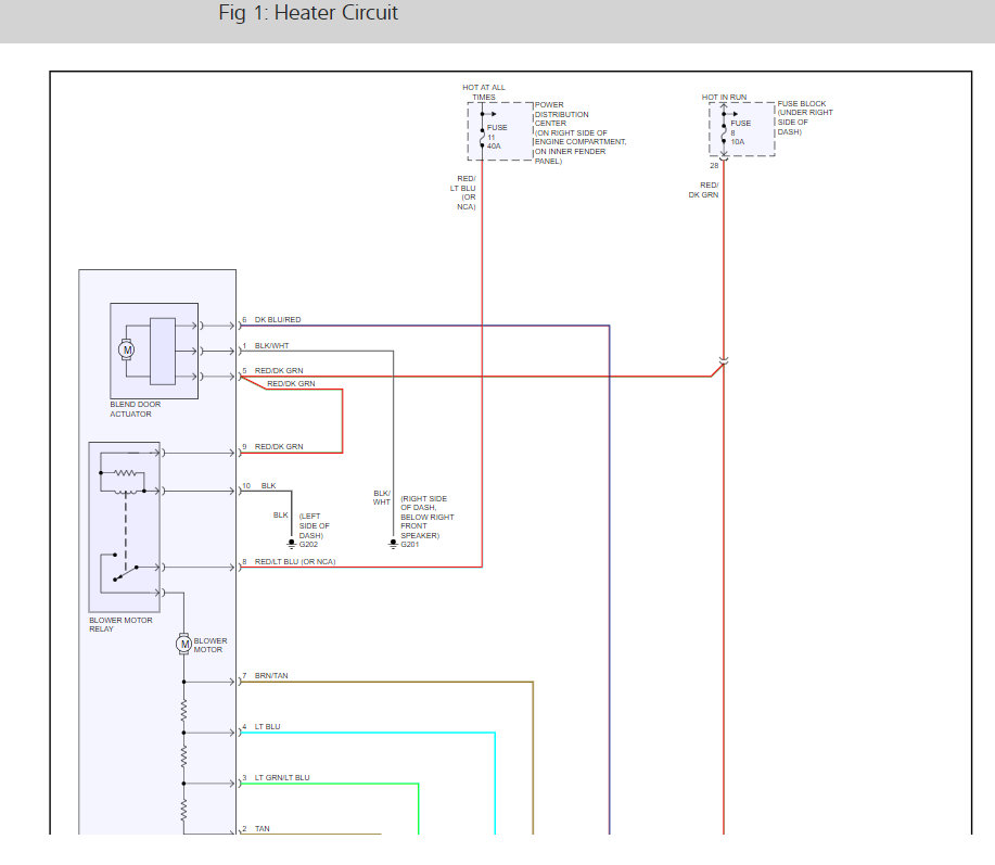

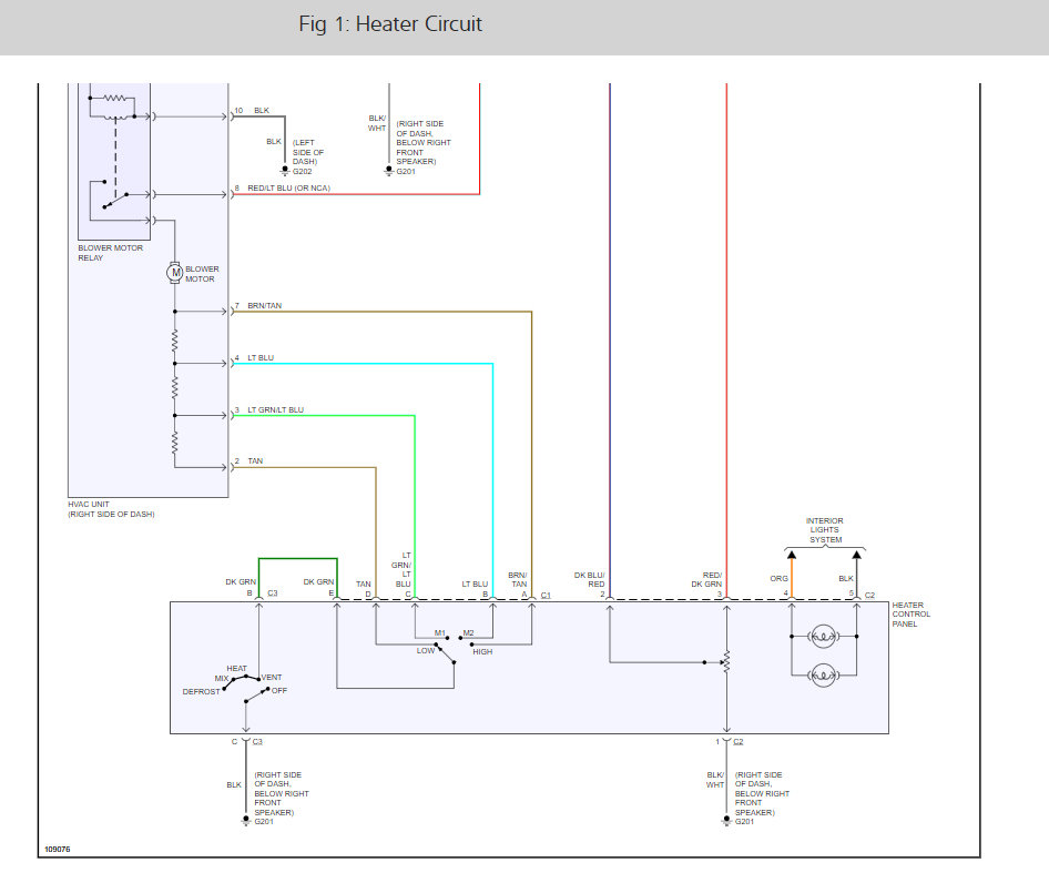

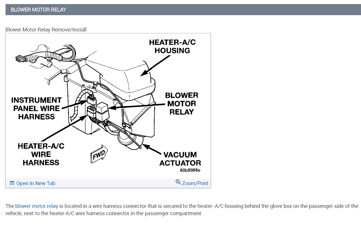

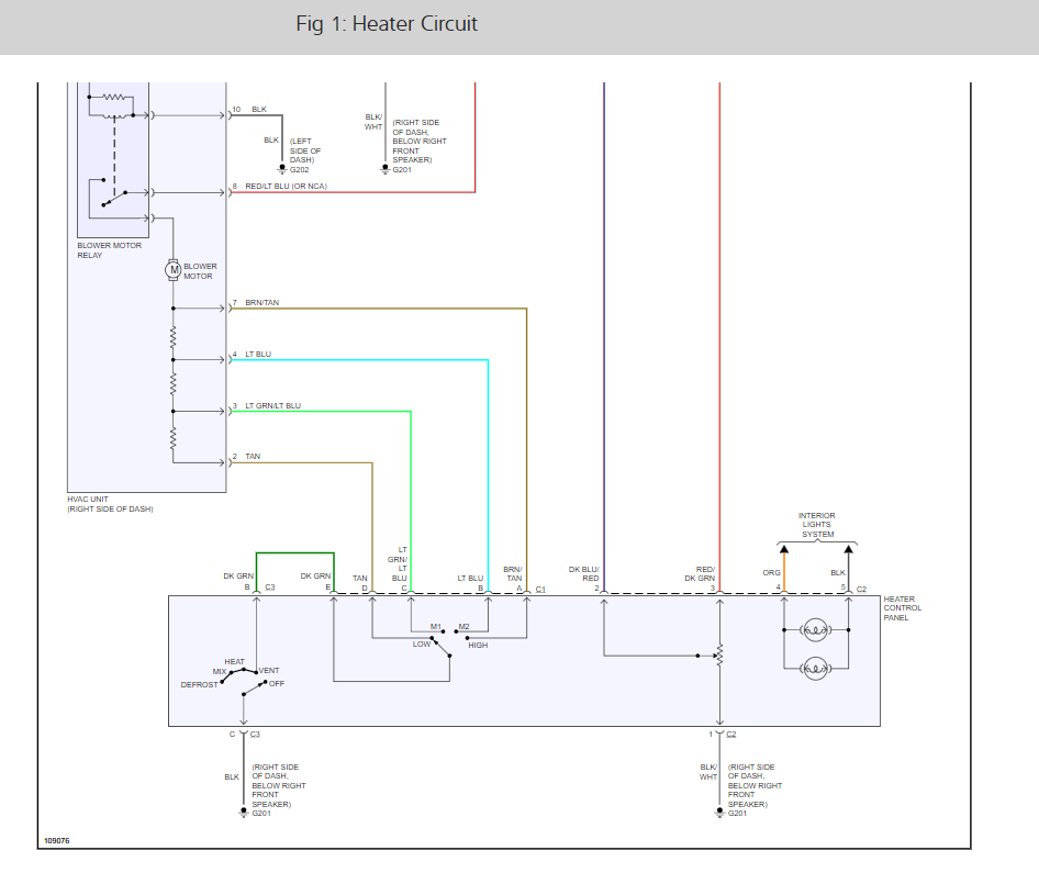

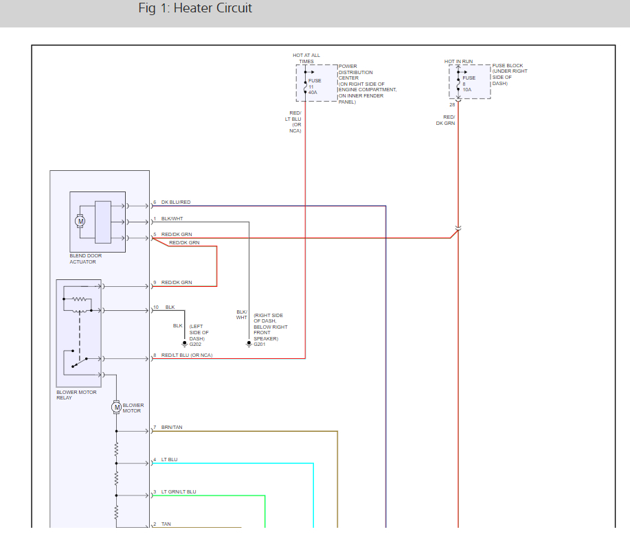

There is a blower motor relay that needs to be checked and check for power at the fuse and ground at the mother here is a guide to help you test the system and the blower motor wiring diagrams below so you can see how the system works.
https://www.2carpros.com/articles/blower-fan-motor-works-on-high-speed-only
and
Blower Motor Relay In wire harness connector, near right end of heater-A/C housing.
Check out the diagrams (Below). Please let us know what you find. We are interested to see what it is.
