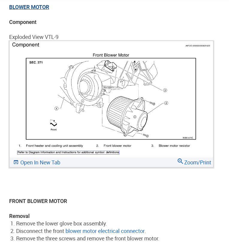

i need to remove the the heater blower motor as it is very noisy and works intermittent. i have removed the glove box and backing to reveal the bulkhead but not sure where the motor unit is located.

We have Xterra which is a little different. Here is what they show for the repair in the diagrams below. This guide will walk you through the repair with what to look for on our car below. Can you upload a video or picture in your reply? That would be great.
https://www.2carpros.com/articles/blower-fan-motor-works-on-high-speed-only
Check out the diagrams (below). Please let us know what you find.
