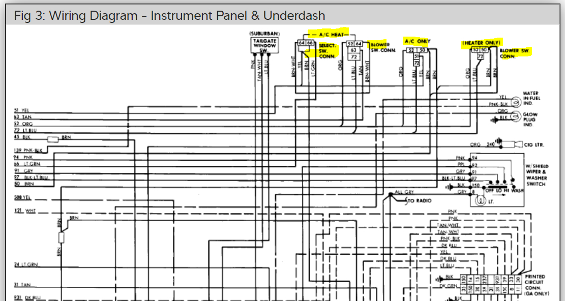

So, I have the vehicle listed above C10 deluxe. I bought a new heater switch panel but my wiring on the new panel doesn't match up with the OEM wiring so I was just wondering if I could get the wiring diagram for the heater switch panel, please and thank you

I suspect this is an 81 since you indicated that in the post. If it is a 91 (heading), let me know.
Because of the model year, 1981, my resources are very small. I found a schematic of the dash and instrument panel. The only thing I am seeing is related to the fan switch. I have a 1978 and other than a light, which is the only electric to the controller.
The page this came from was huge and extremely difficult to follow. I highlighted the areas that may help you. Let me know if it helps or if you have questions.
Take care and Happy Thanksgiving.
See pic below.

Yeah it's helpful kind of I just can't read the color the wires though, lol.

Never mind, I pulled it up on my computer, and I can see it just fine. Thank you very much. Happy holidays
