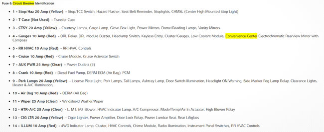

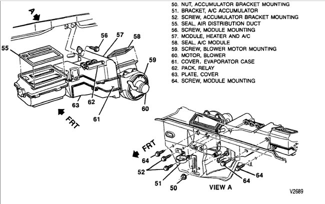

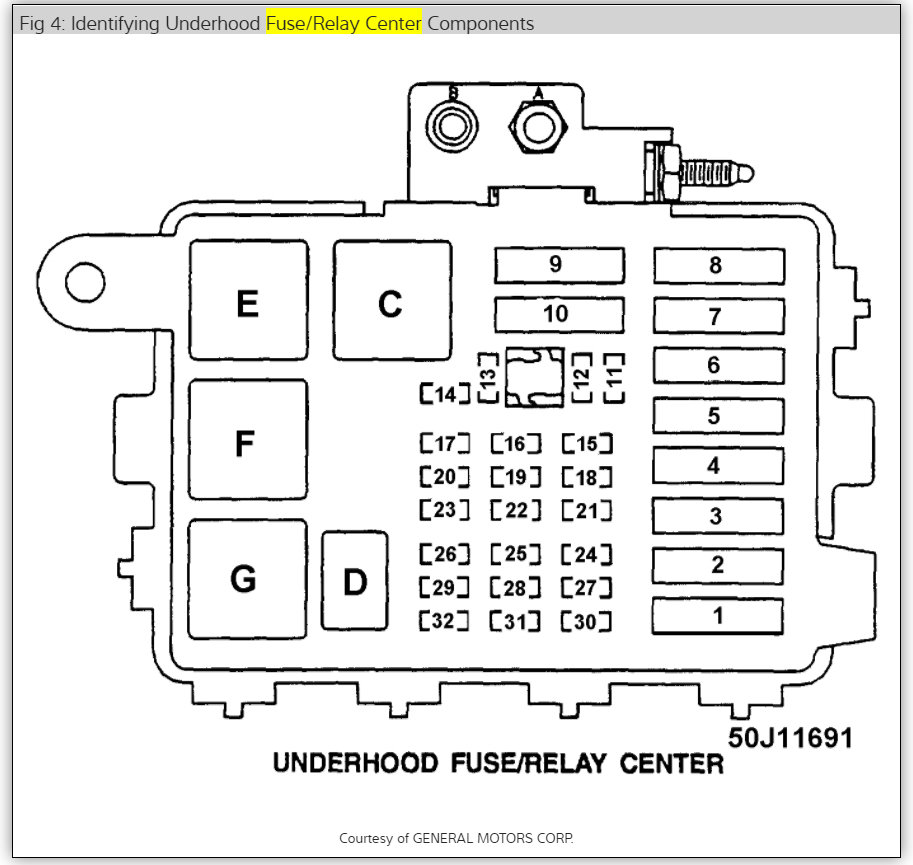

Air goes to the rear but not the front. Coolant is full and not leaking, some condensation (h20) around blower motor. could it be actuator, blower motor or heater core, thermostat? It almost seems as if I hear the actuator opening the front vent but no air whatsoever. Thank you! Any help is surely appreciated!

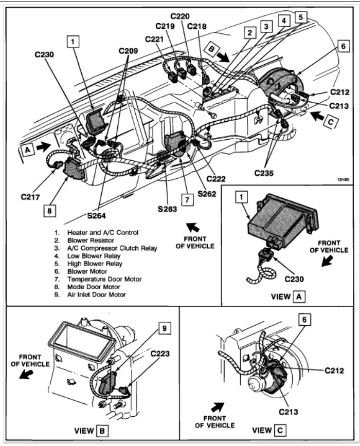

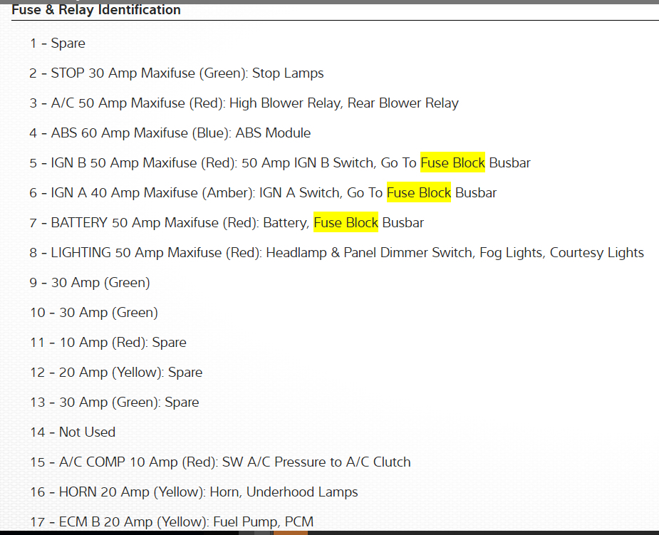

Hi, i believe you have front and rear heating/AC units the rear has its own blower motor and so does the front. If i am understanding your question you have no air or blower noise in the front. if this is right then very possibly a defected blower motor or possibly a bad circuit breaker, even possibly a bad blower motor resister.

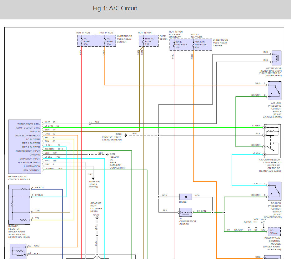

If you test the resistor (located next to blower motor) if you have power there when heater is on.Then go to orange wire on the blower motor check for twelve volts also check the ground at the motor.If you have twelve volts in those places then switch resistor relays and breaker are all fine so motor is bad.
I hope this helps. feel free to ask if you have more questions. Thanks, BM

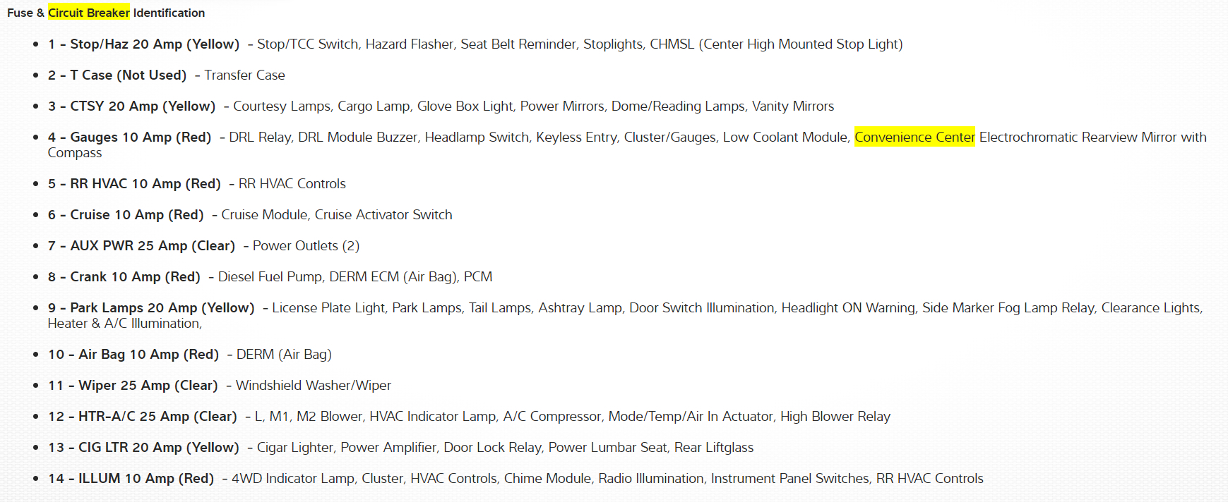

Are you talking the relay fuse?

When the heater is turned on with the fan speed on high can you hear the front blower motor working? I can send you any information you need such as wiring diagrams and such but I need to know if you can hear the blower motor working.

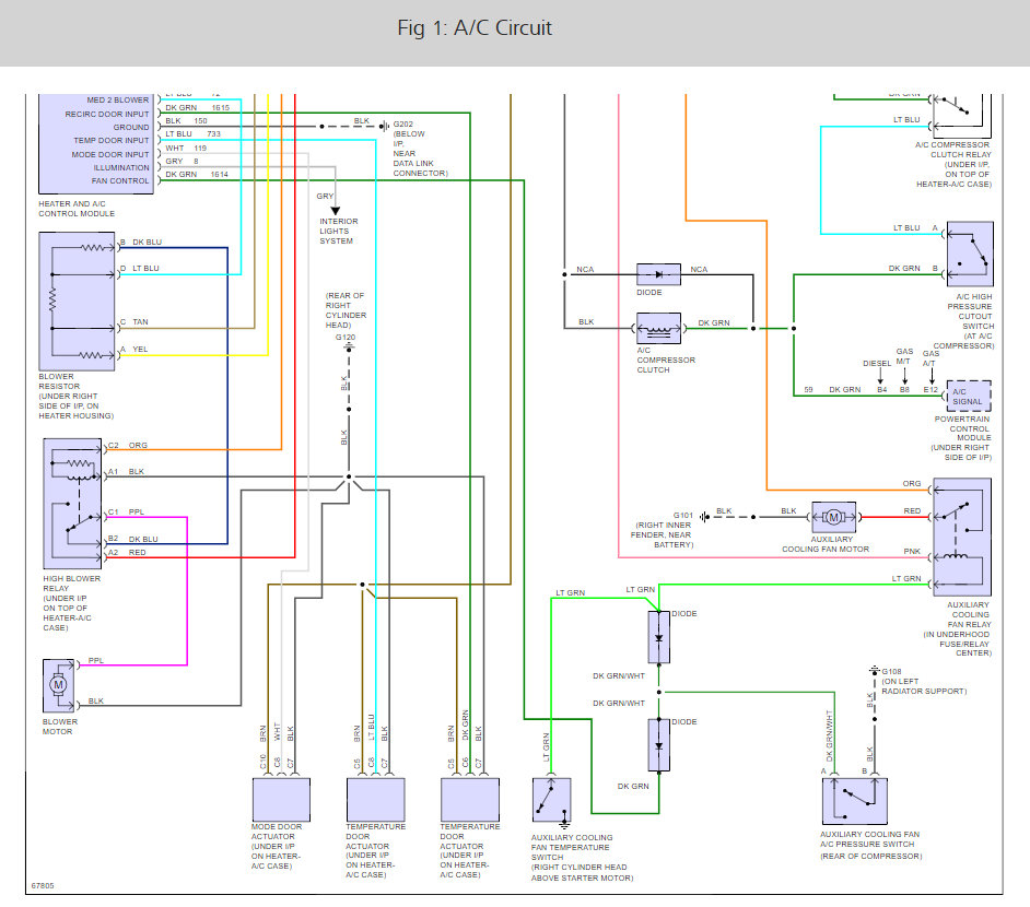

Perfect. It could be the blower motor or the power supply has had a problem. Here is a guide to test the blower motor and wiring which will give you an idea of what to do when changing the blower motor as well.
https://www.2carpros.com/articles/blower-fan-motor-works-on-high-speed-only
and

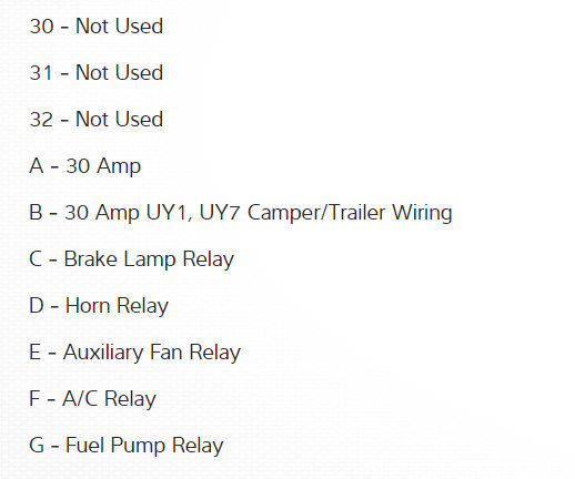

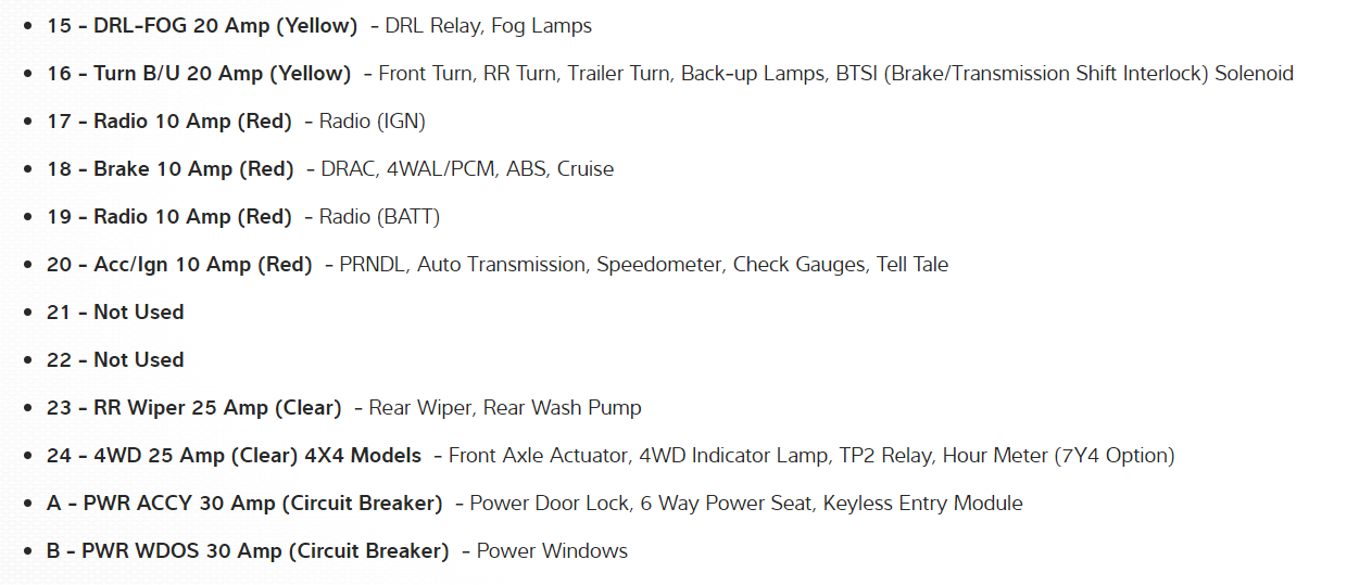

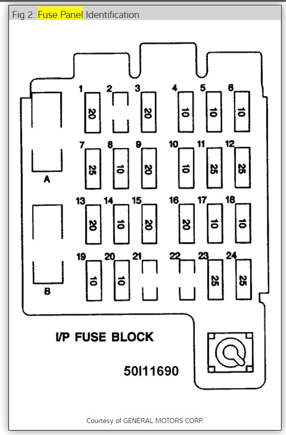

Here are the blower motor wiring diagrams to help trace the power source there is a control relay that can be bad as well
Check out the diagram (Below)
