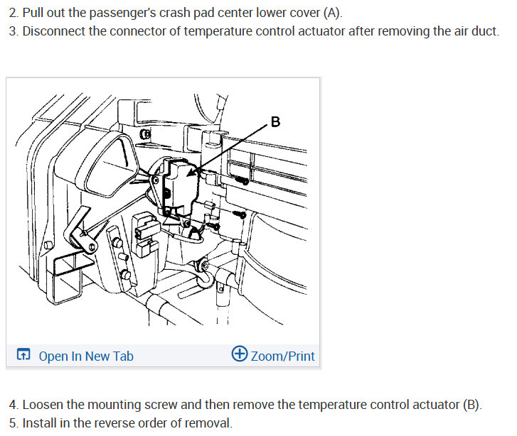

I need to know where the heat exchange actuator is located so I can return heat to my car listed above.

It looks like it is on the passenger's side, here is the location of the temperature blend door actuator.
Check out this video as well:
https://www.youtube.com/watch?v=SNRb6pSwYuU
Check out the images (below).
Image (Click to enlarge)
