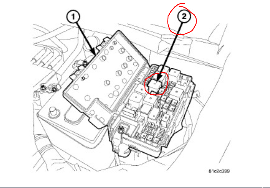

Hi Dan,
I need to get a clear idea of exactly what we are talking about. When you say actuators, are you referring to the air flow or temperature actuators? When you say defroster, it is the rear window defogger grid? If it is all related to the grid unit, have you checked the relay? (See picture 1).
Next, I need you to pay attention to the flashing. Is it a specific number of flashes each time? One last thing, do you have access to a scan tool that can read HVAC codes?

Thanks for your advise. Will the relay make this click like it does? I don't have access to a scan tool for HVAC. Yes, its the two actuators you mentioned that I changed. I haven't counted the flashes but it flashes quite a bit before the heater in the front comes on.
Jan 26, 2020 at 11:22 AM
  • 110,194 POSTS
If we had a scan tool, it would most likely indicate where the problem is coming from. Without it, we have to try different things.
The first thing is the relay I mentioned. Lets check that. If there is another relay with the same part number, switch them to see if it changes. If there isn't, here is a link explaining how to test a relay:
Here are a couple links you may find helpful:
The interesting thing is that it worked properly for a couple weeks. Does it eventually start working now?

I have to be honest, since you are hearing a clicking and it is stuck on heat, I suspect the actuator has failed again. They are so cheaply designed. Chances are the teeth on the actuator have stripped.
Let me know what you find.
