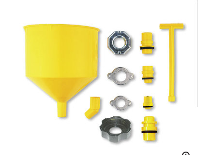

Just to add my 2 cents on this one. Normally when you have no heat after doing anything to the cooling system it is because you have an air pocket as mentioned prior in the heater core. The best way that I have found to get rid of an air pocket is to use the funnel that you will see attached. This will help eliminate air pockets and I would fill the radiator so that this funnel is a quarter of the way full and then when the thermostat opens, it will pull the coolant in funnel in rather then air. Then you will need to be ready to keep filling it so that it doesn't empty and this will prevent the system from pulling in air. Then you will want to just let the vehicle idle for about 15 minutes with the funnel about a quarter of the way filled and you will see the air pockets working out through the funnel.
Let us know if you still have questions. Thanks

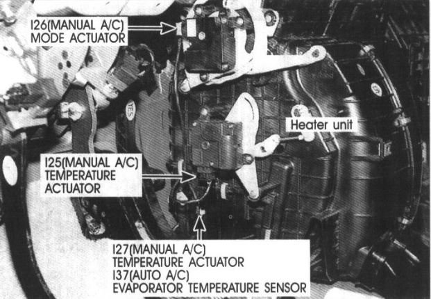

Fan works cold air coming through vents. Air blow to floor and vents correctly by selection.
Feb 12, 2021 at 3:14 AM (Merged)
  • 110,251 POSTS
Hi and thanks for using 2carpros.com
Only a few things can cause no heat, low coolant, a plugged heater core, damaged blend air door actuator, or heater control valve. First, take a look through this link. It describes the most common causes for no heat.
Let me know if the link helps or if you have other questions. I attached a picture of the actuator I mentioned. It is responsible for allowing heat or AC into the vehicle. It is located under the dash on the HVAC unit. See pic.
In all honesty, if the coolant is full, and both heater core hoses are hot, this is my first suspect.
