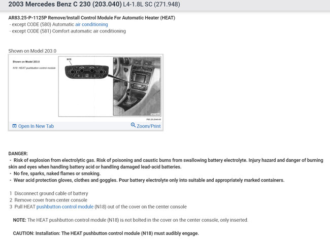

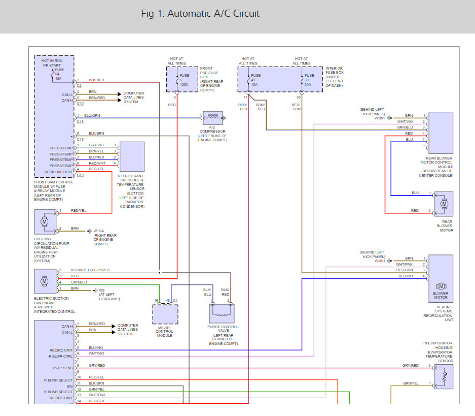

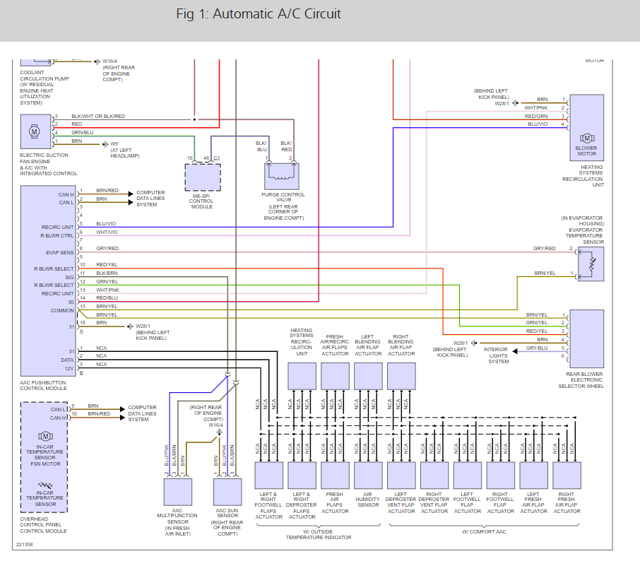

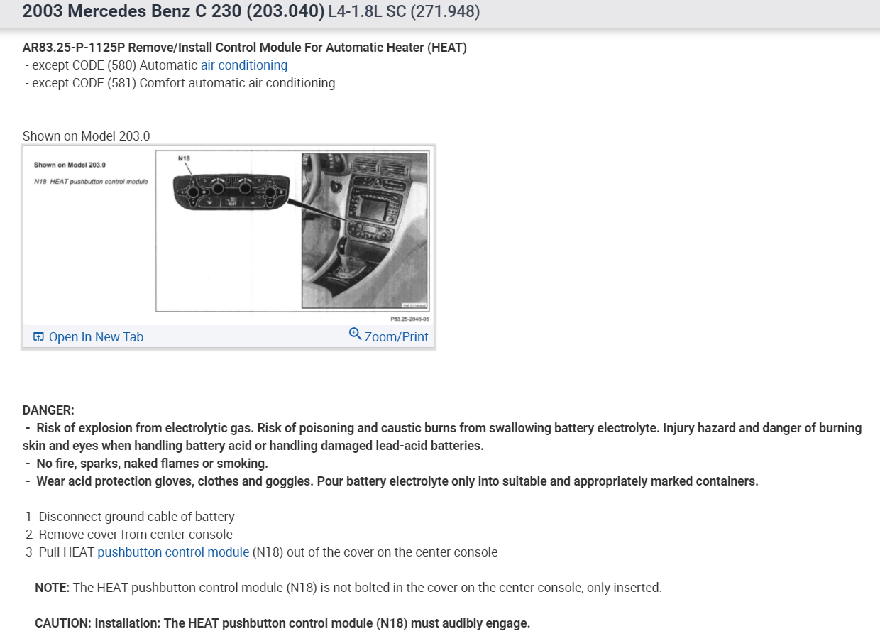

There are 14 actuators for this car can you confirm they are all working? If so I would replace the control module. Can you confirm you have power at the four fuses that run the system? Here are the wiring diagrams so you can see which fuses you should check and letting you know how the system works. Check the connection using this guide if everything is okay replace the module

Mr.Ken, thanks your reply.Please if you can direct me the relays that I should check. for the diagrams you sent me are too deep for my understanding .But definitely I will change the control module and the blower motor resistor as directed .

There are no relays just actuators and control modules. take another look at the wiring diagrams and follow the wires to see how the system works. Please let me know.
