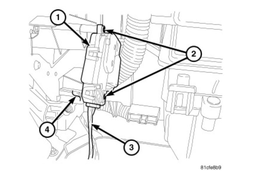

I had a heater control box repair to fix the passenger side blowing cold air. It worked for a bit then it is doing the same thing. Mechanic said that the electrical plug from the car to the heater is broken. Trying to find a replacement. Not a dealer part. Any suggestions about how to replace?

Do you mean the connector on the actuator motor? I attached a picture to view if you could help me.
If it is, there is no pigtail available from anywhere. it can only be acquired with the entire harness.
The only other way is to go to a junk yard and cut one off of another car. then you can solder and shrink wrap the wires together.
