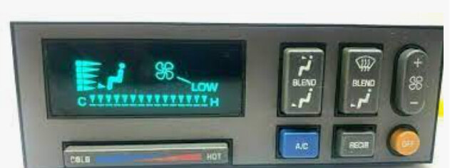

Instead of one indicator arrow, it flashes all arrows. The blower motor works fine. 1 year old thermostat, radiator and reserve full. Not sure if the problem is in the heat) air control module (OEM board) or one of my three actuators?
And how can I tell where and which is the problem?

Are you able to control any of the functions? Also, the controller head had issues years ago. I remember a service bulletin where it would lock up causing the actuators to continue getting power and start clicking. The only fix was to replace the controller head.
Let me know if you have any control and exactly what is happening in addition to the lights flashing. Also, 16149268 is the original equipment part number. See pic 1 below for confirmation.
See pic below.

Thank you, Joe. I do not hear any clicking in the actuators. Cannot control anything on the operating heat/air display panel.
By controller head, do you mean the OEM board/module?

It's the control unit I attached a pic of above. If you can't control the temperature or the airflow direction, that is what it sounds like has failed. Also, I found a newer part number,16143956.

Got it working. It was the module board. My son, a Spartan school graduate and good with this type of stuff, cleaned and re-soldered a bunch of suspect areas. Blowing hot, just in time for winter.
