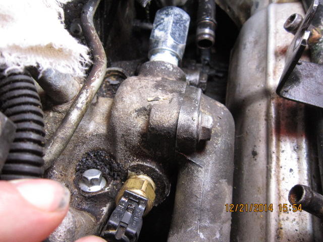

I am having a bit of a problem getting the pipe connected to the fitting, I have broke two of the retaining clips, most likely because of improper connecting procedure, does one leave the clip in the fitting or put it on the heater pipe first.

I can't picture where they would use a snap lock fitting on that car but if they did, it will work either way but it's probably easier to put it oin the pipe first.

It is on the Heater Hose connector to the engine thermostat housing.

The water outlet/thermostat housing has no pipes attached to it on this engine. https://www.2carpros.com/images/external/42242922.gif

The thermostat is on the back side of the engine, Drivers side , on this model, it is a 3100 engine

OK, it's not worth arguing about, but the connector that connects the heater inlet pipe (it is indeed a quick lock connector) to the engine screws into the thermostat housing, (I put a new thermostat in it, and it was a struggle at the time, did not have the GM thermostat wrench) , and the top radiator hose is connected to that housing. Thanks for all the Input.

They Say, A picture is worth a thousand words.
Dec 21, 2014 at 5:56 AM
RAILROADERTWO
  • 42 POSTS
Guess the pic didn't meet the guidelines.
Dec 21, 2014 at 5:59 AM
RAILROADERTWO
  • 42 POSTS
Trying again.
Dec 21, 2014 at 6:08 AM
WRENCHTECH
  • 20,761 POSTS
Yes, that is going into the intake manifold, not the thermostat housing. You may have torn or dislodged the seals inside. There is an O-ring, a plastic washer and the round base of the locking clip. You can buy a new one for under $10 if that one is damaged in any way. The pipe just pushes in and locks.
