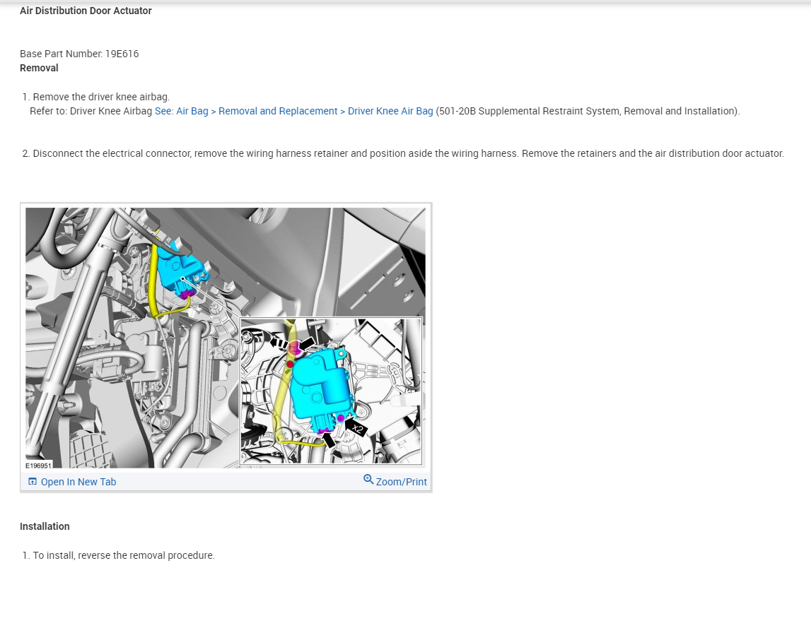

Heater working but only blows out front vents. No heat to feet and window.

Good morning,
There is a mode door actuator that controls the air distribution. It is the most common failure for this issue.
I attached the procedure below for you to view.
Let me know if you have any other questions.
Image (Click to make bigger)
