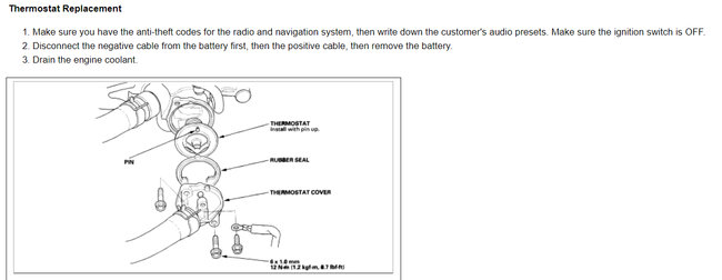

I have the car listed above it is the EXL model. I recently replaced my radiator and the problem started shortly after. I recently got check engine light and it showed code p0128 for coolant thermostat.
My car has issues with heating. The heater works but noticed it takes a lot of time to heat and I can feel warm air intermittently and it starts and stops blowing warm air and then blows cool air.
I also noticed that at times i would notice one of the heater fan running a minute or so after I turn off engine. It does it even if I drive short distance and in cold weather. I know my coolant is not leaking.
Mar 17, 2018 at 5:42 AM
  • 55,433 POSTS

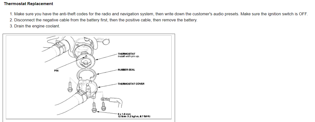

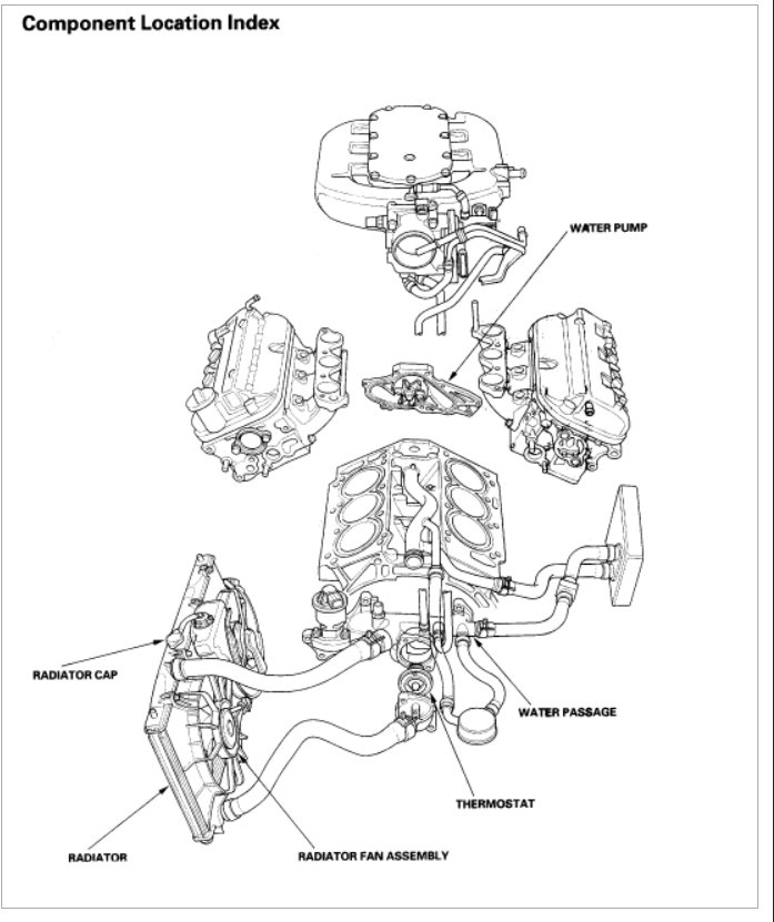

I think the code is telling us the thermostat is stuck open which will cause the code and the heater not to work. Here is a guide to show you what you are in for when changing the thermostat out. I would replace the thermostat and clear the codes.
Here is how it is done on your car (below)
