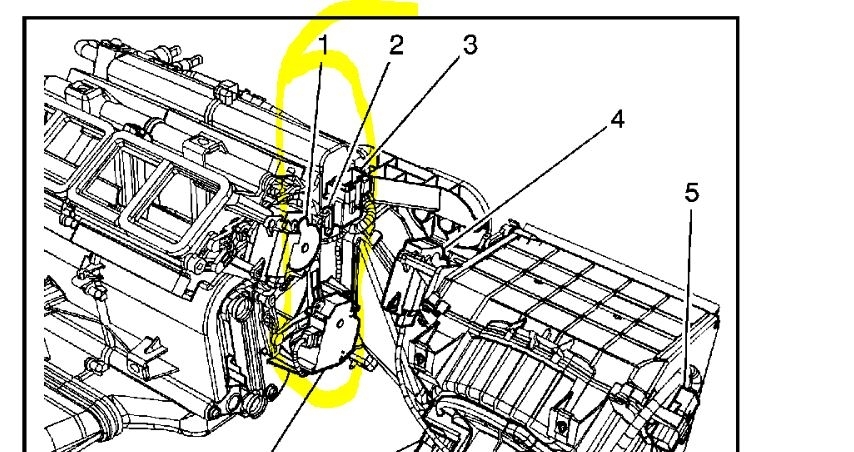

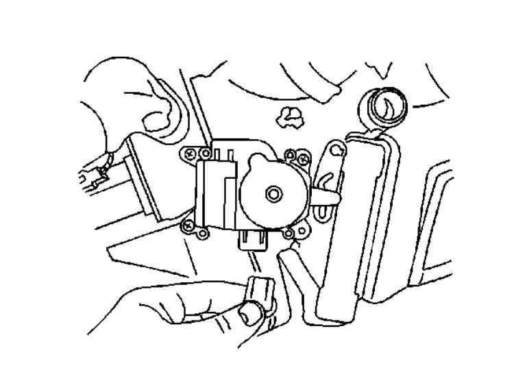

In fact I have two problems with my heater system related to actuators.
- First the air is warm on passenger side while it's cool on my side (the driver one).
- Second problem is with the air flow distribution; in fact when setting the system to the defrost mode, the air still blowing from the center and both sides console without being concentrated only on the front windshield.
So can you help me please locating both actuators responsible of these two issues in my heater system?
Regards and thanks.
Jan 30, 2019 at 3:12 AM

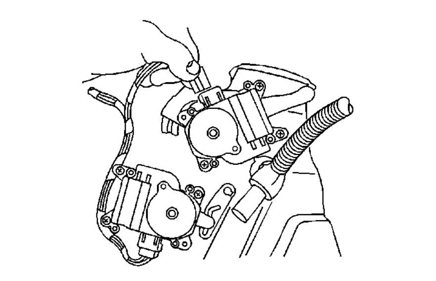

Good morning,
The left side blend door actuator is on the left side of the heater case and is easy replacement.
I attached a picture and procedure.

1. Remove the left closeout panel.
2. Disconnect the left air temperature actuator electrical connector from the actuator.
3. Remove the left air temperature actuator screws.

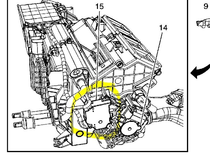

The mode actuator is another story. The dash board has to be removed to gain access to that one. This is a labor intensive job.

MODE ACTUATOR REPLACEMENT
REMOVAL PROCEDURE
1. Remove the instrument panel (I/P) carrier.
2. Disconnect the mode actuator electrical connector.
3. Remove the mode actuator screws (3).

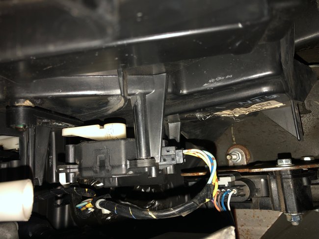

Is it the first one over the gas pedal as shown in the attached photos? or the upper one?
Jan 30, 2019 at 5:06 AM
It is the first one by the fuel pedal. yes.
