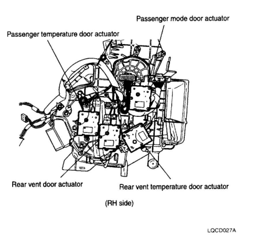

heater not working on passenger side
2005 KIA AMANTI
104,556 MILES
ARACA
i have a 2005 kia amanti and the passenger side heater does not work...it blows out cool air.i have a 2005 kia amanti and the passenger side heater does not work...it blows out cool air.i have a 2005 kia amanti and the passenger side heater does not work...it blows out cool air.i have a 2005 kia amanti and the passenger side heater does not work...it blows out cool air.i have a 2005 kia amanti and the passenger side heater does not work...it blows out cool air.i have a 2005 kia amanti and the passenger side heater does not work...it blows out cool air

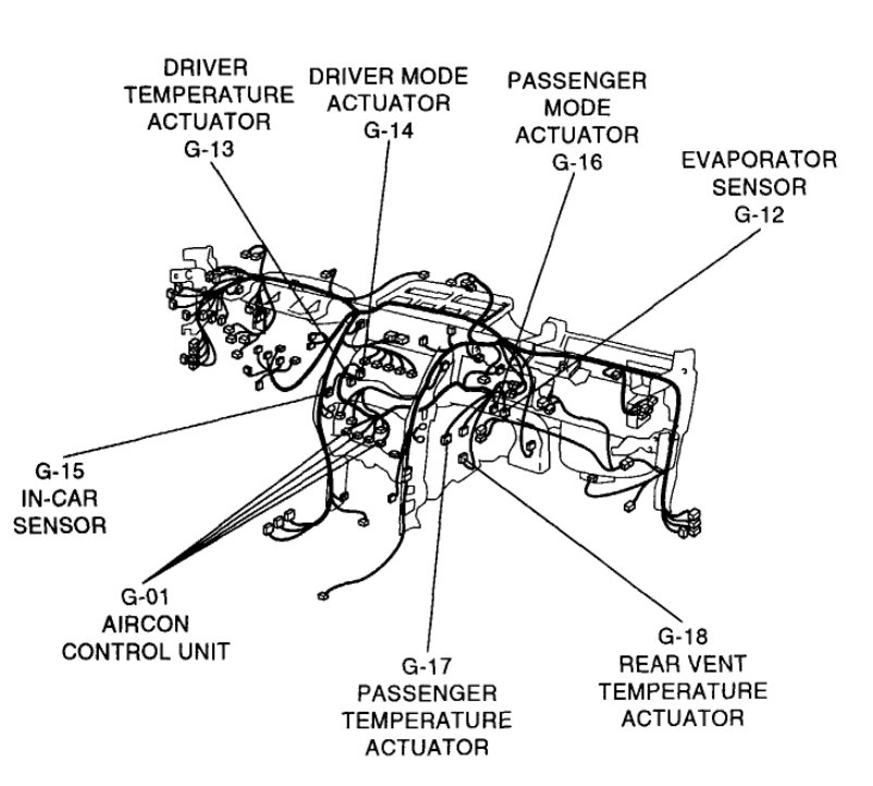

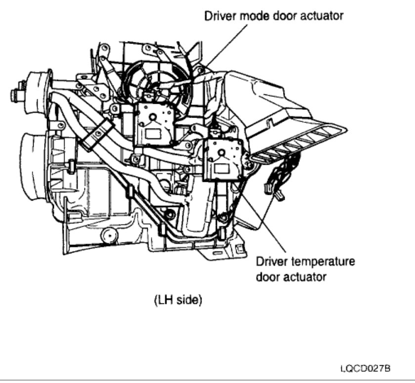

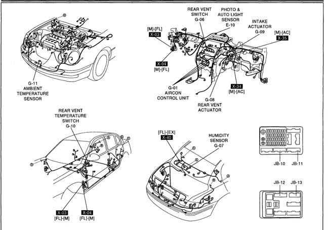

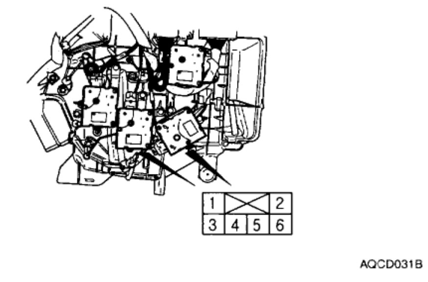

If you are getting heat from the driver's side, then you must have a blend air door actuator that is out for the passengers side. Here is a guide that will show you what you are in for when doing the job.
Here is what it will be like for your car I have included both drivers and passengers side actuators. (below)

Yep that did the trick, I replaced the passenger's side temperature blend door and the problem is fixed! thanks 2Carpros :)
