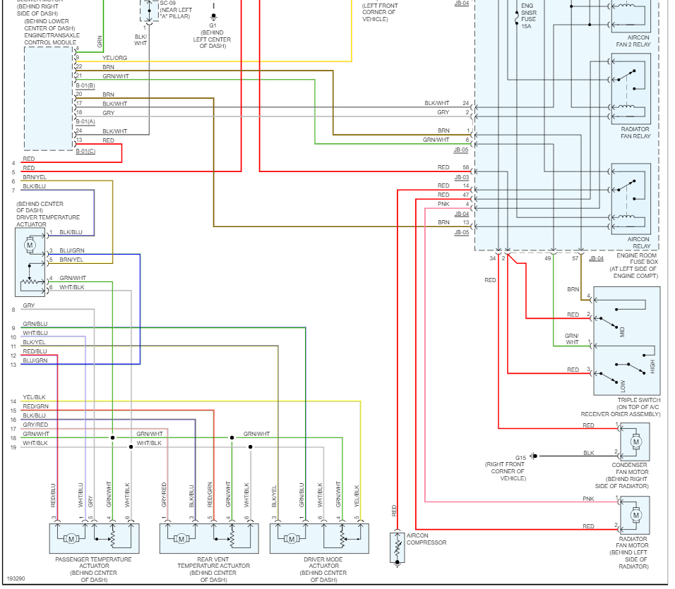

Heater not working on the driver's side?
180,000 MILES • 3.5L • V6 • 2WD • AUTOMATIC
KMSUGGS

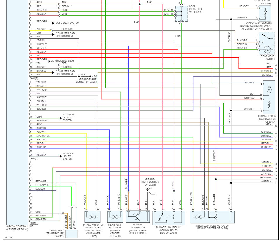

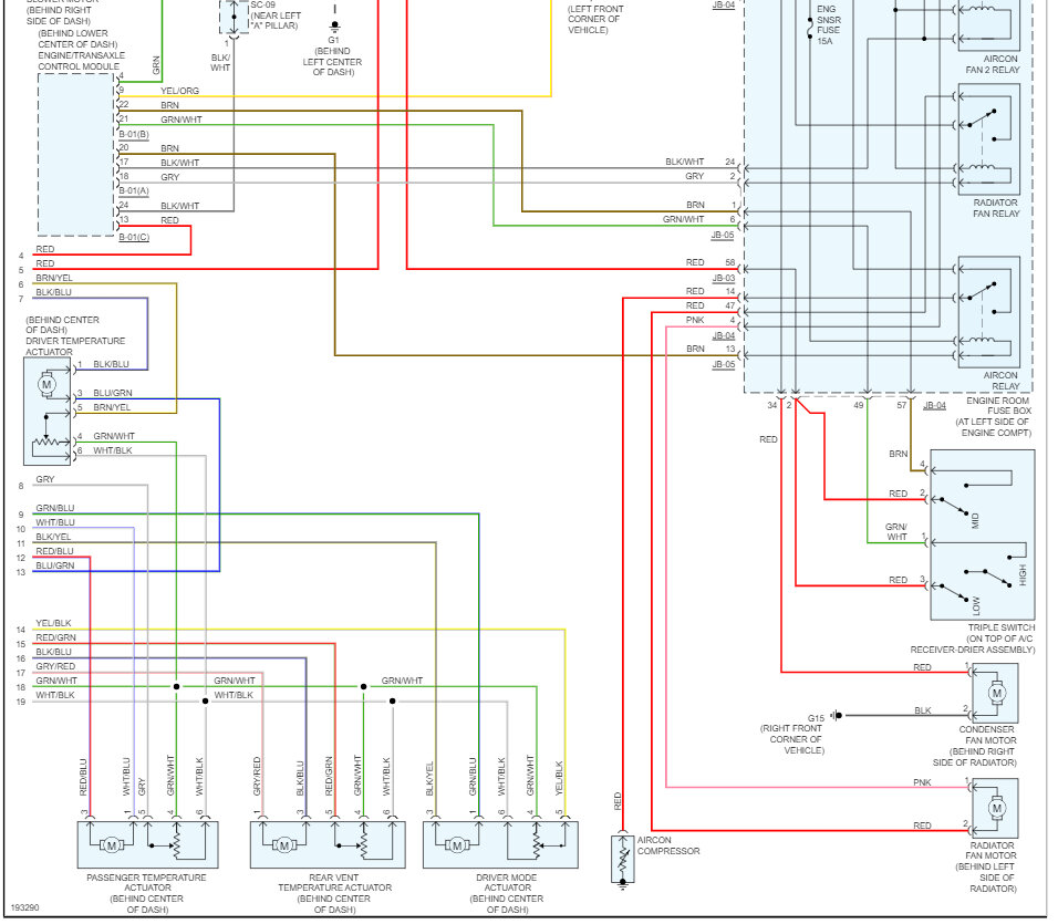

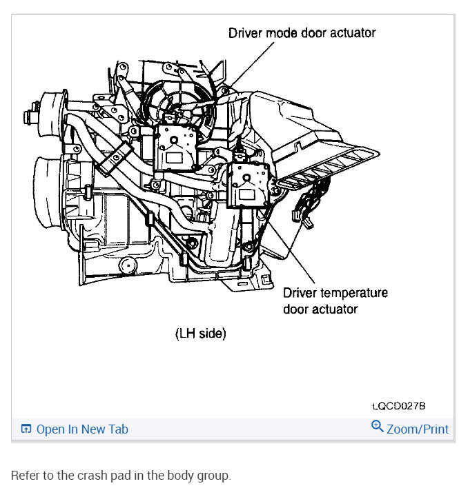

The driver's side will not blow out hot air. The passenger side works fine. How do I check the actuator on the driver's side?
Nov 5, 2023 at 1:44 AM
  • 55,691 POSTS

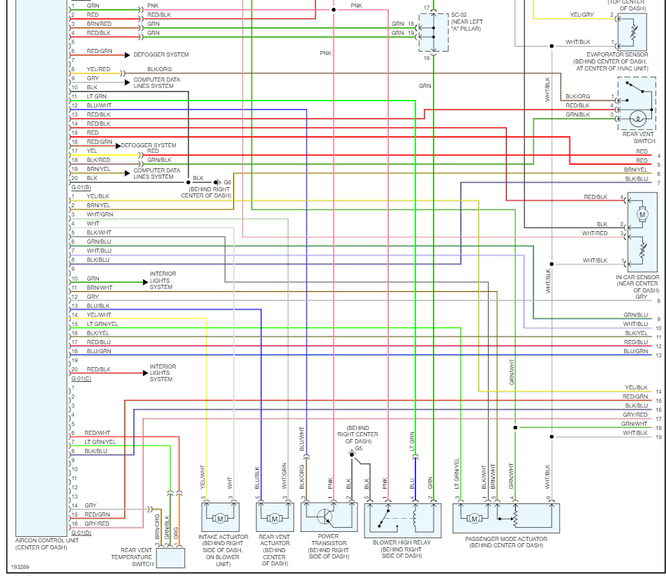

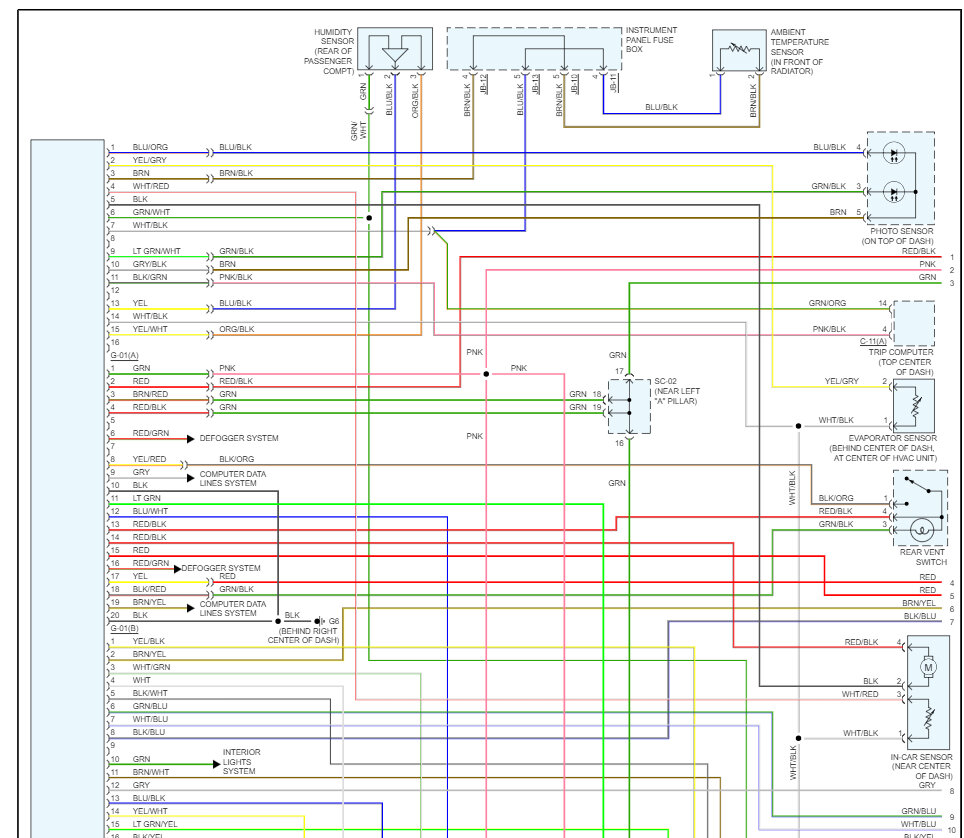

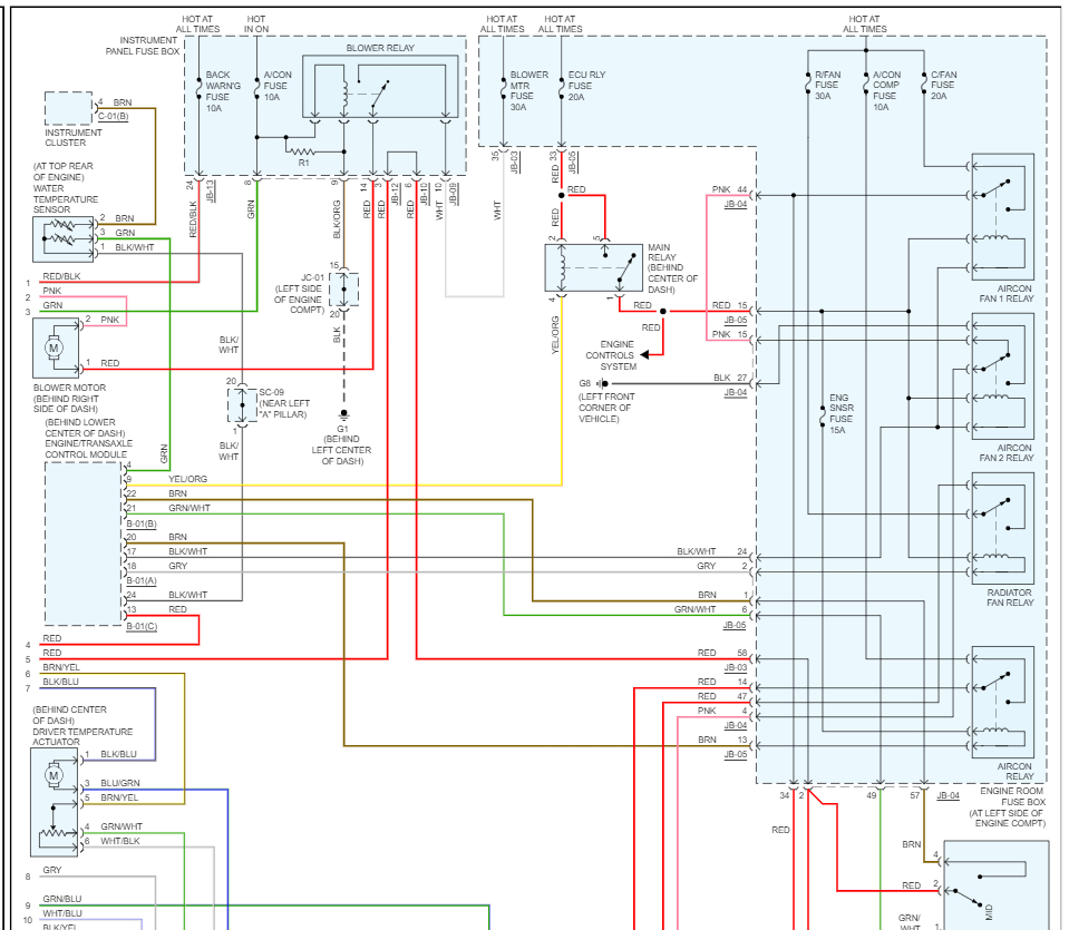

9 times out of 10 the problem will be the driver's side temperature blend door actuator, here is the location so you can change it out. But here are the actuator wiring diagrams so you can check for power and ground for the motor inside the actuator.
Check out the images (below). Please let us know if you need anything else to get the problem fixed.
