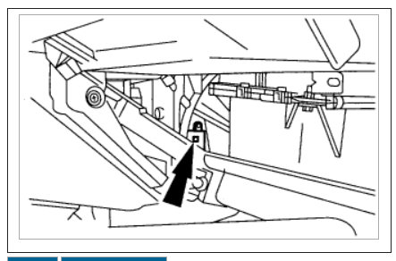

Heater not working
1998 FORD FALCON
300 MILES
SHABEER
All pipes and connections fine.
A/C working one hundred percent. No heater any reason why?
Jun 22, 2018 at 7:35 AM
  • 54,832 POSTS

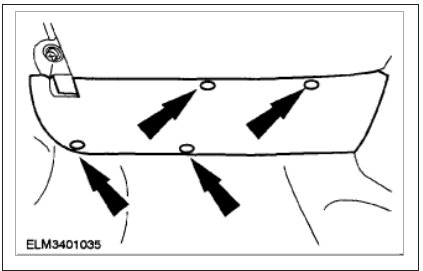

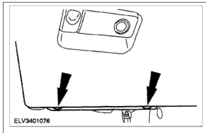

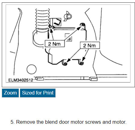

It sounds like you have a temperature blend door actuator that it not working right. Here are two guides that should help us fix the problem and the blend door location for your car below:
and
Here is the blend door location for your car. Check out the diagrams (below). Let us know what happens and please upload pictures or videos of the problem.
Jun 23, 2018 at 1:42 PM
