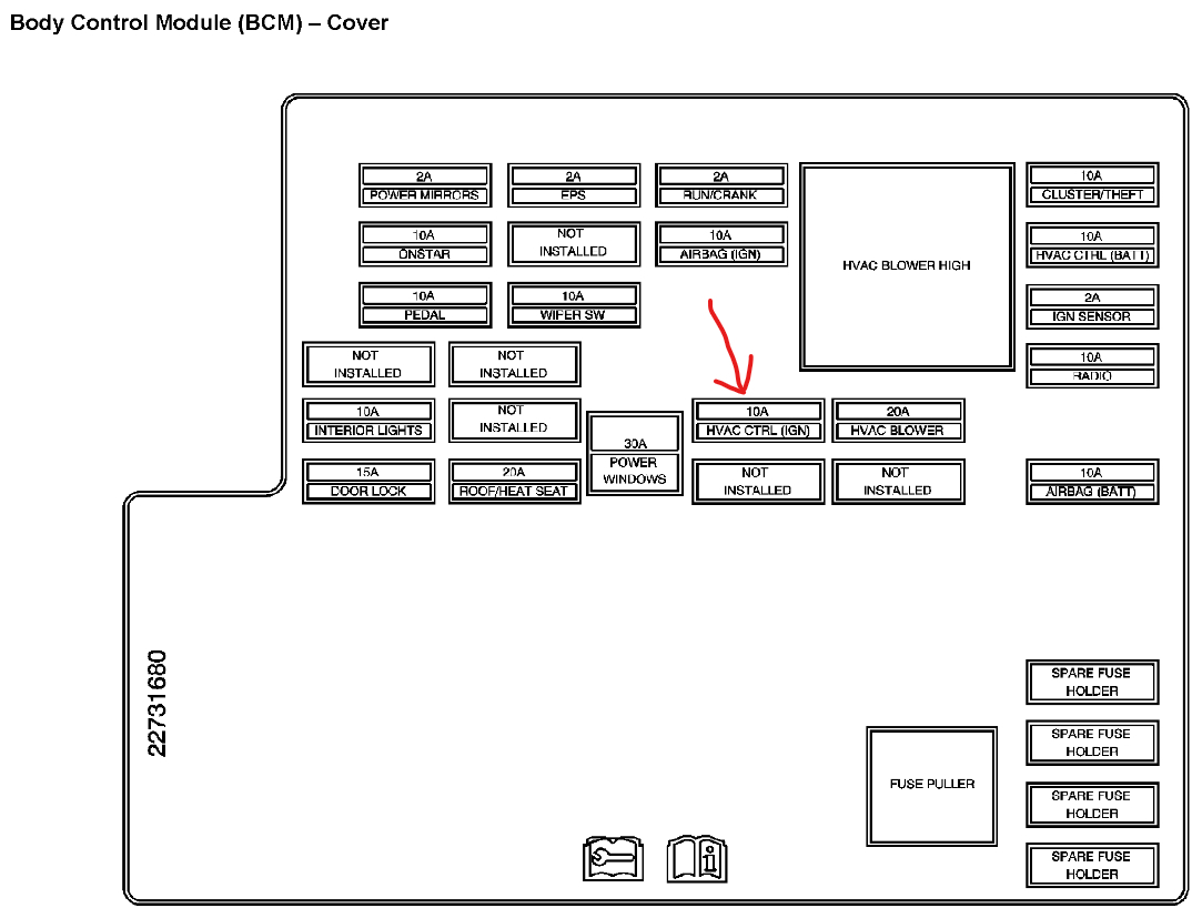

When I turn the heat on, the fan turns on, however I cannot turn from face vents to floor and windshield. There’s also no light lit when you push the A/C button or when you change the outside/recirculated air setting. Please help.
Nov 27, 2023 at 11:39 PM
  • 55,402 POSTS
We need to check the HVAC control fuse which is not the BCM fuse panel under the right side of the center console near the dash, here is a guide that will help, and I have included the fuse location in the images below, these guides may help as well:
Check out the images (below). Let us know how it goes.
