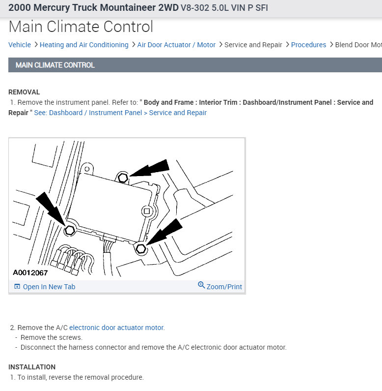

The heater blows cold air and code flash 024.
Apr 14, 2022 at 7:36 PM
SQM
  • 6,383 POSTS
The heater can blow cold air for a few reasons.
First of all, it can be simply due to being low on coolant. One of the common causes is a faulty blend door actuator. The actuator can fail in the cold position and that will make the heater not work or blow hot air.
It can also be due to a stuck open thermostat, which will prevent the engine from reaching operating temperature and that will lead to cool air out of the vent instead of heat.
Here is a helpful guide that covers the typical issues:
