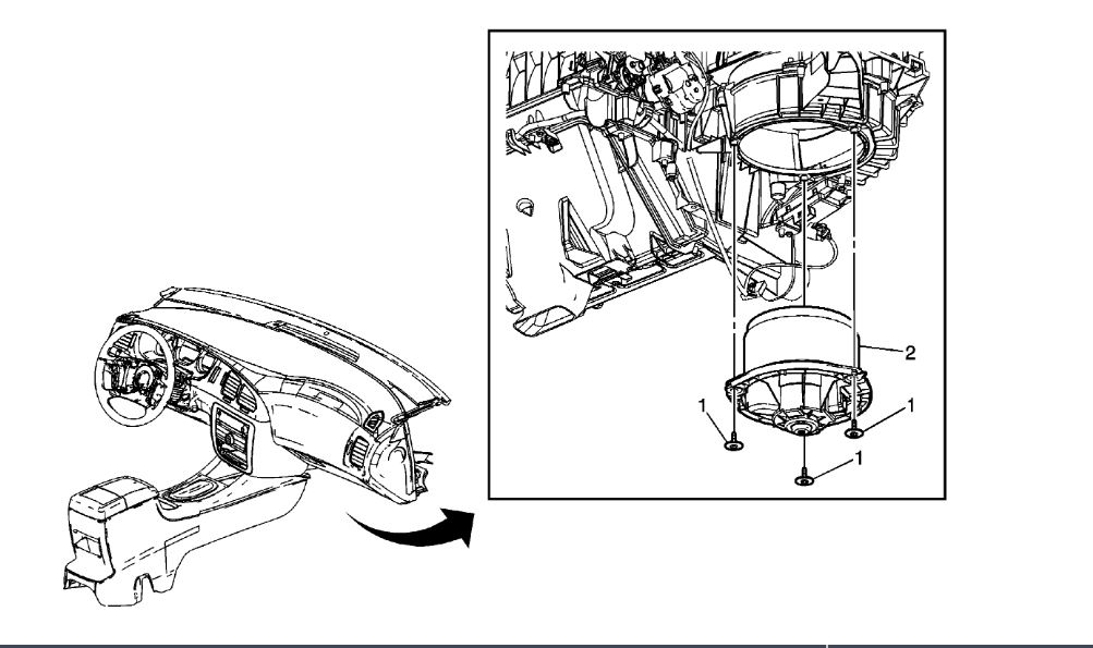

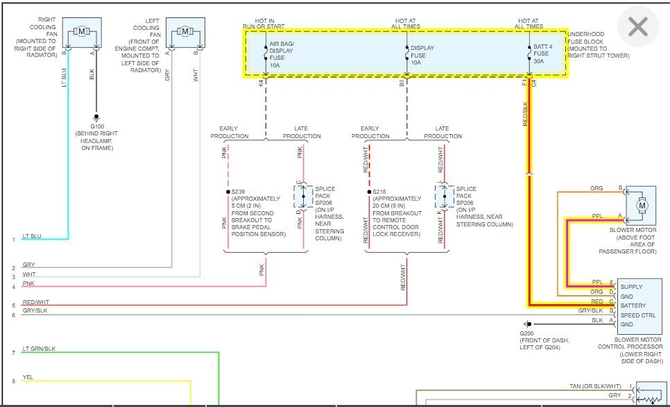

Heater is not producing heat at all. No power is getting to the blower motor.
Nov 10, 2019 at 5:40 AM
Good afternoon,
I attached a wiring diagram for you to view. I highlighted the wire that is power to the blower resistor that feeds the blower motor. Verify power on both sides of the fuse with a test light or voltmeter. This is not a visual test, it is a voltage test.
The blower motor location is attached and the resistor is right next to the motor.
Nov 10, 2019 at 6:58 AM

Have tried this and there is not any power coming in to the blower motor through the wiring.
Nov 10, 2019 at 11:53 PM
Did you check the red wire at the blower resistor? That is where the power starts and goes to the blower motor.
