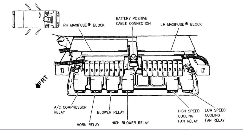

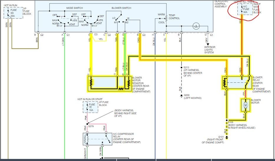

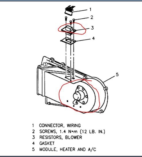

This could be the blower motor or the resistor. You need to test for voltage to the blower motor when commanded to the on position. Check at the connector for voltage.
I attached pictures of the location of the components for you as well.

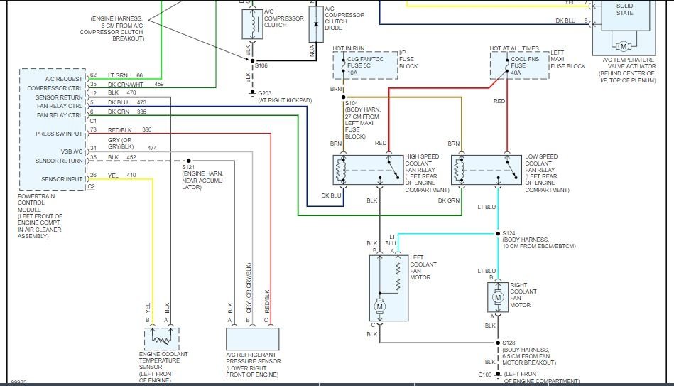

I attached a wiring diagram for you to view. You will need a test light or voltmeter to do some testing.
