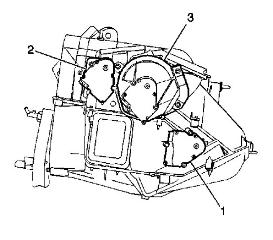

Heat blows only on driver side, blows cold on passenger side and back also, I think it is the blend door actuator. It also blows a lot harder on the passenger side too. A/C works good on both sides but still blows harder on passenger side.
Oct 28, 2017 at 3:06 PM
  • 55,224 POSTS

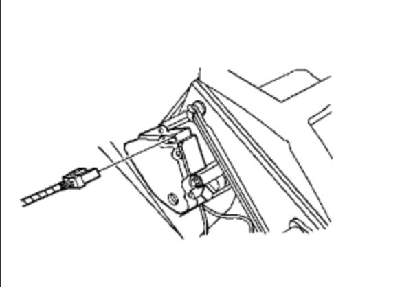

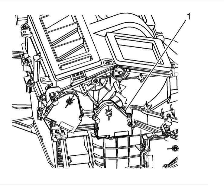

You are right! it is the blend door actuator for the passengers side which is the easier of the two to change.

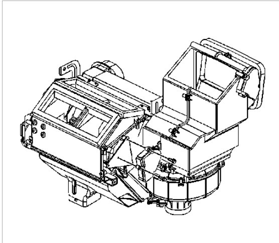

Here is a guide to help you see what you are in for when doing the job.
Here is what it will be like on your car which is a little different the right side is the first image and the left side is the next. Then I uploaded the defrost and mode actuators in case anyone else needs them (below).
