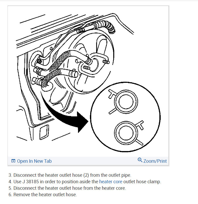

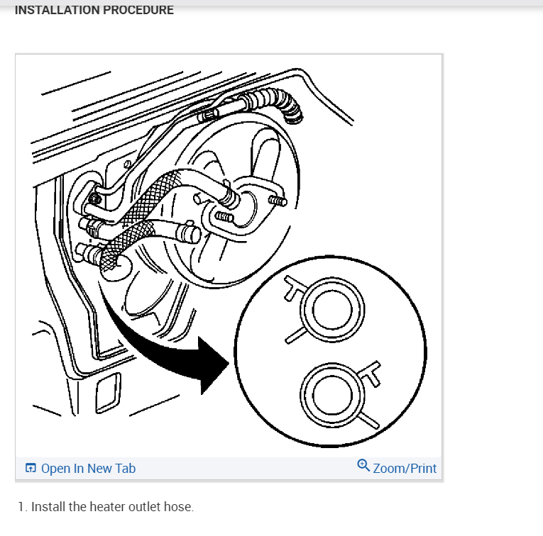

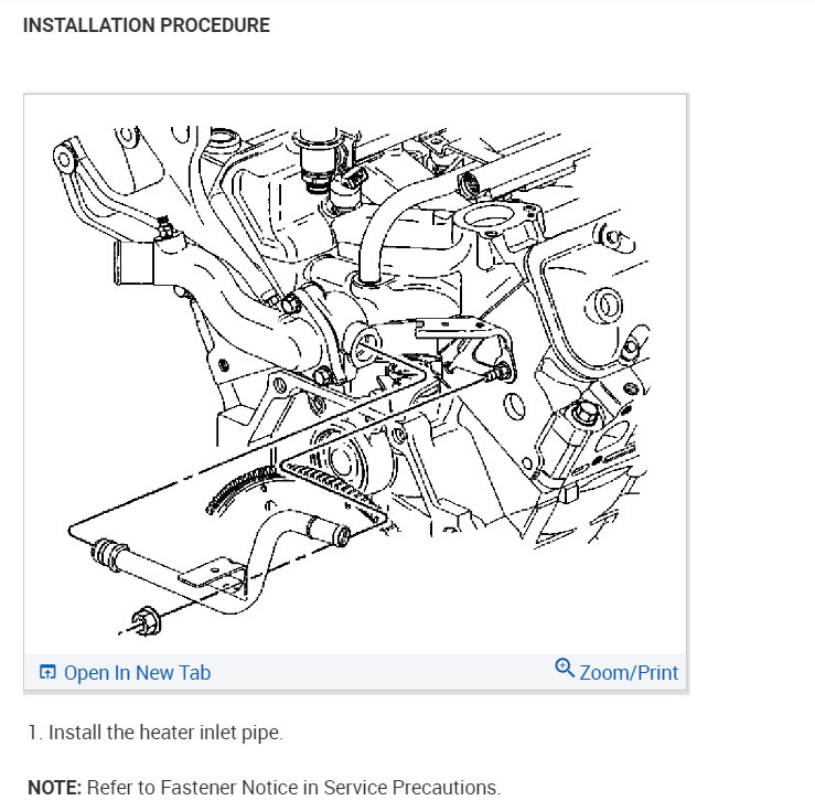

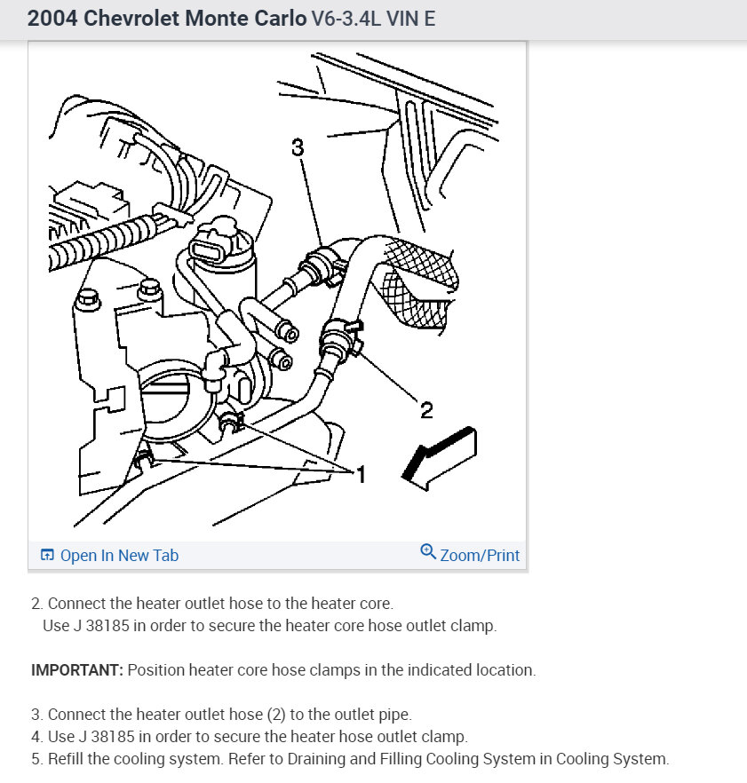

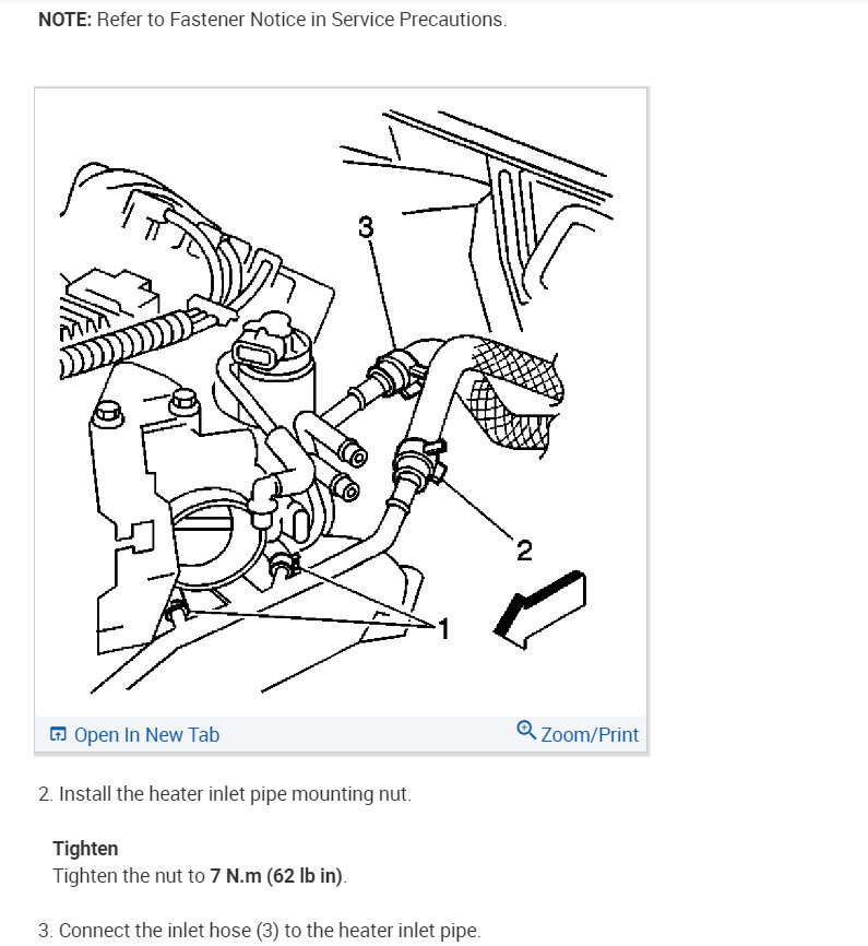

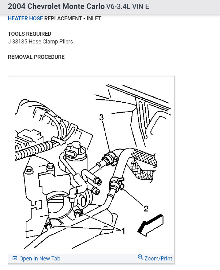

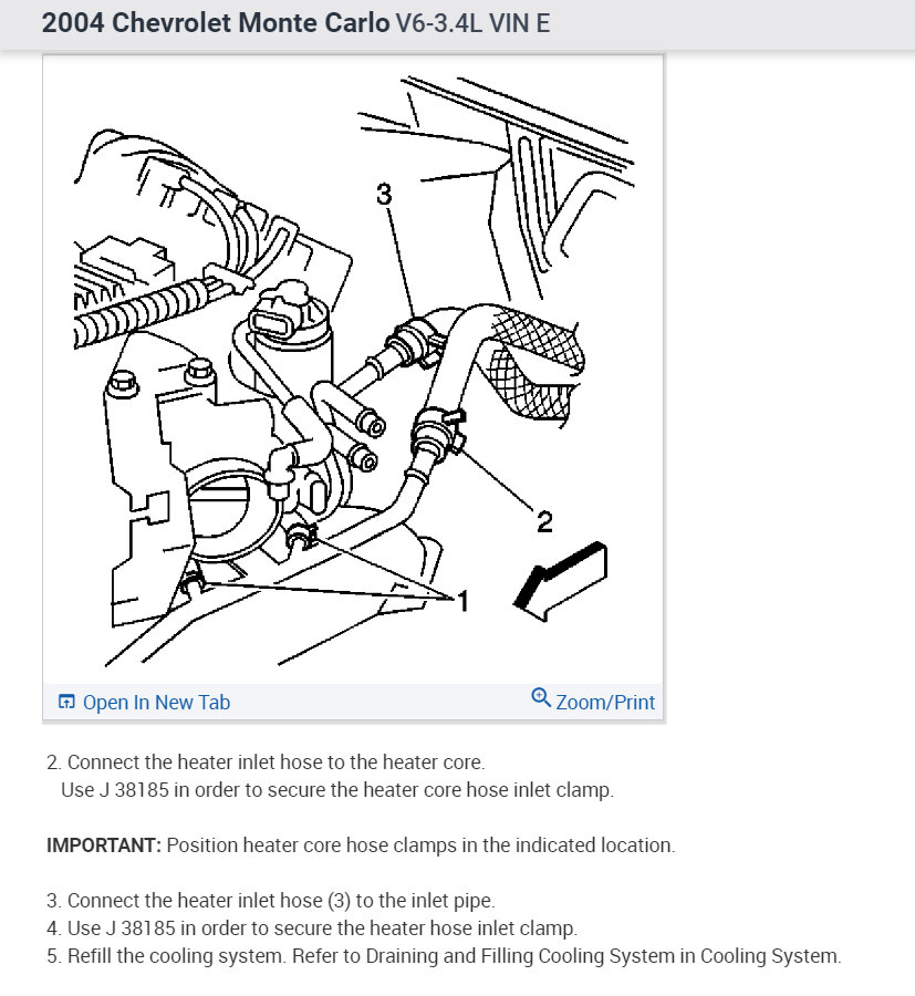

Which hose is the inlet and outlet? Also, what do they connect to?
Dec 12, 2022 at 1:53 AM
  • 55,612 POSTS

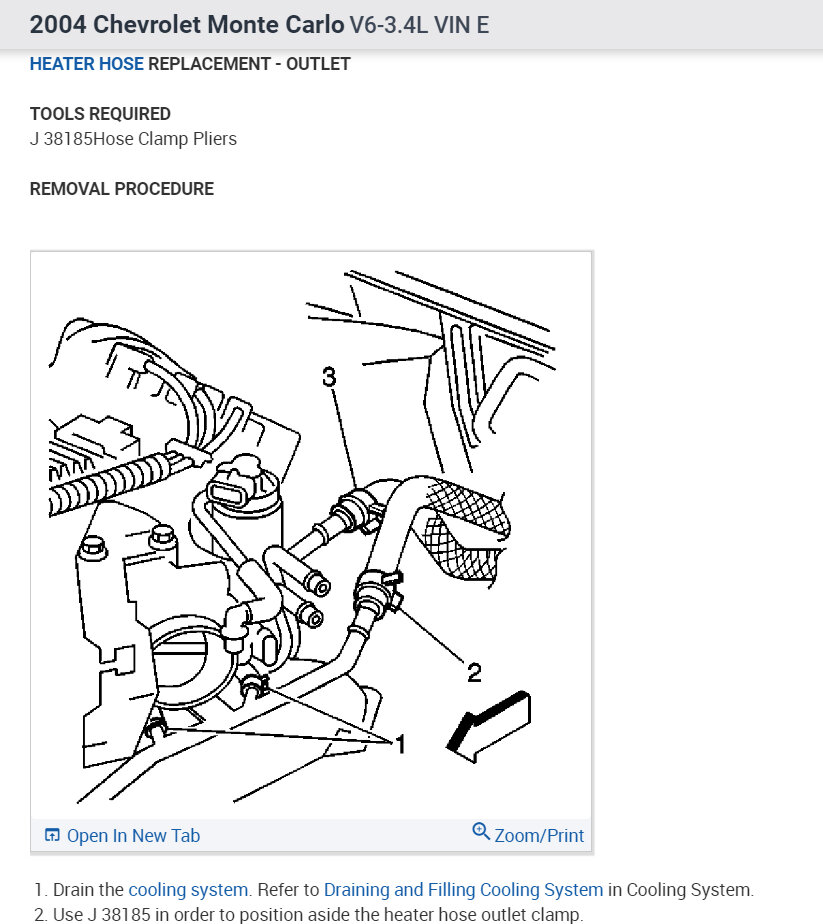

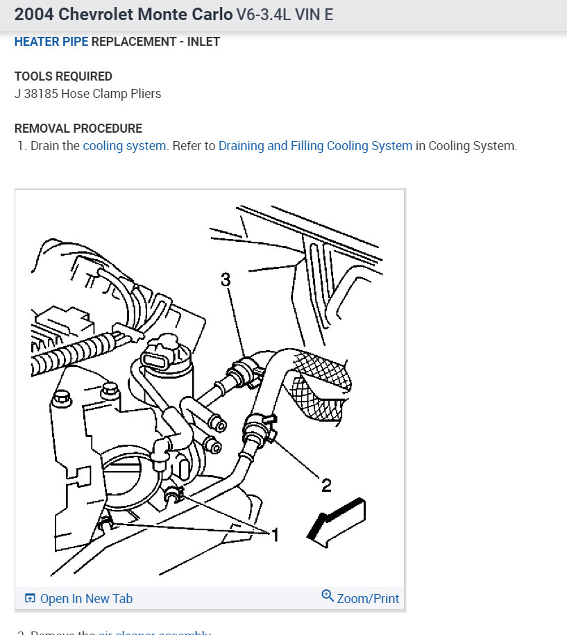

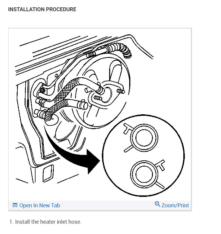

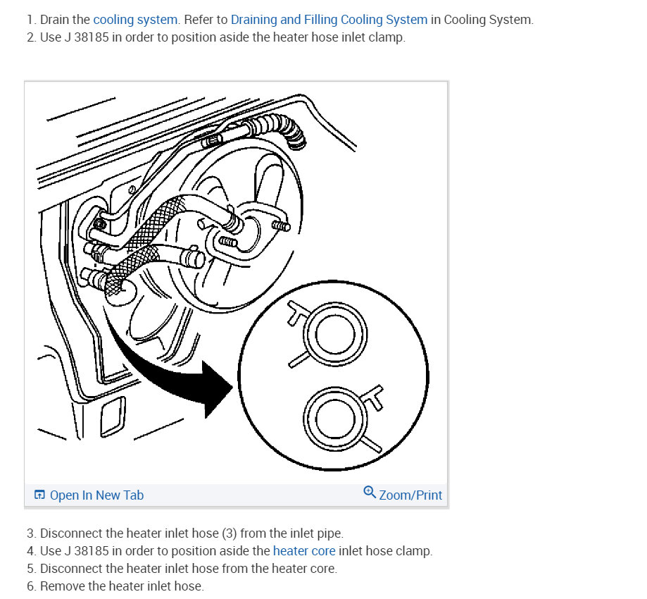

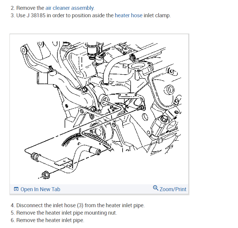

Here is a guide to help walk you through the steps of changing the heater hoses out with the instructions with the inlet and hose outlet information you have requested in the images below.
https://www.2carpros.com/articles/replace-heater-hoses
Check out the images (below). Please let us know if you need anything else to get the problem fixed.
