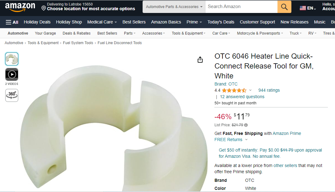

Does the GM quick connect heater hose just push on for new connector?
2006 CHEVROLET SILVERADO
195,000 MILES • 4.3L • V6 • 2WD • MANUAL
RANDYSUND
Or do you have to use tool?
Oct 19, 2023 at 2:24 AM
  • 110,244 POSTS
If you are referring to the connectors at the heater core itself (at the firewall), you do need a quick connect release tool. They are plastic and slide over the hose and then are pushed between the connector and the hose. At that point, when pressed they release the retainer in the quick connect and the hose can be removed.
Let me know if that helps or if you have other questions. Also, I attached a picture of the tool needed below.
See pic below.
Oct 19, 2023 at 11:32 AM
RANDYSUND
Thank you, got it off and new one on. Thank you greatly appreciated prompt response. Thanks
