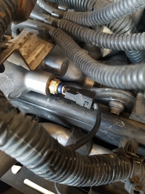

This is the sensor I have replaced:
Apr 7, 2019 at 11:44 AM
JOETECHPRO
  • 705 POSTS
Hey piperjerky,
That does look like a single wire going to that sensor.
To be sure, can you pull back that outer wiring casing and tell me how many wires and what color they are please.
Regards, Joe
Apr 7, 2019 at 2:35 PM
PIPERJERKY
  • 5 POSTS
Yes it is only one wire going to that sensor.
Apr 7, 2019 at 10:13 PM
