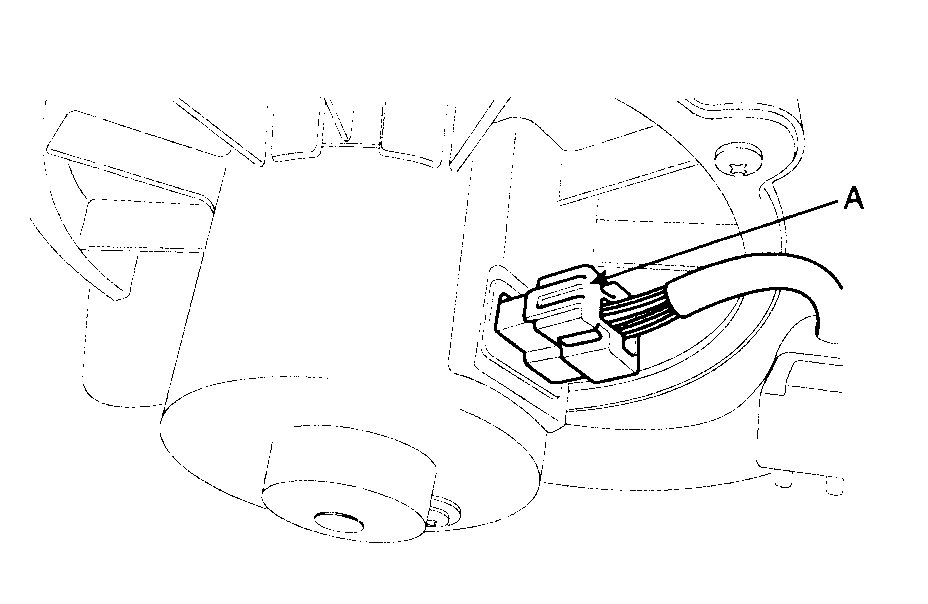

The heater works when it wants to. Cold in the morning and get half way to work before it starts to blow. Also, any idea on location of blower motor?

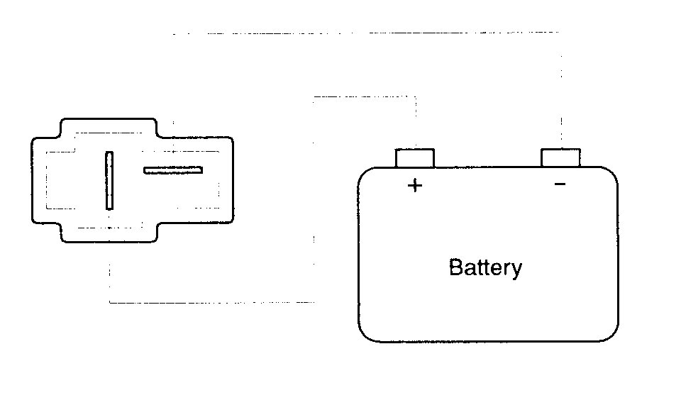

The blower motor is under the dash and behind the glove box. There is a good chance the motor is going bad. Here is how to check one. The attached picture correlates with the directions.
______________________________________________
2007 Hyundai Truck Entourage V6-3.8L
Blower Motor
Vehicle Heating and Air Conditioning Blower Motor Testing and Inspection Component Tests and General Diagnostics Blower Motor
BLOWER MOTOR
BLOWER MOTOR
INSPECTION
See pic 1
1. Connect the battery voltage and check the blower motor rotation.
2. If the blower motor voltage is not operated well, substitute with a known-good blower motor and check for proper operation.
3. If the problem is corrected, replace the blower motor.

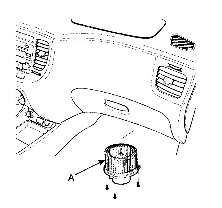

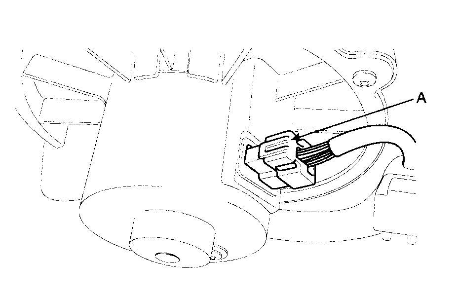

Here are the directions specific to your vehicle for replacing it. The remaining pictures correlate with the directions.
Blower Motor
Vehicle Heating and Air Conditioning Blower Motor Service and Repair Removal and Replacement Blower Motor
BLOWER MOTOR
BLOWER MOTOR
REPLACEMENT
1. Disconnect the negative (-) battery terminal.
See Pic 2
2. Disconnect the connector (A) of the blower motor.
See Pic 3
3. Remove the blower motor (A) after loosening the mounting screws.
4. Installation is the reverse order of removal.
